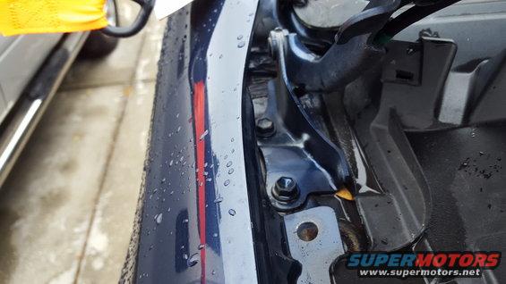

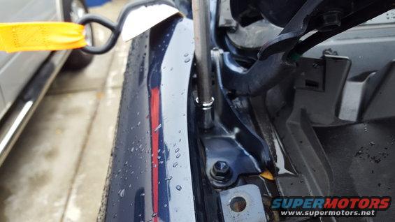

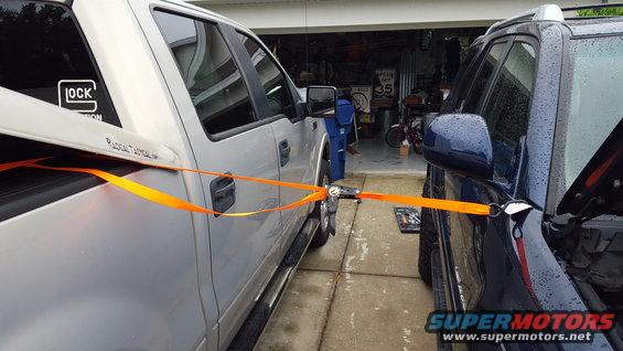

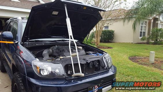

After a frustrating first half, and a little rain, and some sleep, I got this figured out. I used a ratchet strap. After you remove all the top fender bolts, make sure you get that little guy hidden by the door hinge under the rubber weather strip. Sorry, no pic of that. I also put the old crutch to use to support the hood when you take those two bolts out. This made it a true one-man job, 15 minutes per side.

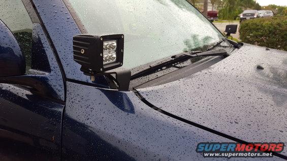

I have two sets of lights, a pair of spots, shown here, and floods. Gotta drill the brackets out, should've done that before I bolted them in. Similar to gshadows.
