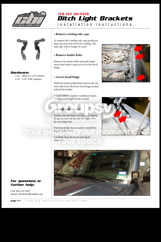

Sure.
1) Open door
2) remove rubber gasket on door exposing 10mm bolt, remove bolt
3) remove 3x10mm bolts on fender
4) pull fender out and wedge something in place so you can access 12mm hood hinge bolts
5) Have your buddy hold hood
6) remove 2x12mm bolts on hood hinge
7) slip bracket over hinge and replace 2x12mm bolts
8) put everything back together
I unfortunately messed up on #7 and will have to reinstall...
I had no issues with the hood, just propped it open at the opposite front corner of the side I was working on...

I received my CBI brackets for 5th gen today. It does not appear that they bolt to the lower hinge (and therefore no need to pull out the fender. Instead they attach to the upper hinge bolts (on the hood itself). Got them on easy. No need for a second person as I did them one bolt at a time and kept the hood in place. But it seems that I need to trim the cowl as when I close the hood the rear of the hood sticks up because the brackets are hitting the cowl. The brackets did not come with instructions but the instructions online confirm that I need to trim the cowl. see http://www.cbioffroadfab.com/wp-content/uploads/2015/04/5thGen-DLB-Install.pdf but the pick provided by CBI shows a huge hole trimmed from the cowl. My questions are these: 1) does anyone have pics of how much they actually had to trim from the cowl? and 2) Is there some good reason I should not put a hole in the cowl of a brand new truck? Thanks!
