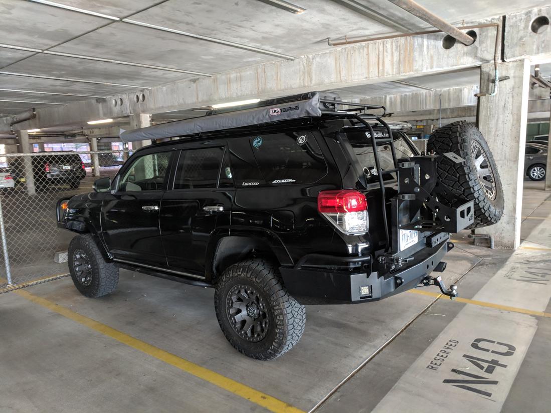

Just bought 5th gen 4runner with a CBI bumper and experienced the same problem described by Bart. Driving around 70mph on concrete slab highway, the whole car subtly wobbles up and down. The feeling is similar like if the engine was stalling in a stick shift car. First I was freaked out thinking something is wrong with my engine, or transmission, than I thought it's suspension. After like a week of driving I finally figured out it was the spare tire on the CBI swing arm. I went to my mechanic, he agreed it shakes a lot. I asked him to find a way to attach the top of the jerry can holder to a ladder that is mounted to the rear gate. I will keep everyone posted. Wish me luck
Don't do that.
The ladder is attached to the body, which is isolated from the frame via rubber body mounts to allow independent movement. If you rigidly attach your frame mounted bumper swing out to your body mounted rear hatch, you are going to break the hatch.
ETA: Also, your spare is riding super high, you should lower it. That will make a huge difference as you are shortening the lever that your spare is connected to.

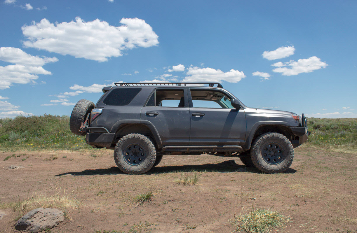

Yeah his spare is stupid high. Lowering it should help, along with making the truck look better. These aren’t baja vehicles.
However, I don’t think you’ll get rid of all the wobble. That is a ton of weight with a lot of leverage on the hinge and latch. Check for broken welds too.

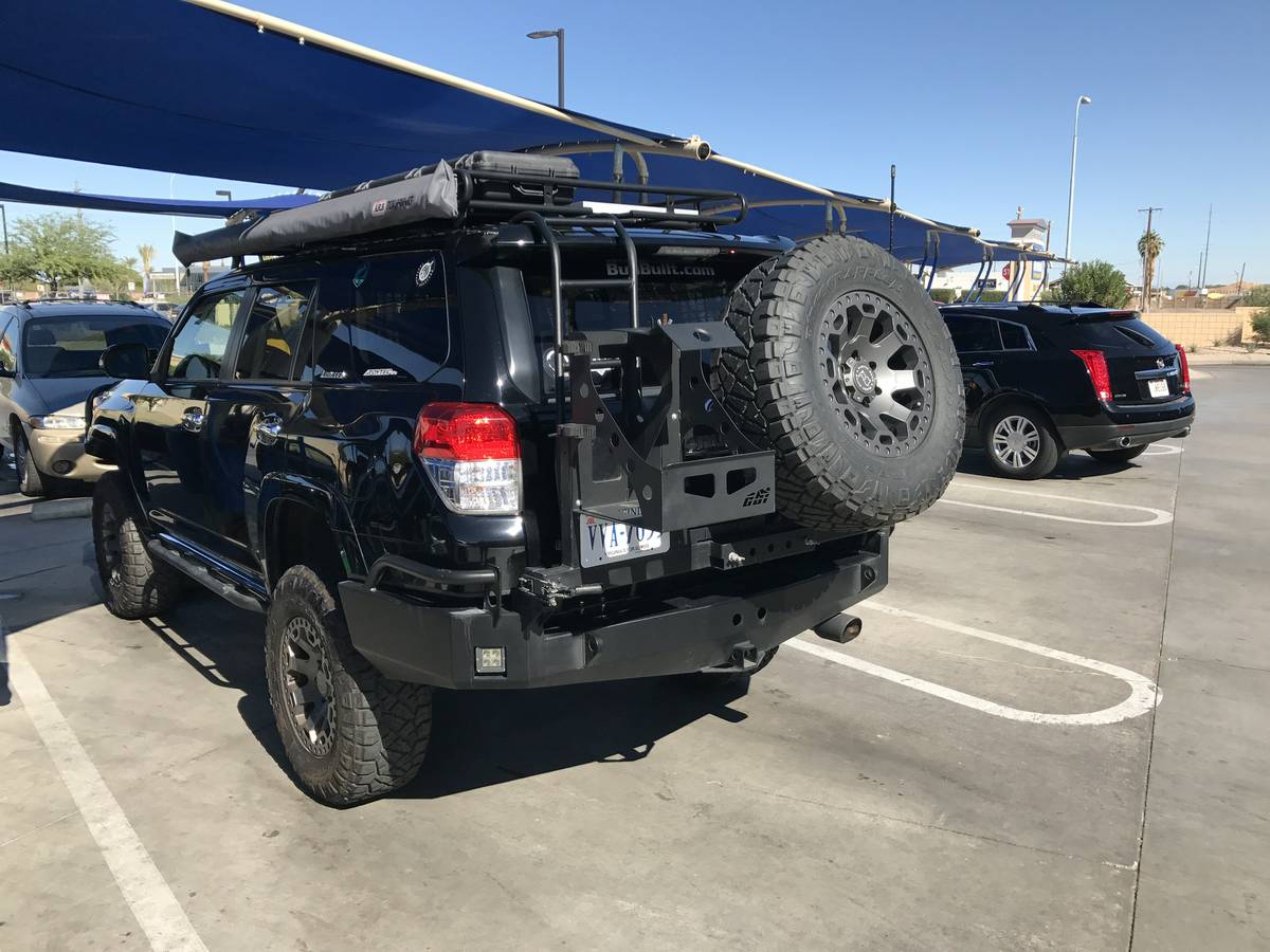

Not true. My shrokworks swing out doesn't wobble at all. This think is build like a shit brick. Only complain it's waaay too heavy.

Actualy no.. I removed the swing out arm and the spare as it was way too heavy. The truck sat like a boat with the OME 890. You can even see in the picture is squats. Plus it's my daily. It's a pain to open the swing out everytime I open the trunk. I just replaced with LC coils so I might throw it back on to check how she sits. I don't think the tire will be caught. You can adjust the height BTW. In the picture I have it on the lower point for better rear view.
