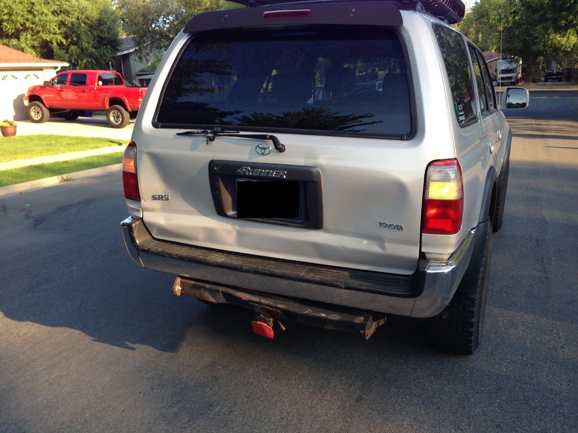

BTW, here's a photo of the damage from the accident. My son was driving home with his little brother when it happened. They are fine, but it kind of shook them up. The other driver was at fault and his insurance is taking care of the repair.
The hitch took most of the impact. The bumper was bent downwards, and had a few small dents and scratches. And of course you can see the damage to the lift gate, and there's a little body damage under the left tail light. The lift gate still opens just fine, but I never tried to roll down the window. Wiper still works. Looking underneath, I couldn't see any frame damage, so hopefully it wasn't bent.
I'm hoping the cost to cover the hitch and bumper materials will come out close to what a new off-road bumper would cost (approx. $1000). It's at the repair shop right now; they are taking it apart to get a better estimate of what the repair will cost and haggling out the final details with the insurance company. They seemed willing to work with me when I mentioned I would like to get a different type of bumper/hitch rather than an OEM replacement. There's still a chance they declare it a total loss due to the age of the vehicle, but let's hope that doesn't happen...

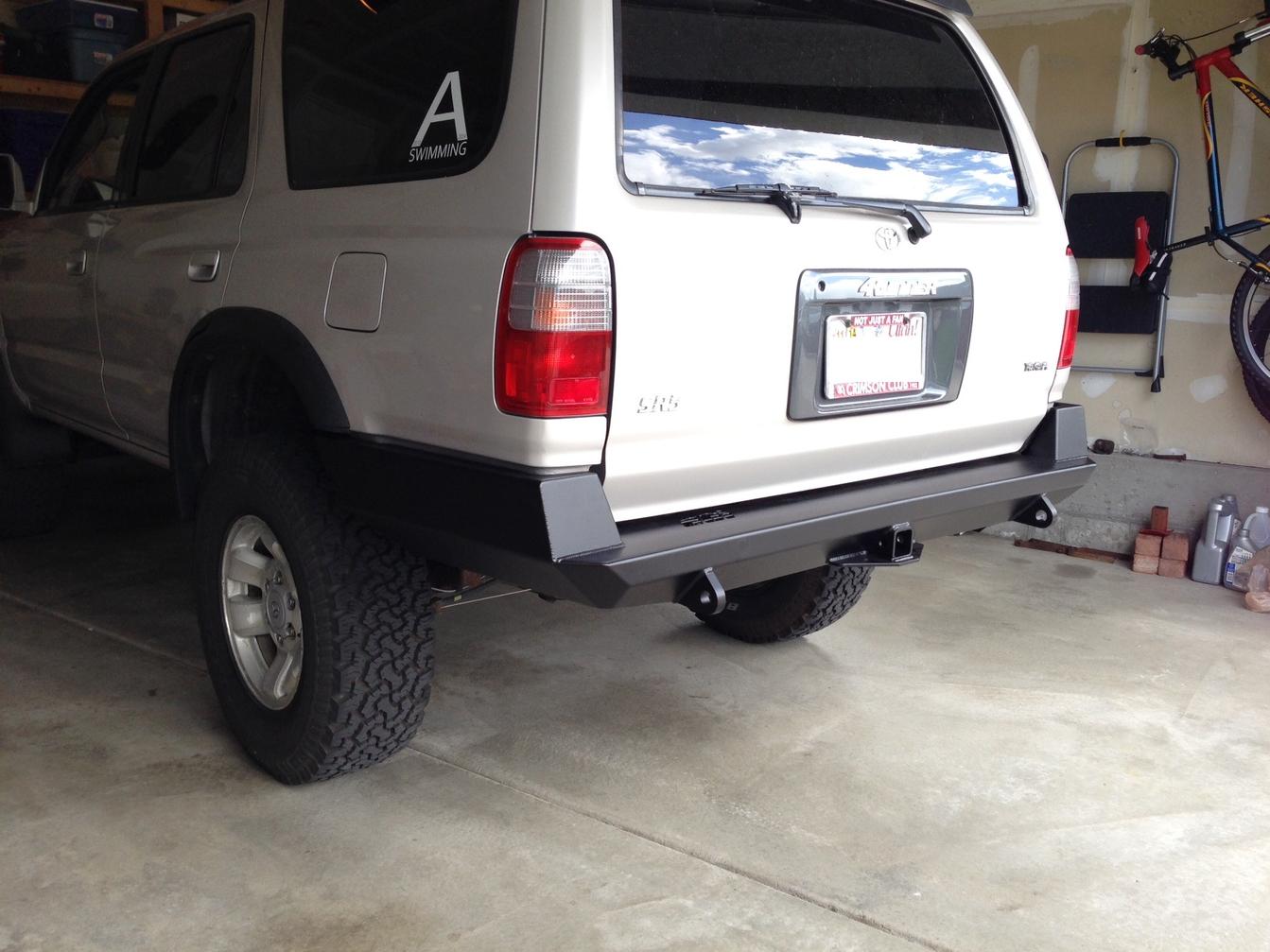

Bumper installed!
Yep, was able to get the new CBI plate bumper as part of the repair. Installed it myself on Friday. It took a little longer to get the bumper from CBI than I would have liked, but everything worked out.

The stock 31" tire (which I still have) fits in there fine, with a little extra room. I'm guessing a 32" would probably fit ok, but not sure about a 33". One note, I do have it installed with the bumper probably pushed towards the front of the vehicle as far as it will go. I may loosen up the bolts, slide it back a little bit and take some hard measurements while I'm at it. I will post results when I get them.
I took a closer look at the bumper this past weekend. I loosened the bolts and slid it back as far as it would go (wasn't much further than originally installed; I maybe gained another 1/4" at most).
The distance measured from the back of the hitch receiver to the frame crossmember is about 31". The stock 31" spare fits with no problem, with about an inch of room remaining (that's because tires are rounded, and the tallest part of the tire is on the center of the tread...). I figure a 32" tire would probably fit ok, but a 33" would be a challenge indeed.
