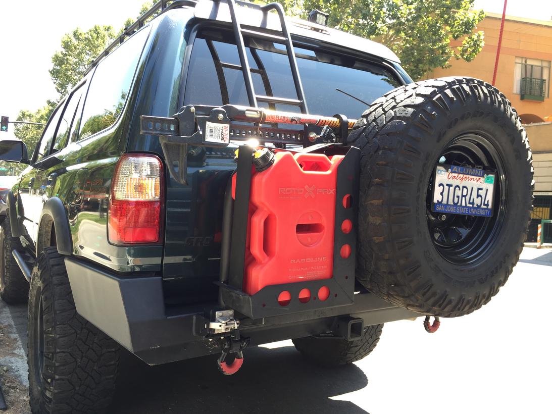

For any wobble issues with CB&I or Shrockworks, consider using a foam mat as a spacer to be wedged inbetween the hatch and the tire carrier. Some benefits:
- Diffuses the tire carrier's load on the hatch.
- Dampens/Kills vibrations if done right.
- Easy access mat for working underneath the rig while wheeling.
- Can be used for original purpose, yogamizing or sleeping.
- Looks prepared, but that's optional.

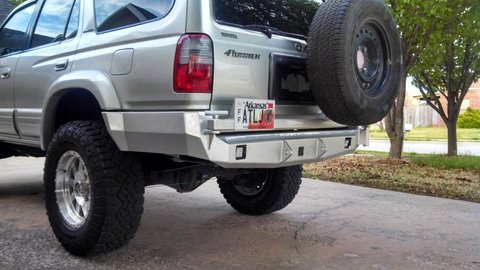

Shrockworks has been great to work with through a front bumper build and they certainly beat the shipping times they suggested, but as for rear tire carriers go who's the great craftsman for this bumper? I believe runnyrunnerton also has this bumper but haven't got contact with him to know where it was made. Any one else know?
