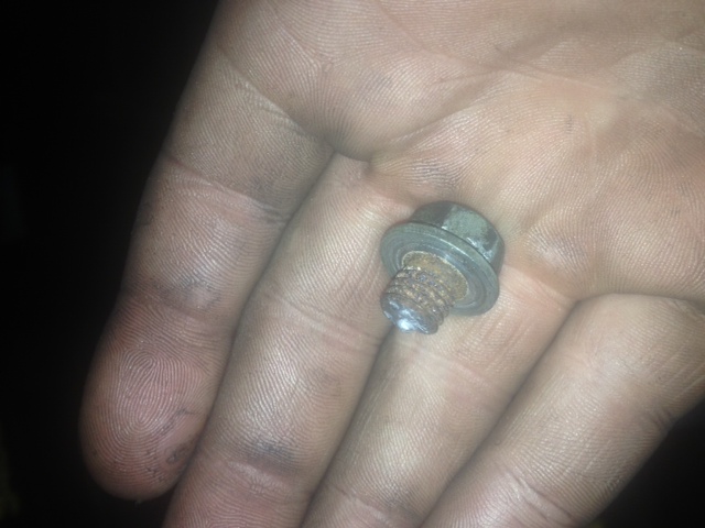

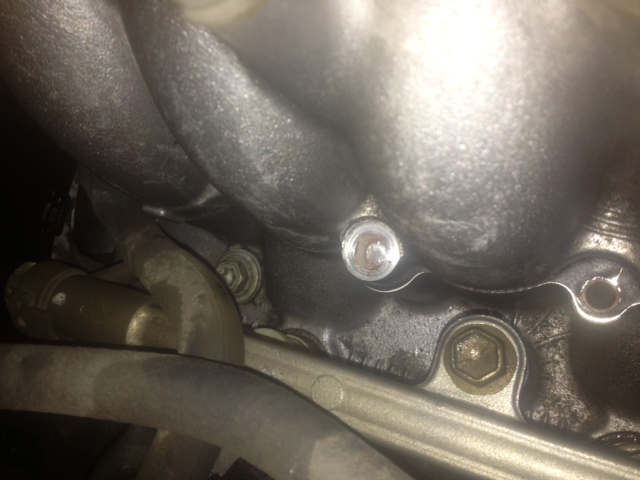

Thanks for the help, I almost have the intake manifold and all that other stuff out. While I have it apart is there anything else i should check or replace? Also I had a bolt break off on the lower part of the manifold whats the most cost effective way to get the rest of it out, heres a pic.

Take the intake the rest of the way off so you can grab onto whats left sticking up of that bolt. Try either a stud puller or vice grips with a generous helping of your favorite penetrating oil before getting too carried away.
Just got a call from a buddy saying the same thing, thanks man
