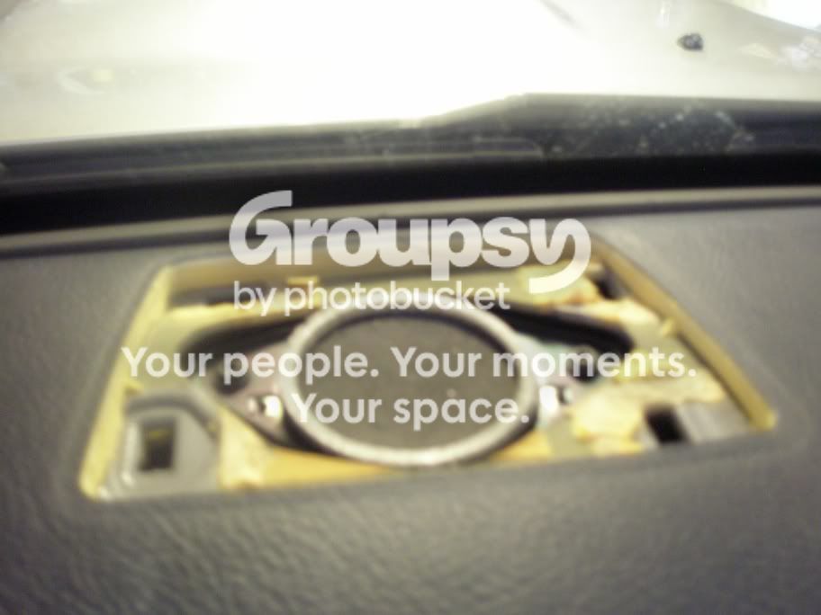

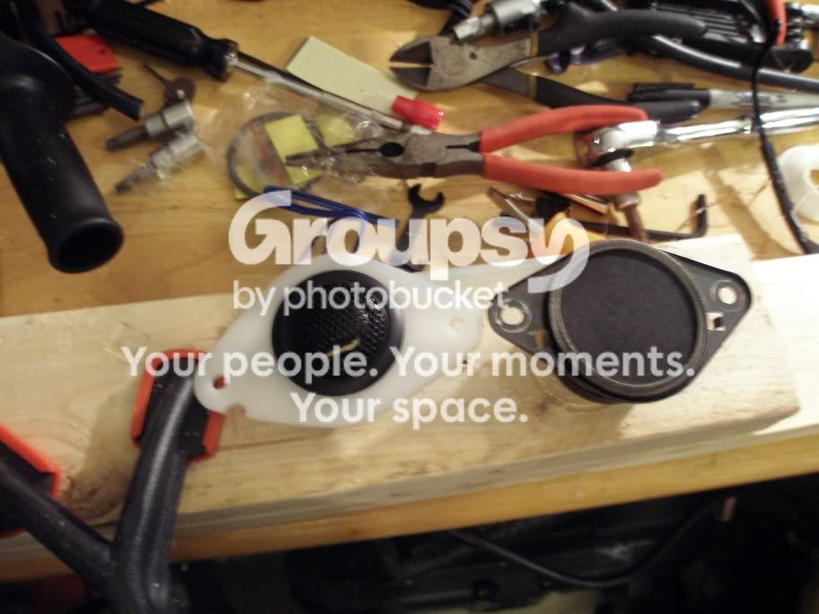

It's the exact same speaker as the doors, same brackets and everything as well
P4020218.jpg~original
P4160262.jpg~original
You could also use a 3.5" coaxial speaker in there as well. Just check on the depth and find one to match. This would give you a much better sound field than just a tweeter. This location is full range sound, not just highs.

I just replaced the speaker grill on mine. There are 4 clips holding it in place. You can kinda see the rectangular holes in the blurry Photobucket pics above. Those are where the clips go. Haven't tried removing it since I just installed it but at least you know where the clips are located now.
