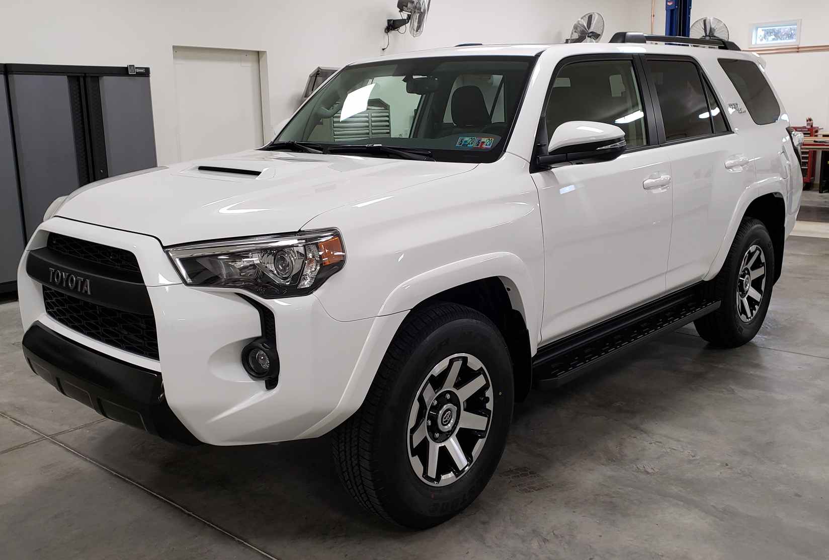

Cquartz uk 3.0 on super white
Just purchased a 2019 TRD off road. Brought it home from the dealer, 11 miles. Did a very thorough wash and dry. Let it set overnight and inspected the paint the next day. Touched up any spots that were not perfectly clean. Since the truck was new, no need to claybar.
Proceeded with the cquartz uk 3.0 application as stated in the instruction but using 3 micro fibers to buff, the yellow one that came with the kit first, then a blue one, then a final wipe with third white micro fiber.
Once done took a 30 minute break. Then went back for a second complete coat.
Coated the black valances as well but not the grill garnish.
Let car sit for 7 days.
Temps during application 68 degrees, 35 percent humidity.
Very happy with results
your car looks exactly like mine from 10 feet away and i wash mine with cactus spines and desert dust.
