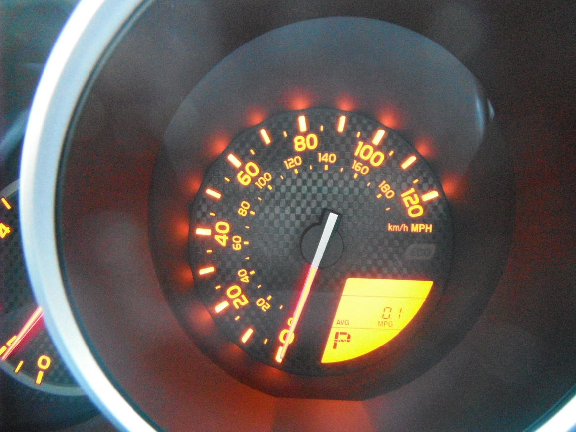

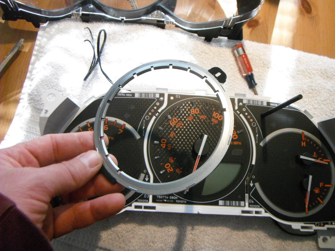

Well...I have been messing around with my dash lately. I've had it apart but haven't taken the needles off yet to access the LED's. I want to change the color of the LEDS that feed the clear plastic markers around the edge of the speedo. I removed the silver trim ring- which gives an awesome effect at night. Like a light tunnel- I like it alot. I have a few things I'll be posting up soon. (sorry for mini hijack)

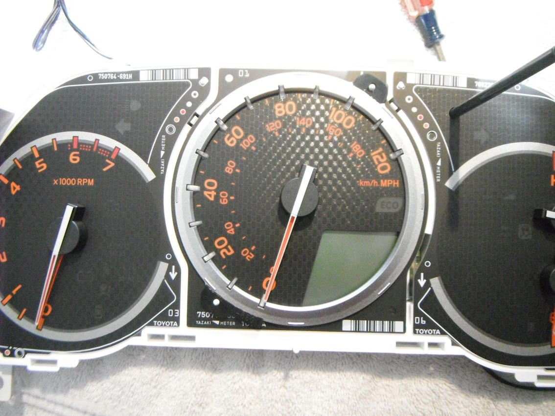

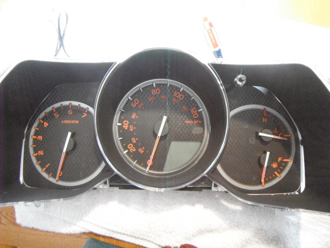

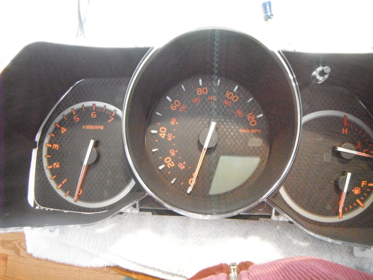

Here ya go- I was going to wait and post some of these in my thread. Still might later...
This is the trim ring I removed. You don't even need to break anything, Antman style. It just lifts right off.

This looks really cool at night- not too bright- but it lights up the entire speedo "tunnel" just enough to add some coolness ...
I want to make the plastic markers on the speedo white- like the Optitron, or possibly red. I believe their source is the LED's from the information display. I have to get the balls to remove the needles...:wow2:

Well, we tore apart my cluster last night..
Bad news and good news.
The bad news is that the faceplates are painted. What that means is that orange color is not coming from LEDs like it did in lower level models.
LEDs behind the faceplates are white, and the faceplates are painted orange. Thus the only way to change colors to blue is to sand the back of the faceplate or to get a custom one made.
the back of faceplates as also a plastic protective film. So, rubing alcohol solution will not be available (in Infiniti, one can just rub the paint off with a q tip and polish remover)
the screen on the speedometer is same as in many other Yotas... which means it is VERY fragile.
The good news is that circuit board isn't much different from other toyotas. If one wants to have red LEDs, it can be done without sanding or anything else crazy.
