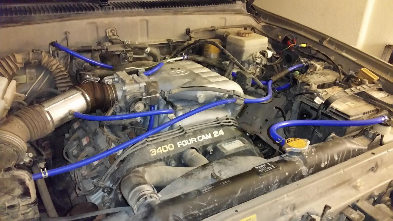

[MENTION=122900]AZBub[/MENTION] gave me his mis-shipment of blue silicone tubing, I just had my emmisions done so Itll be another couple years before they need to be checked, but i wont have a problem if im still in arizona. I just did quite a few lines, a few of mine crumbled when I replaced them, others were easy, and some were just a huge pain. the other end of the tube thats attached to the pcv valve is hidden under a piece of foam, just pull it up. it looks like theres quite a lot of lines near that firewall that can be changed, but a lot of them are a huge pain to get to. I also discovered the fuel line, and wasnt able to to get one end off and gave up. certainly cleans the engine bay up a bit, ill have to get some degreaser or something and get the engine looking nice and clean at some point here.
they also have radiator hose, I might be getting some of that pretty soon here. I noticed that the majority of what I used was the 8mm, and the 6mm fit in all the spots where the 8mm works. I didnt use any of the 10mm yet and none of the 4mm either. I might make the 4mm into a breather extension for my rear axle.
update, looks like our trucks use a 1.25" radiator hose, and the biggest they make is 1"....

You don't want to use silicone line for the fuel line. I think that is why Cali won't approve them. Silicone will swell in contact with liquid gasoline.
PS. Foaming engine cleaner is cheap at Wal-Tard.

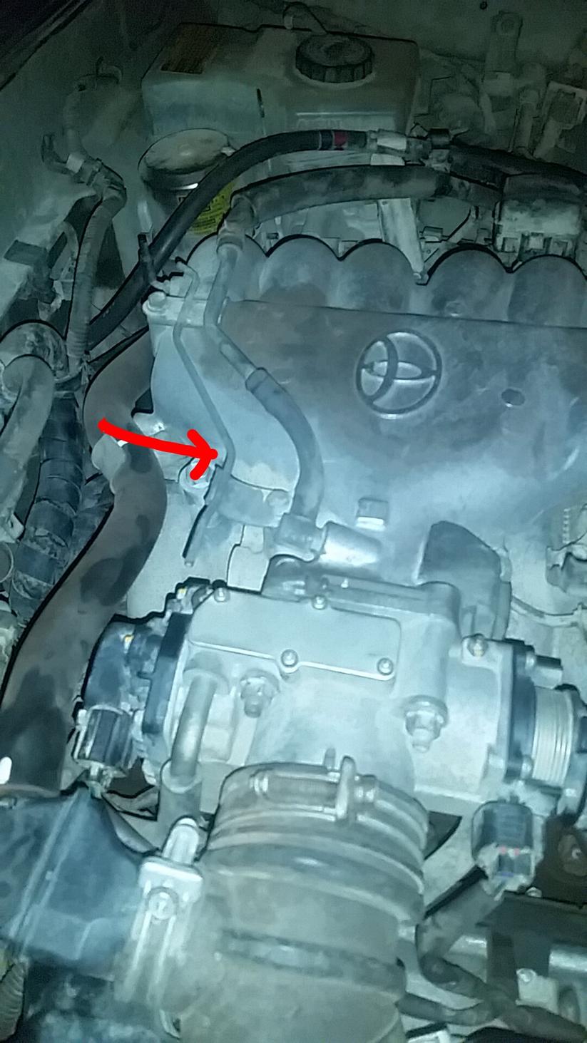

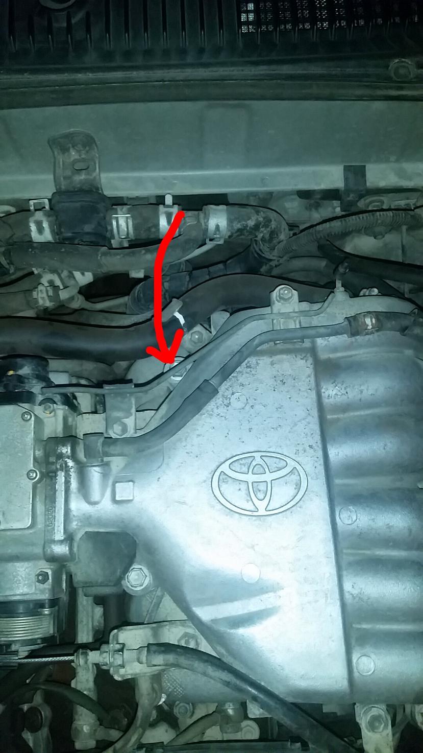

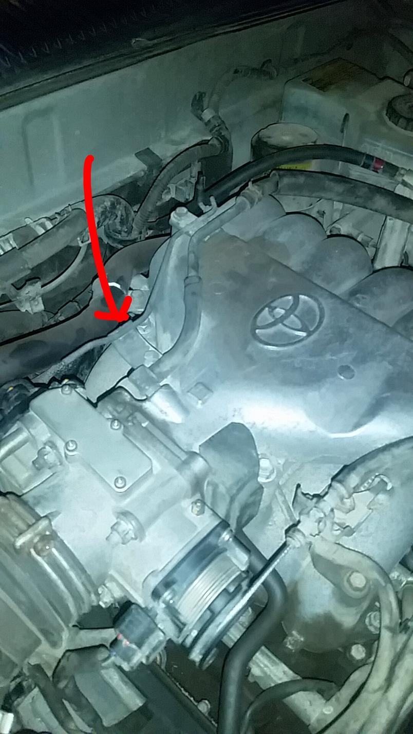

What is the tiny metal tube for in the top og the engine located in the back. It looks like something should connect to it and ive always wondered if im missing any connections. My vacuum hoses are basically disintegrating.
Does anyone know what this is (see images), and I'd something supposed to connect to it?
