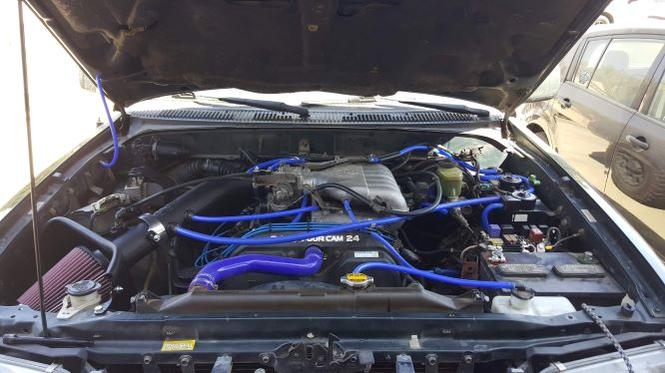

Changed out my vacuum hoses with silicon- pic

It seems like 8MM is the main size needed, correct? I'm considering to just order it by the foot in that case. I have two 4Runners needing vacuum hoses and I don't want to be stuck with some useless rolls of 10MM and 4MM hoses once I'm done.
If someone can chime in on the sizes and lengths needed, that would be great.
As far as I can tell, the 4mm is pretty much just for the washer fluid hose, which I didn't do because that's what I'd call a low priority. When I priced it out individually, it was actually cheaper to get the kit by about $10-15. On the other hand, I was visually estimating which size I was replacing, and I ran out of 8mm (I think).
I also wasn't positive which hoses were safe to replace after the obvious that go to and from air intake related parts. I ended up being more conservative about it, but I'm going to try to replicate using the pictures of the blue hosing here.
Is there a picture or diagram of which hoses are safe to replace with this stuff? I think there might be a vacuum hose diagram on the hood, but I don't remember.
Oh, and Silicone Intakes is a phenomenal company! I ordered my kit on Thursday afternoon last week and it was to me by Friday (granted we're not that far away from Co Spgs, but still).

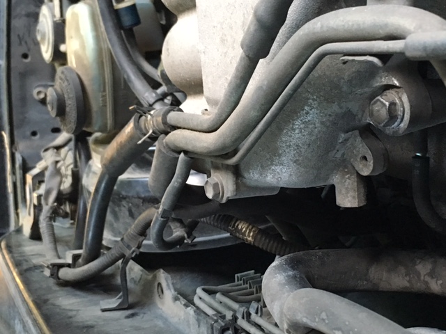

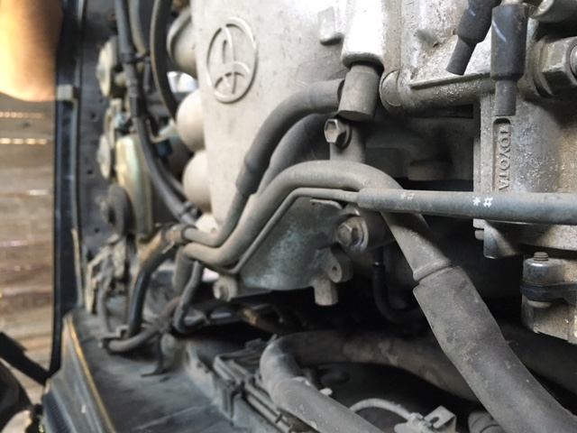

Does anyone know what this is (see images), and I'd something supposed to connect to it?
So, mine is definitely hooked up to...something. Any ideas?!
Oh hell, I have no idea why the orientation is screwed on that. It's not like that on my computer or phone.
I just answered this question like six months ago and I don't feel like researching it again. Are you an '01-'02 by any chance? I think maybe the answer was it wasn't used in the throttle-by-wire years but Toyota left it on there.
Anyway, there are definitely some trucks it is just there naked like that.

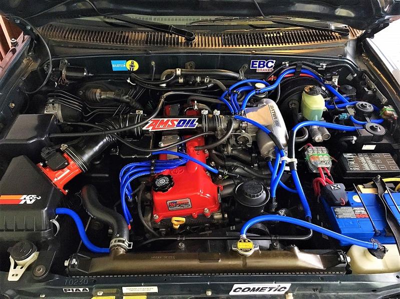

Finished mine
tO0h6qS
Thanks for this thread. Just did mine up and had to share.
