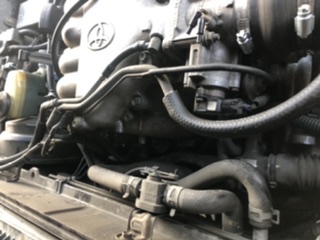

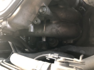

After further inspections I found a possible issue. I don’t remember if I un Hooked this hose, or it was like this. I googled some diagrams and it looks like the evap line?
