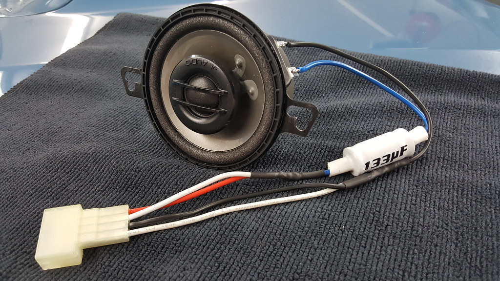

Hi, do you remember how you wired up the four wires into the two new speaker terminals? Any updates and/or new recommendations on speakers, bracket, etc? Thanks.
Thanks for the response but I can get the bracket off of the old speaker no problem but my wires coming off of the old one are yellow/black/green/red. Any idea which two can be tied together and then go on +/-?
I'm guessing you cut off the OEM connector? Honestly I don't know the pinout. I bought the adapter to avoid cutting the OEM connector off.
My main concern is, which wires get soldered together and which pairing goes on the + terminal? I don't know why this is kicking my butt! :frusty:
Were you able to figure this out? I'm trying to figure out the same thing and would prefer to avoid having to buy another part since I've already removed the old speakers.
Turns out after I cut away the heat-shrink on the factory harness (the speaker side) that the yellow/green and the red/black were tied together. So I clipped the green and black wires. The yellow wire went to the (+) speaker terminal and the red wire went to the (-). The speakers I bought were the JBL GX-302 as shown above and they have some sort of bass blocker already wired in. I clipped the factory brackets as shown above to mount the speakers, but I did not have to modify the back of the speaker grills to get them back on.
