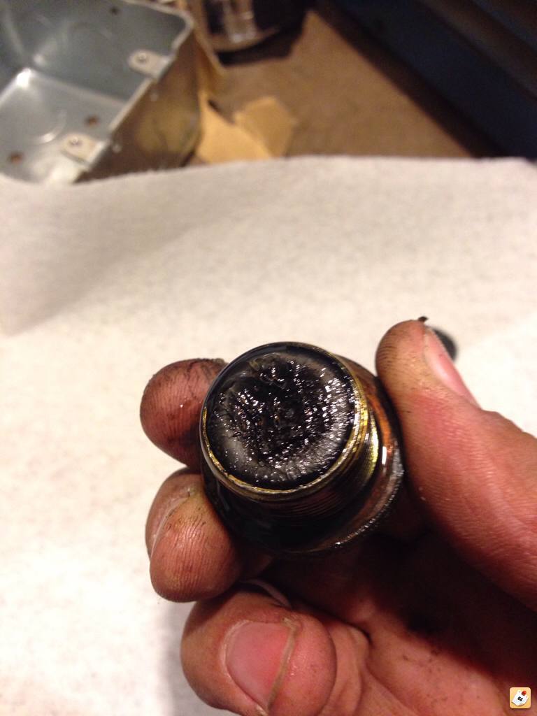

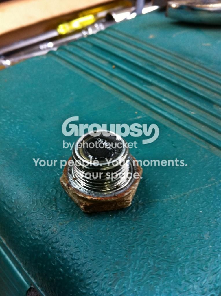

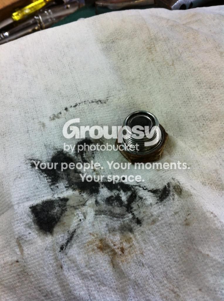

Added magnet (fill plugs ) to the rear and magnet fill and drain plugs to the TC 12000km ago , this is the rear fill , Caught a bunch of stuff , and also keeps the drain plug magnet from reaching its metal holding saturation point as fast ,especially good if you are extending change intervals with synthetic oils , I clean the fill plugs every oil change or level check etc ...
