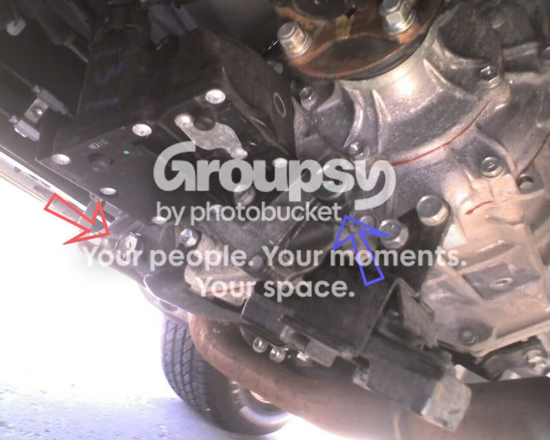

Next was the transfer case:
8425091505_ORIG.jpg~original
Drain Plug - 24mm socket, 27 ft/lbs
Fill Plug - 24mm socket, 27 ft/lbs
Fill quantity - 1.5 qts.
