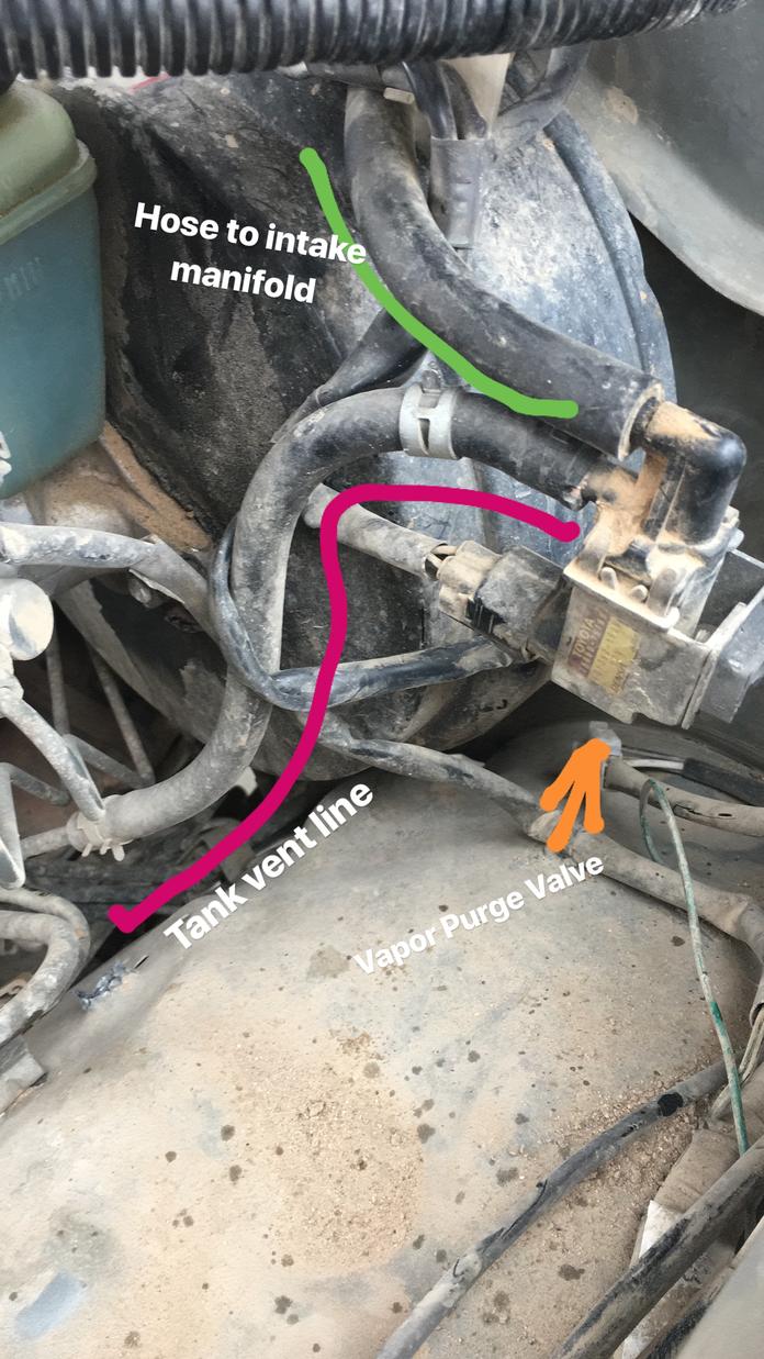

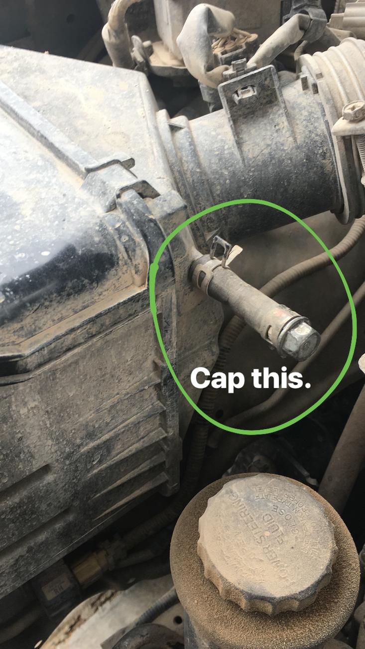

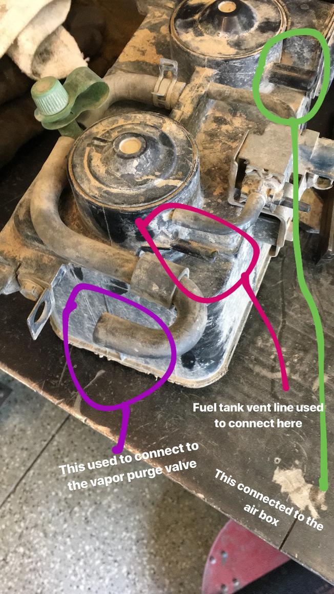

I've had my EVAP/ Charcoal Canister bypassed for some time now and just barely bulled the Charcoal Canister out so I thought I'd share how I did it. The way I bypassed it is much easier and simpler than the ways mentioned above. No tee fittings, no breather tube and still vents to your intake rather than directly to the atmosphere. Gotta keep the hippies happy :hippie: Honestly, it's just a better idea in my opinion so that fuel vapors are not just dumping out into your engine bay or outside of your vehicle. You will smell unburnt fuel sometimes out your exhaust but better than fresh gas fumes all the time.
There are only a few lines that need to be changed with this method. Basically all you need to do is locate your Fuel Tank Vent Line and unplug it from the Charcoal Canister. Locate your Vapor Purge Valve and unplug the lower hose that connects to the Charcoal Canister. Now plug the Fuel Tank Vent Line directly to the Vapor Purge Valve. Then locate the hose that runs from your Air Box to your Charcoal Canister. Pull the hose and cap the tube coming out of the Air Box. That's it! Now just unplug the pressure sensor and unbolt the Charcoal Canister to pull it all out. Easy peasy! This can easily be done without any modifications in just a few minutes, so everything can easily be put back into place when you need to pass SMOG or Inspection.

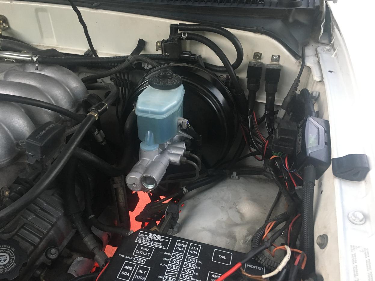

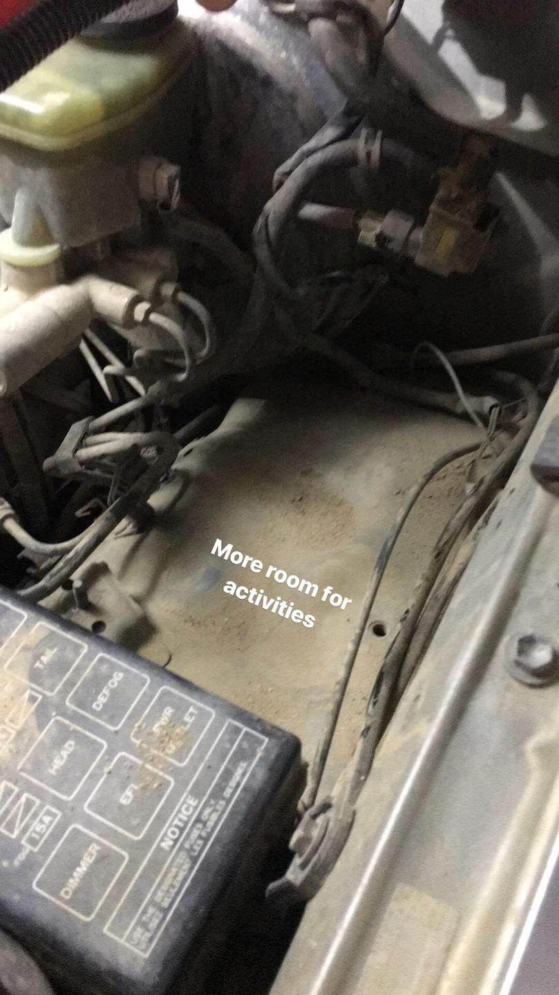

Thank you sir. I owe ya one. Just completed this earlier today how you have it and no CEL
Ended up mounting it on the firewall just above the booster to keep it out of the way and to keep it tidy. Almost look like its factory.
Now I have room to mount my fuse box and have all the relays hidden underneath.
