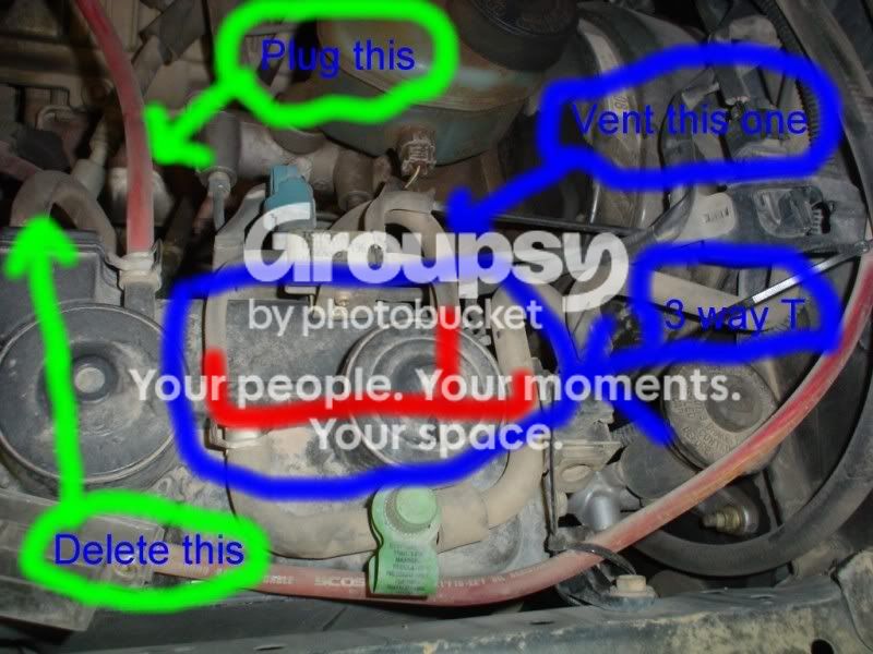

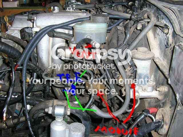

Look what I found cleaning up my photobucket account. I had this saved way back then. I haven't try this mod as I live in a enhanced biennial smog check area. I know some have successfully done the charcoal delete. Let's see if you can use this...
Thanks, this will make a good start. We don't have emissions in AK and my rig is mostly for off-road anyway. I was considering just removing the bulb in my dash for the CEL but I'll wait to see if this keeps it on all the time.
I've done exactly this and have been using it for the last year or so. Yep, IO get a CEL from it. No it won't pass smog but it's also a trailer queen. It's not like I am driving it 300 miles a week. I didn't have room in the engine bay for it to stay. I needed a tire to go there instead.
I deleted mine and drive it every day with no cel. Find the diagram for the 3.4l swap in a 3.0 truck and use that vacuum layout for the 3.0 charcoal canister only leave out the canister. Works fine on my 96.
