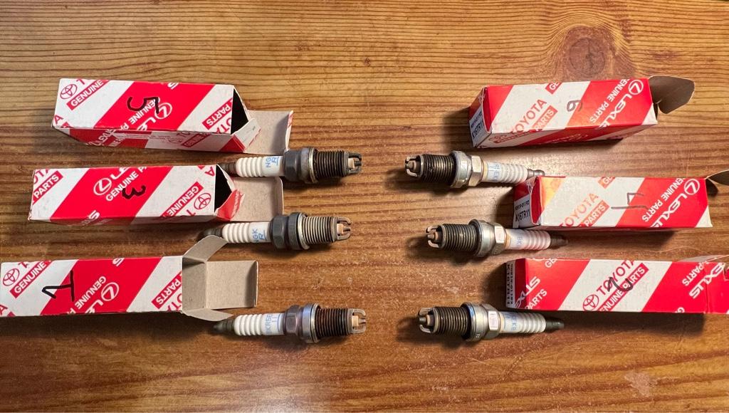

Picture of old spark plugs. #5 doesn’t look overly bad to me but the electrodes seem to be a little more black than the others

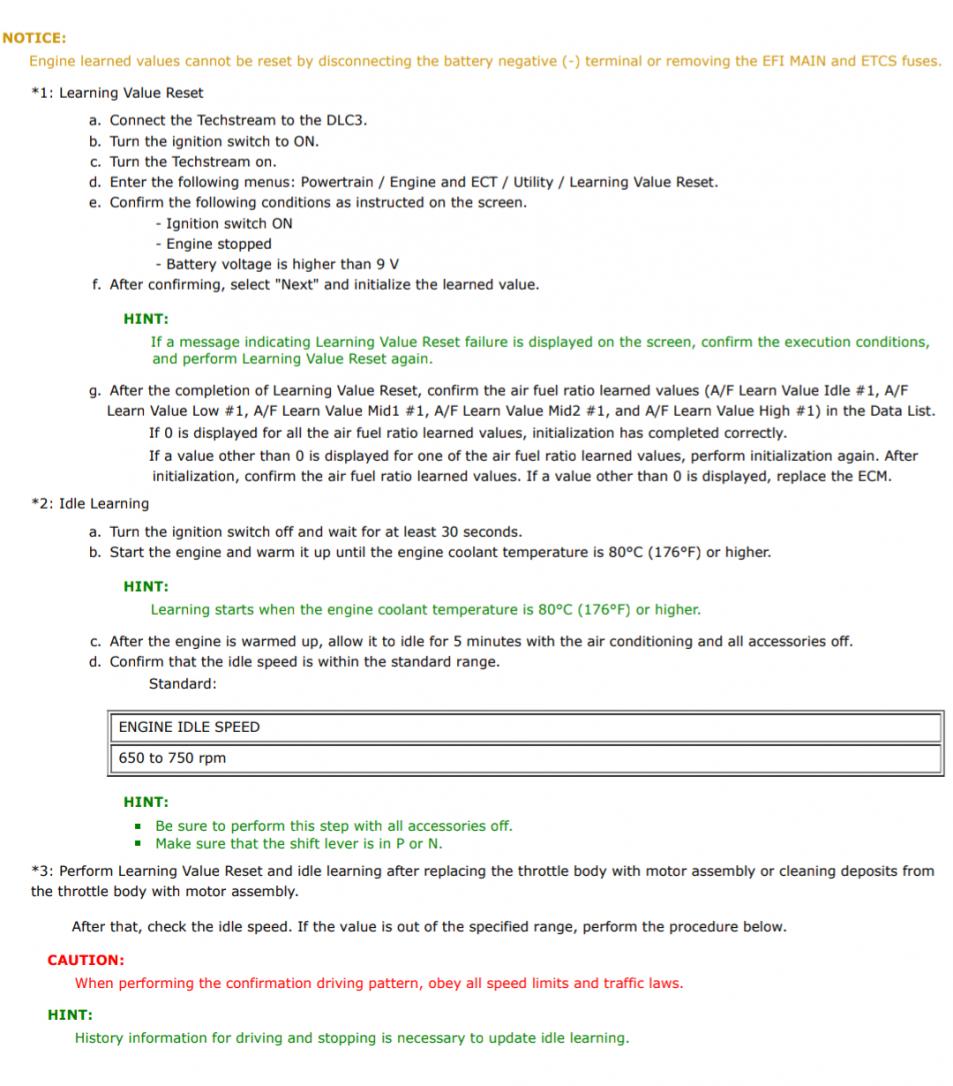

You probably know this, after doing all that maintenance, you performed learning value reset and idle learning I assume.
I pulled EFI fuse for ~15 mins if that’s what you mean and cleared codes with my ultragauge
Here's part of what I meant. There's a couple more pages describing the procedures. Could be a possible cause of your high idle inconsistentcies..

No learning involved with them period? I've relearned vehicles much older. Thanks for not griping me out this time! My bad
The procedure itself doesn't exist for 3rd gens (or at least I have not been able to find it on techstream). The learned values reset after either disconnecting the battery or removing the ecu fuse and then will start relearning as you drive it.
There must be a procedure to manually reset it. Like my 94 xj it's a key and headlight off/on sequence. When you add higher performance goodies it's better to relearn from scratch and much quicker. I have awesome results doing this. I think I actually did this in my 2010 runner with a key and e brake sequence after servicing all PCM inputs now that I think back.. you can loan me your techstream though ��
