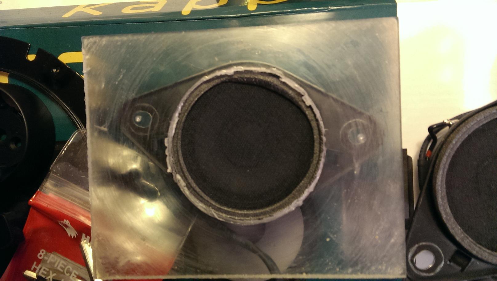

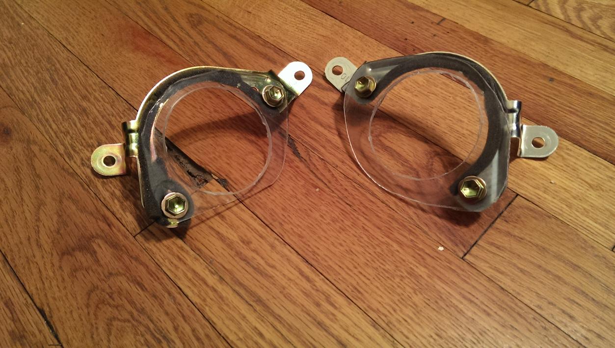

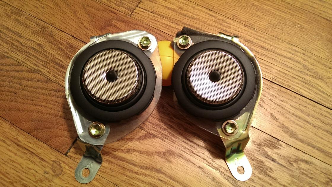

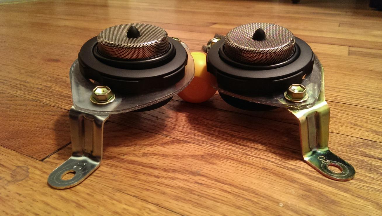

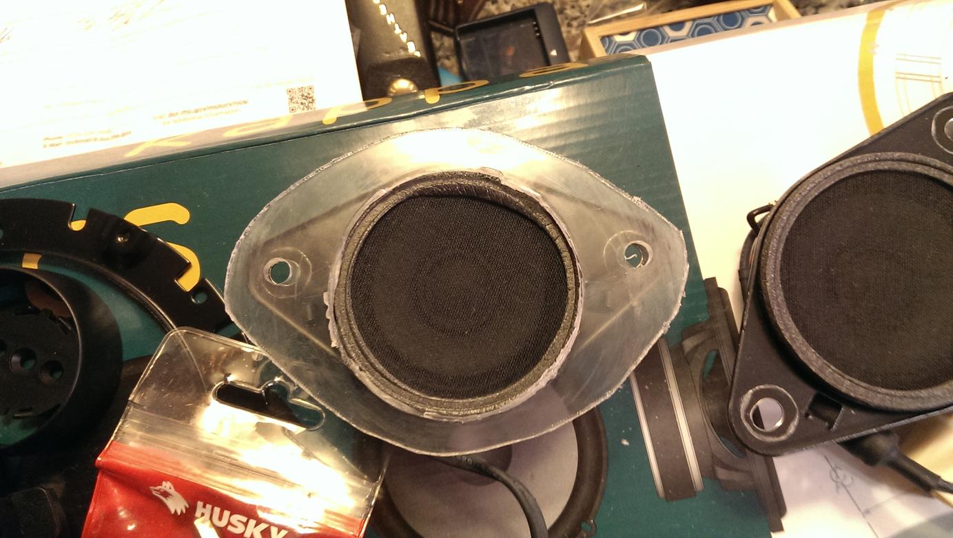

I made these today out of a $6 piece of Lexan. I drilled the holes and used tin snips to shape the perimeter. I'm in process of replacing the JBL Synthesis stereo with all aftermarket gear (Kenwood DDX941HD deck, Infinity Kappa components in front, Kappa coaxials in the rear, Alpine M300 4ch. amp, Alpine M250 mono amp, new wiring, Raammat sound deadening).
