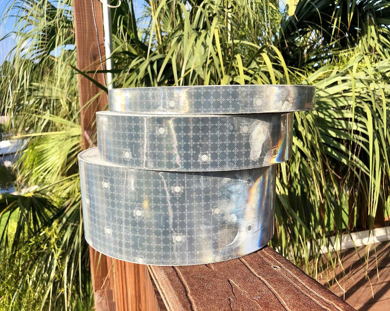

Also with safety in-mind, something I've been wanting to do...
Amazon.com: Oralite Solas Reflective Tape M82 1404 Flexible & Conformable (1000+ Candelas): Sports & Outdoors
That's reflective tape. After a fair amount of searching, I decided upon Oralite's M82 SOLAS product. The 5-foot length was put to good use..
For side visibility, I put two pieces on the Antero rack, both sides.
From the rear.
From the front.
At night, the stuff certainly is noticeable...
