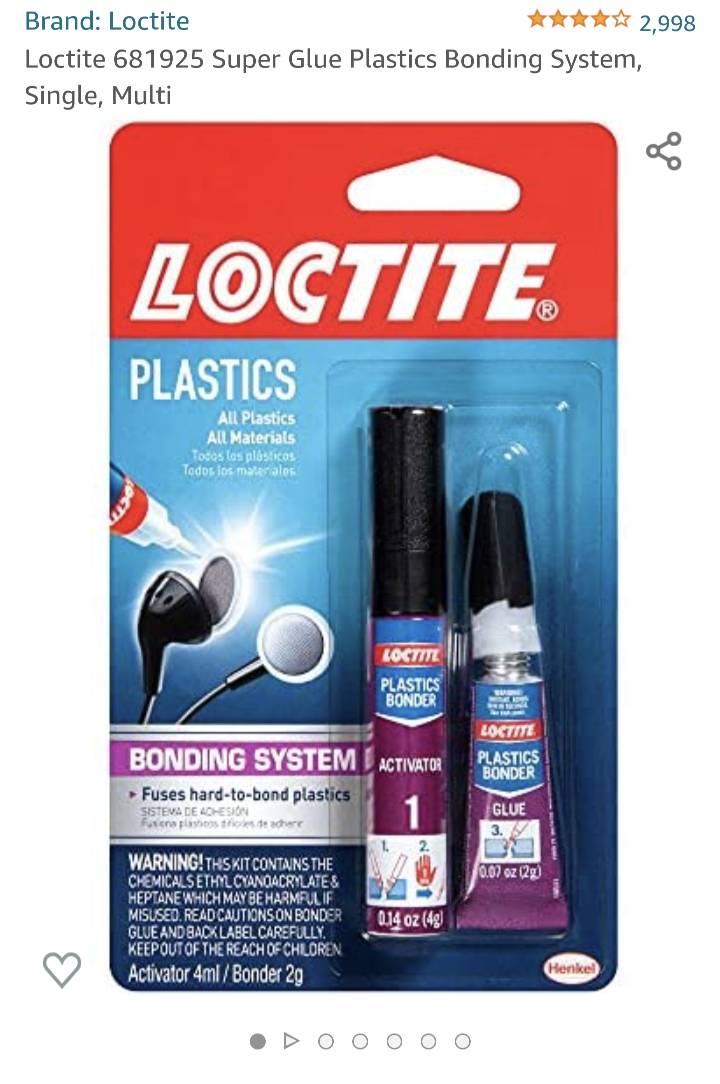

Loctite Plastics Bonder works well for these. It has a primer and then a type of superglue. Standard superglue doesn't bite into the polyolefins very well. I've repaired a number of little interior tabs with the Loctite product successfully.
This one?
This one?
Sent from my Pixel 4 XL using Tapatalk
That sounds ideal JZiggy. Appreciate you sharing. Looks like they have a few such products, one specifically called "Plastic Bonder," but it seems they might be the same, with an activator...
If this attempt doesn't hold-up, good to know I have another option!
