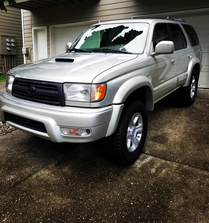

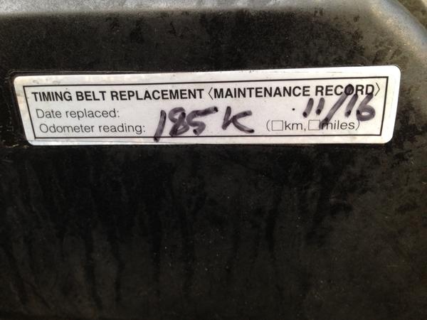

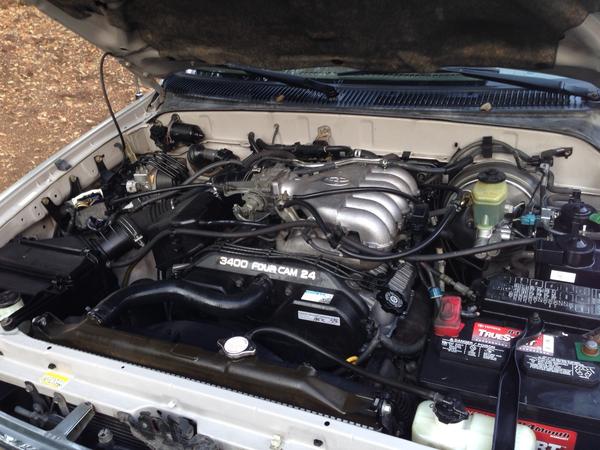

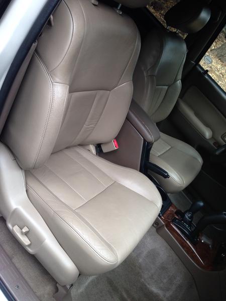

For a baseline though, I’d like to provide some photos for a reference point. I’ll do so at the bottom, assuming I know how to do so…

As stated earlier, some photos…

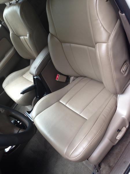

Front seats (Corbeau Moab, Spice, about 39 lbs per seat, compared to 50 lbs for stock)

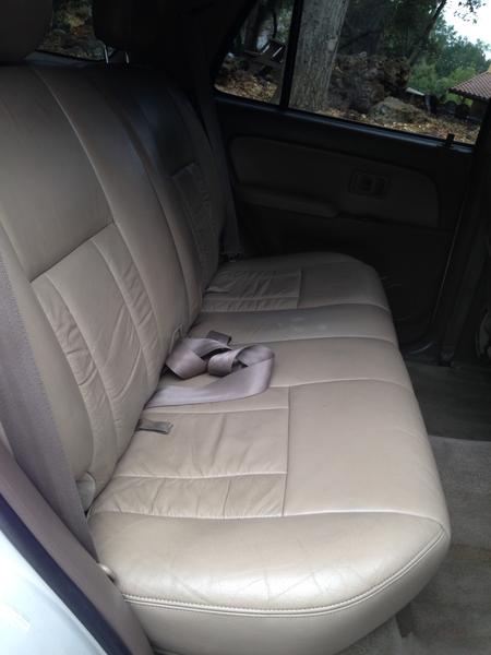

Rear seat covers (Wet Okole)

$400 - Leather Front Seats
