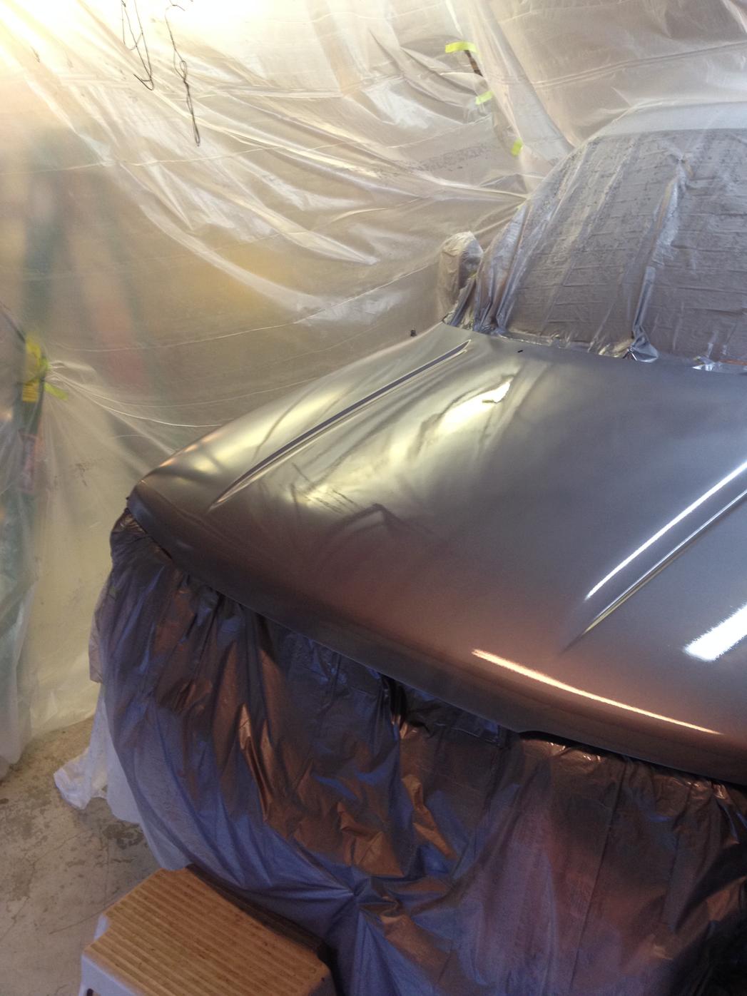

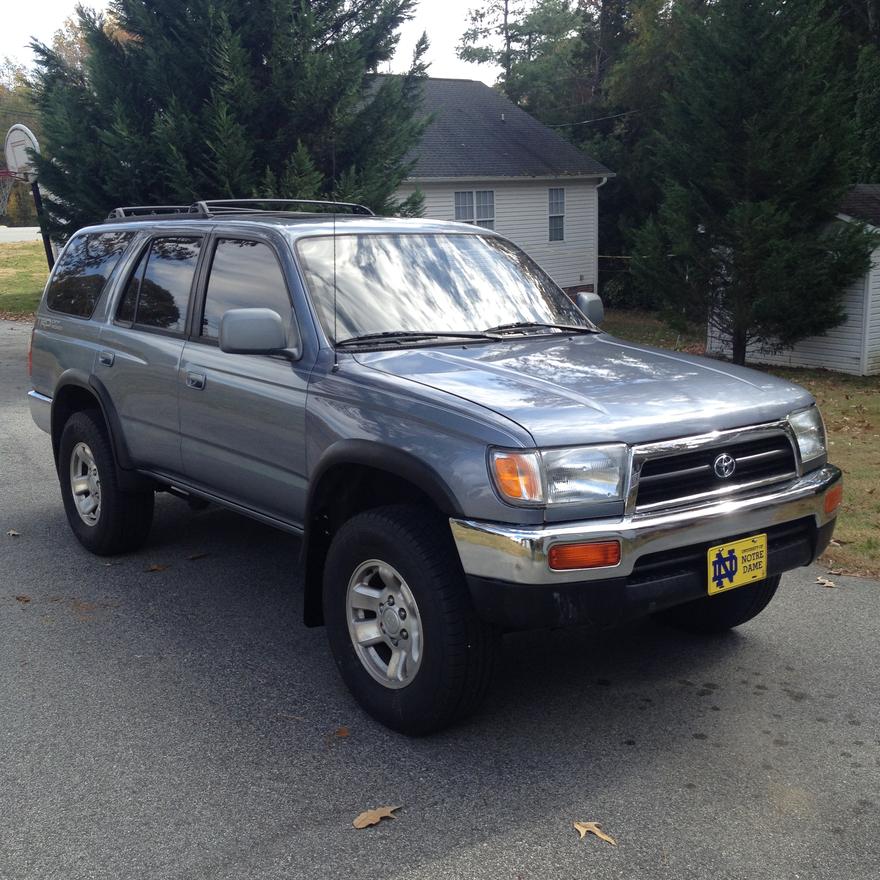

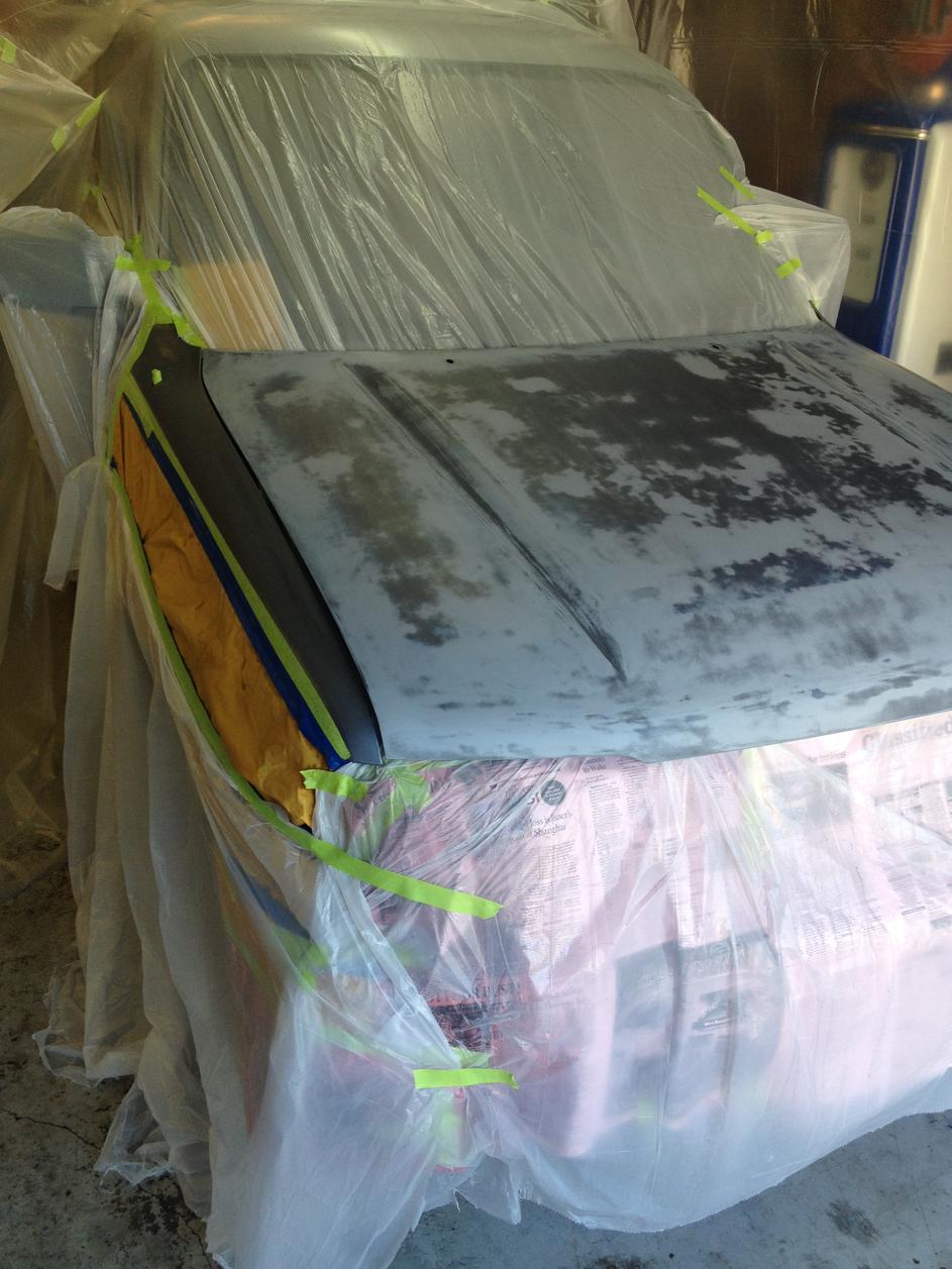

I just went through this a couple of months ago. My hood and fender had clear peeling off. I talked to several people and read a lot of different ideas. Most everyone said don't even try it. However, I thought I would take my time and how hard could it be? I did it in my shop. I bought plastic sheeting and I stapled it to the ceiling ( my shop has plywood walls and ceiling) and let it hang down. I masked the 4runner off and prepped as best as I could. I went to Napa and had their paint guy mix the paint. All the paint materials only cost about $150. I used sealer primer, the base and clear. It was simple, I followed his directions and sprayed a new coat every thirty minutes or so. I tacked it between coats. I used a box fan under the garage door opening and closed off the rest of the opening with plastic. I was concerned about trash but I had very little. I wet sanded and buffed it and it turned out better than I imagined. Good Luck

That looks pretty reasonable as a way to protect the rest of the vehicle, while having room to work. Also, the ventilation sounds like that would help remove the airborne fumes and paint.
