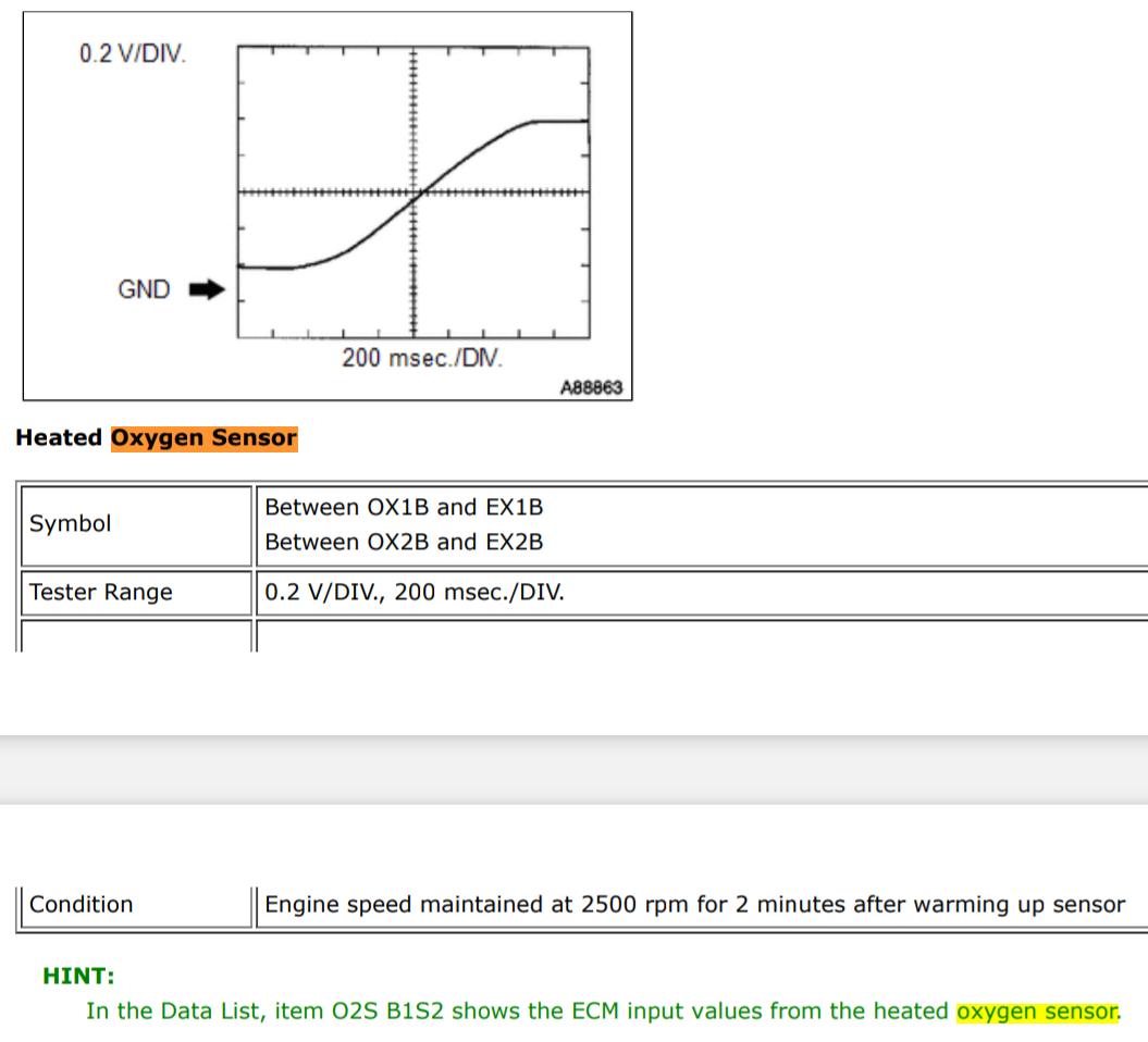

Here is the information on the O2 sensor for 5th gen. Yours I imagine work the same, perhaps different values, same principle. This waveform is what to look for. By the way everytime you unplug that you'll have to reinitialize the PCM. You can monitor them from the PCM terminals with a multimeter. You tuned yet?
