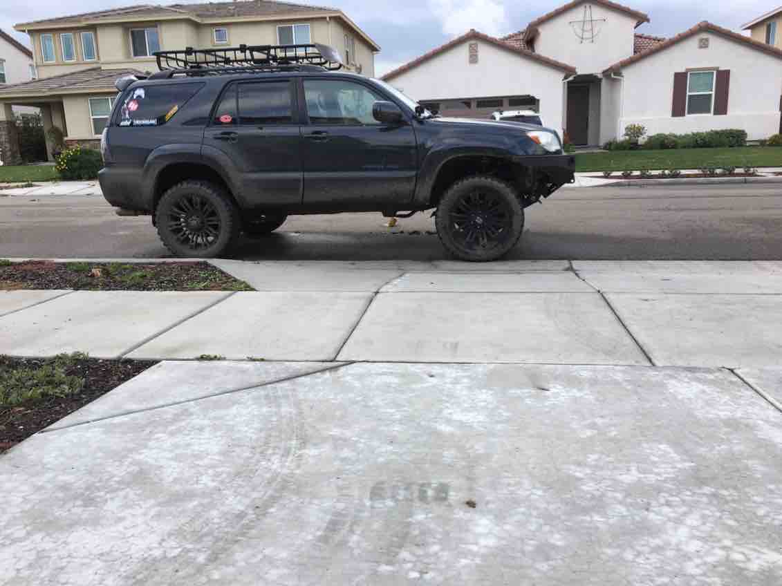

Check out my new lift kit!
No, he ditched his spacers and went to a spindle lift, something only the 2WD guys on here can do. On top of this he has the suspension that may have lifted him that extra .75" he said he gained in the front over the 4" spindle lift. If you're replacing the daystar with an icon stage 1 or adjustable boss lift kit you'll be sitting around 3"-3.5". The 2 kits will allow you to adjust your front ride height accordingly.
Here's my truck that has 3.5" in the front. The rear saga because my rear springs were from Rough County and they've already blown out on me. I'm gonna be replacing them with Icons new Dual Rate springs that are offered through Metaltech 4x4 pretty soon
