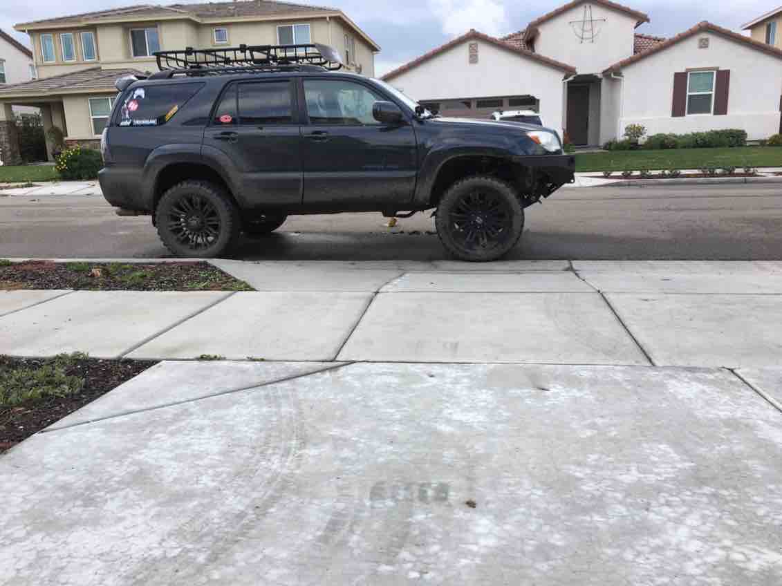

Check out my new lift kit!
gonna be that guy and ask why you wanted this lift for a 2WD truck? purely for looks?
Lets be honest here, lots of people lift their 4Runner purely for looks.
Full size trucks even more so.
His truck has more ground clearance in the front than any 4wd 4runner and if a rear locker is added it's still pretty capable.
Unless your slow crawling rocks or through mud, most wheeling like light trails are completely fine with 2wd.
Nice and level now.
This is interesting to me as it doesn't look level to me. For some reason, the front seems higher than the rear but I'm not looking at the fenders. I'm using the running boards for a point of reference. I'm curious what is the height measurement from the running board to the groun.
I'd hate to try an emergency lane change with that on the interstate. You'd be better off just plowing into whatever you would want to avoid.
The Icon springs in the back should be great for towing. My wife and I are currently in the market for a small boat. A rear locker is also not in the too distant future to help with off-road capability. And, yes, I also did it because it looks bad ass.
So do you have the spacer lift plus an Icon lift? Is that why it ended up being that high? I have a daystar 2/1 and considering the Icon stage 1 or Boss lift kit. Just asking because your truck sits higher than I'd like to be.
No, he ditched his spacers and went to a spindle lift, something only the 2WD guys on here can do. On top of this he has the suspension that may have lifted him that extra .75" he said he gained in the front over the 4" spindle lift. If you're replacing the daystar with an icon stage 1 or adjustable boss lift kit you'll be sitting around 3"-3.5". The 2 kits will allow you to adjust your front ride height accordingly.

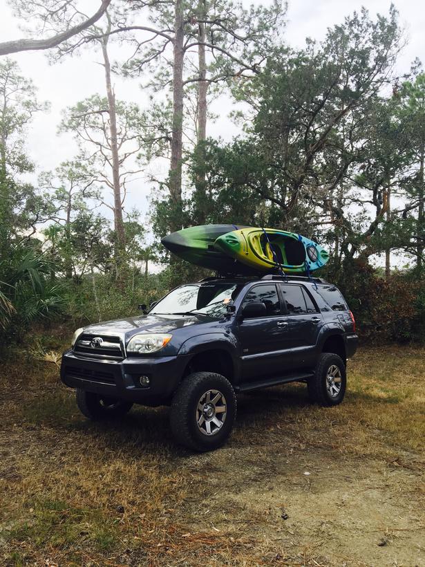

Here's my truck that has 3.5" in the front. The rear saga because my rear springs were from Rough County and they've already blown out on me. I'm gonna be replacing them with Icons new Dual Rate springs that are offered through Metaltech 4x4 pretty soon

I ditched the spacers in the front, but they are still on the back. Most of my front lift comes from the spindles, I have the Icons almost all the way down so theatrically I could lift the front three inches higher, but then I would have a nasty reverse rake (which I hate).
Here is how it's sitting now with the front coilovers adjusted all the way down.
HAHAHA that looks f***ing badass wow. And I'm laughing at these comments "why lift a 2wd with that lift" basically saying that lift is too nice to have on a non 4wd truck but the majority of lifted 4x4 vehicles are solely for looks.
Dude if I had the money I'd buy the newest king/fox/icons with reservoirs and lift that b***h sky high. 4x2 and all I'd have a better lift than most other people because I CAN and it looks SEXY. Let em hate. Looks real nice now next are some shoes ;)
Question, I have toytec adjustable coilovers in the front/Springs in the back, can I add spacers to add more ride height, is that what I'm reading? Is that safe and how big can I go? I want about 2 inches more in front and rear, my bull bar weighs down the front soooo much. Also I hope you swapped your sway bar endlinks with that height you're pushing [emoji51]
I have 1.5" spacers in the back. While the extra height is nice I will say it makes the ride much more firm. Front sway bars are fine. The rear ones came off.
