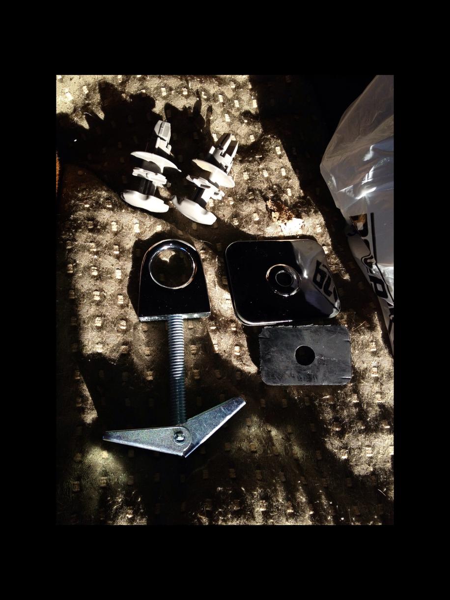

bought two sets of these:

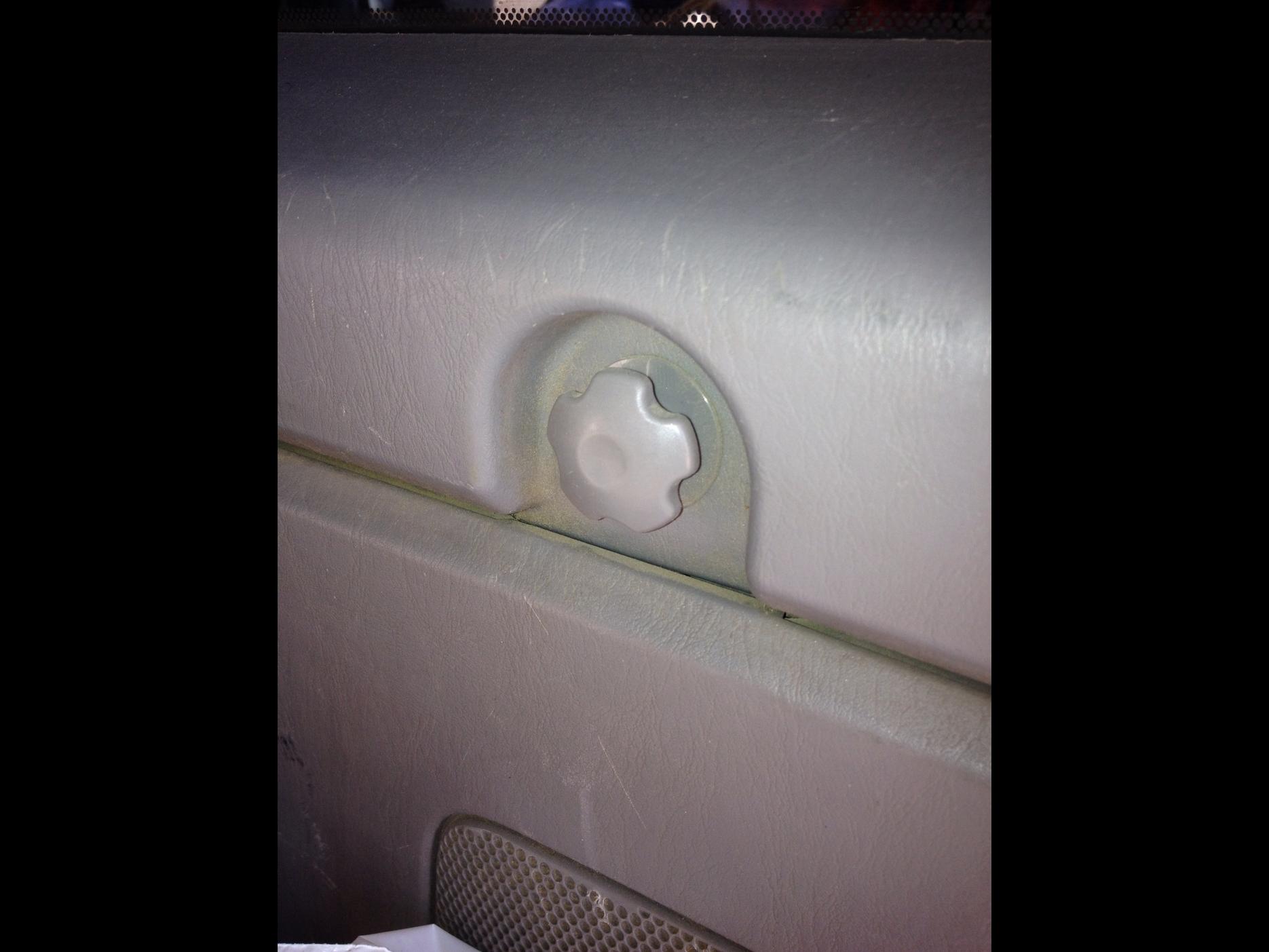

They are truck bed tie-downs which have a removable rectangle base. The bolt diameter fits nicely in the stock cargo-net nub holes without mods.
The bolt is way longer than required, I suppose one could cut them down, but they fit behind the panelling just fine so I left mine original length.

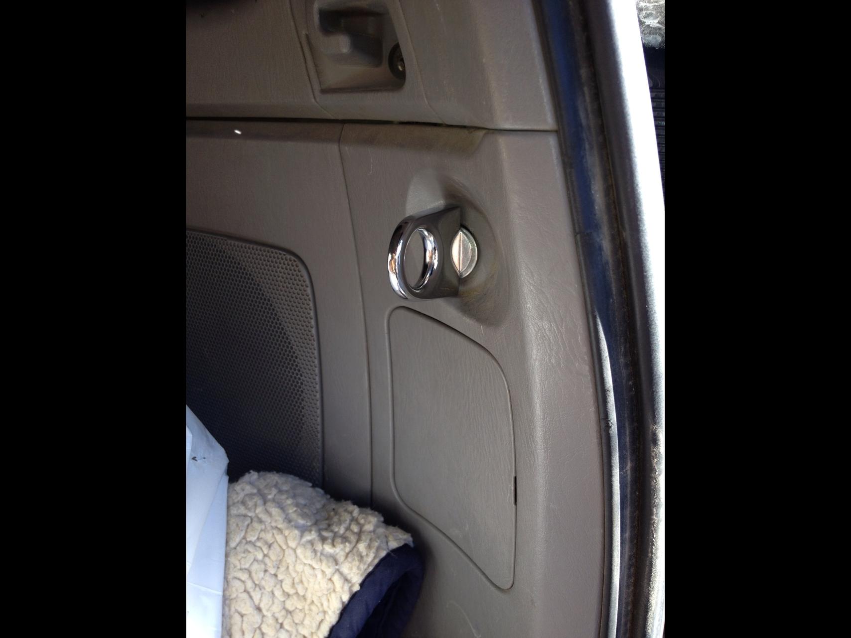

Since the hole goes through not just the plastic panelling but also the metal the panelling is secured to it is quite hearty.
The only PIA part is the further forward one on the passenger side.
because how it is placed with respect to the rear sub area (or storage box depending if you have the upgraded JBL with rear sub or not) is very hard to get in behind to fit the nut to the bolt. It is possible, however, depending how bad you want that one.
Well there it is...another easy weekend mod for ya all.

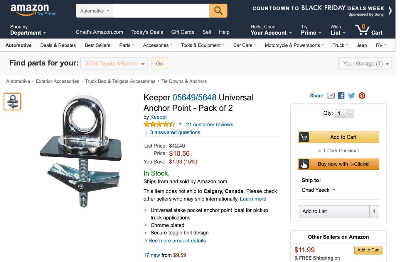

http://www.amazon.com/Keeper-05649-...p/B00004Y61N/ref=cm_cr_pr_product_top?ie=UTF8
Are these what you used?

Amazon.com: Keeper 05649/5648 Universal Anchor Point - Pack of 2: Automotive

Those also don't seem to stick out as far.
I was wondering from your pictures if those stuck out enough to bother anything...also wonder how far those with the round base stick out too? A smaller foldable D ring sounds interesting but those could possibly rattle since they pivot?
I suppose the d-rings could potentially rattle. Could potentially "Pinch" them up a bit somehow to make them tighter if needed.
The loops do stick out a bit. I did think about that after the instal. However, I have yet to run into any issue where they were "in the way". I suppose if they did end up in the way they are super easy and fast to take out if needed. Really they have been nothing but useful for me.

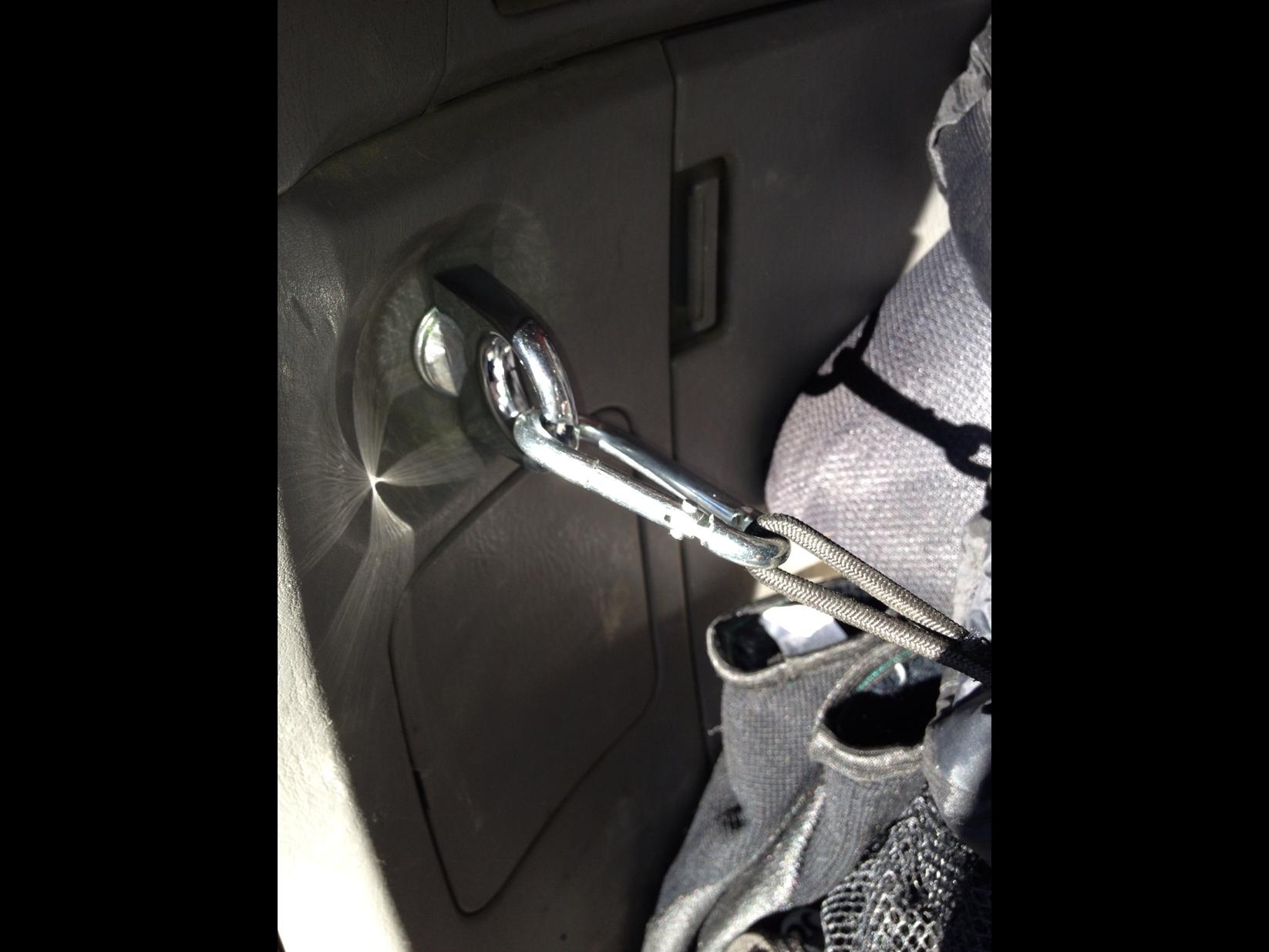

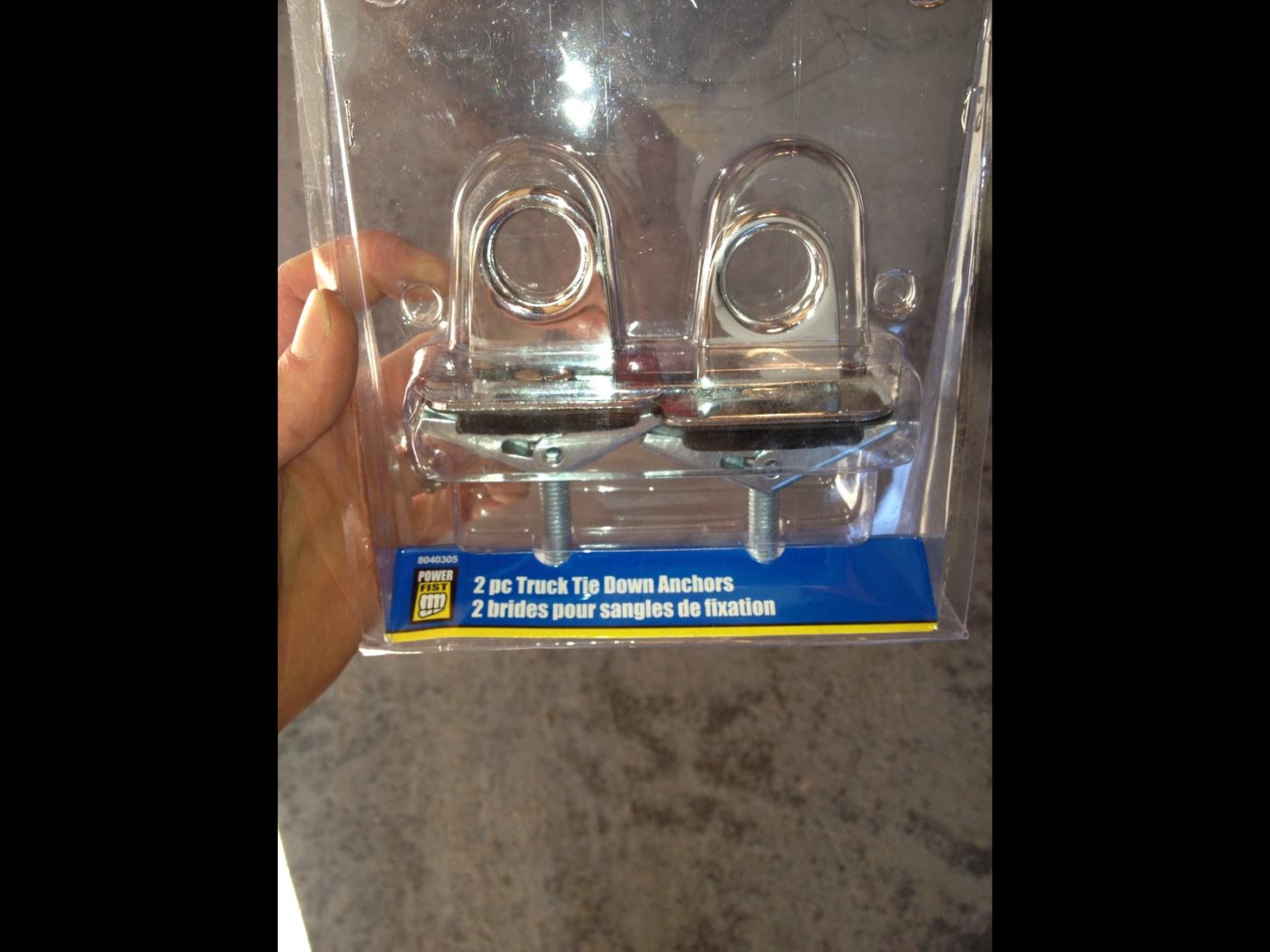

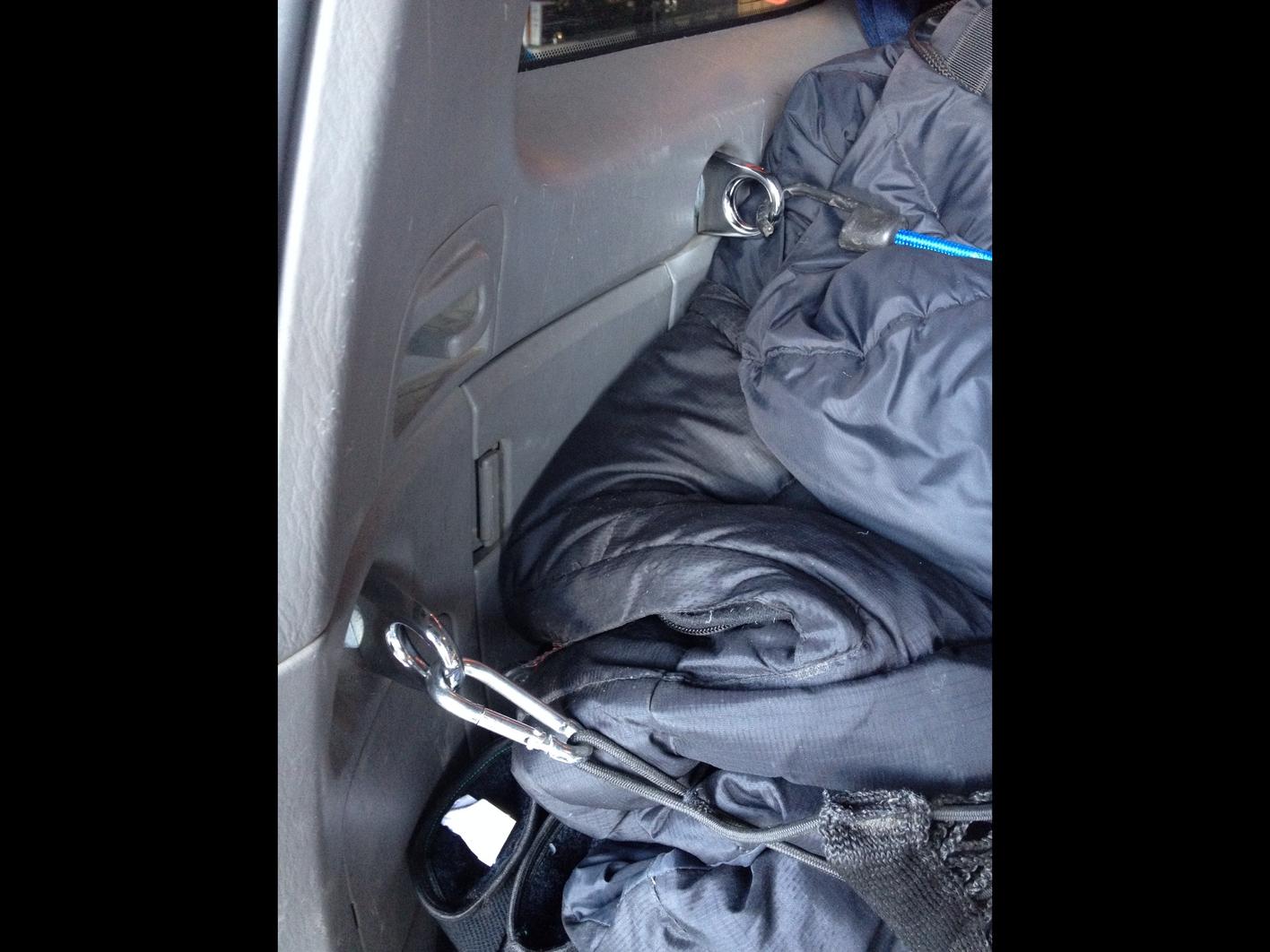

2022 revival of this thread. I installed these as well and wish I would have done this years ago. The chrome tie down with ROK Straps makes the cargo shelf actually useful.
What I ordered:
Dog River Tools Stainless Steel Multi-Purpose Tie Down Anchor Strapping Hooks for Mounting in The Garage, Work Shop, Truck, Trailer, Golf Cart, Fence (8-Pack)
Amazon.com: 3 Inch Stainless Steel Spring Snap Hook Carabiner, 316 Stainless Steel Clips, Small Carabiner Set of 4 : Sports & Outdoors
ROK Straps ROK-10050 Black/Reflective 18" - 60" Motorcycle/ATV Adjustable Stretch Strap
Pictures:
What I did:
I installed the chrome tie-down points as described earlier in this thread. The passenger side one is a bit annoying. I used the instruction from this thread to remove the panel and install the tie-down. I do not have the JBL system, so I just have the storage compartment there. I followed most of the steps, but I was able to get the panel pulled away far enough that I could reach up through the cargo area, behind the panel, and install the hook. I left the black plastic part on for the upper tie-downs. I installed without those black plastic pieces, and it would look nicer, but the bolt ended up pushing out the body panel and slightly cracking the clear coat/paint. If I do it again, I would get a washer or two the size of the tie-down to stop the bolt from touching the body.
The ROK straps are awesome. I like that they have some stretch, but can be opened without disconnecting from the tie-downs. Really makes the upper shelf useful.
The anchor points I bought for the ceiling are ok. I think a D-Ring or something similar would be better, but I bought these on a whim and don't really have a good use for them yet. I will use the drivers side ones to hold a fishing rod using that cord I have on in the pictures.
