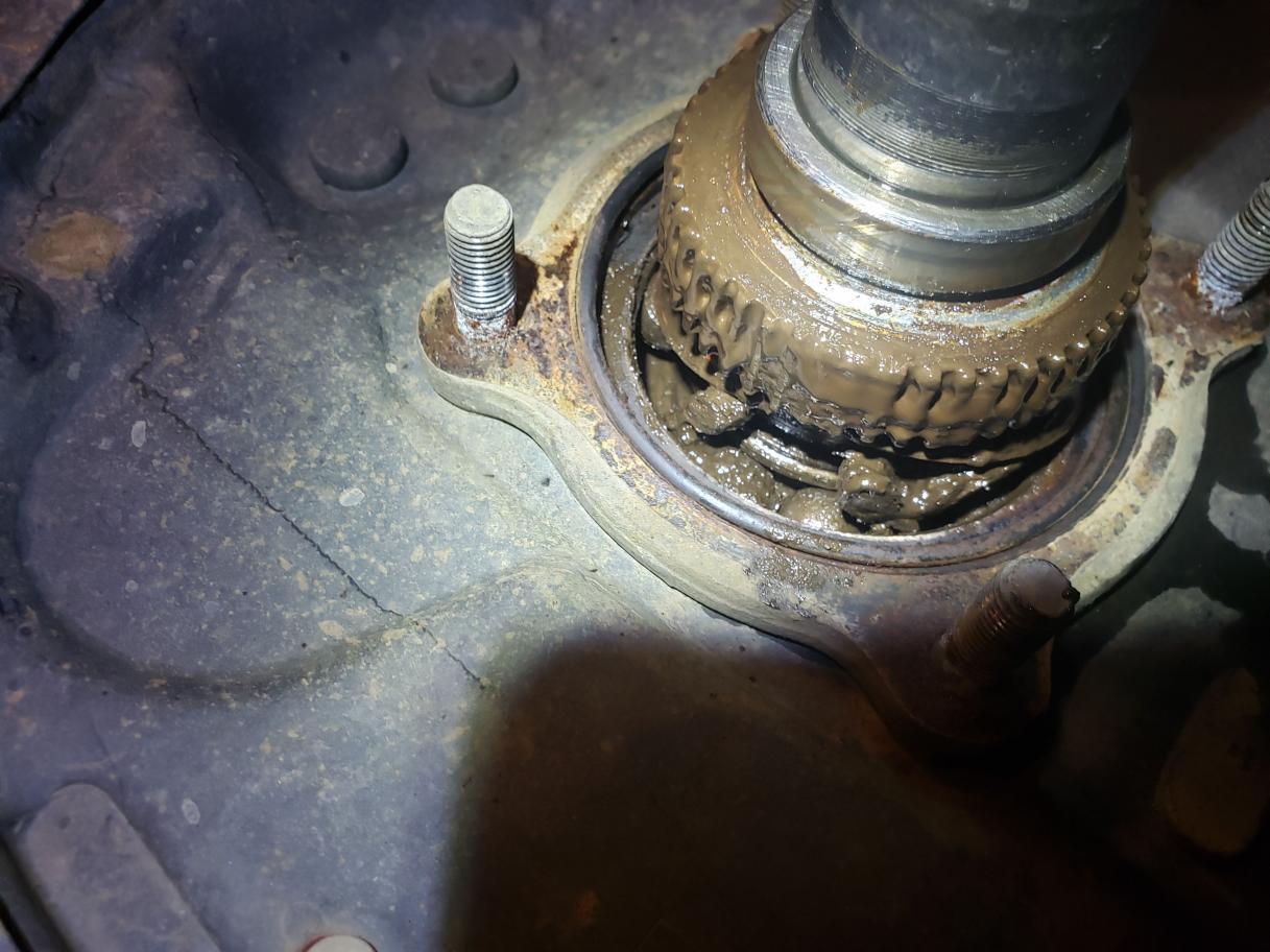

Thursday, while heading back to the office from a jobsite, the rear driver's side wheel bearing partially locked up and exploded! Wound up limping off the interstate to a church parking lot and jacked up each wheel to spin them. Every one was smooth except the driver's rear. At first, I just thought the brakes were messed up until I drove around the parking lot a little more and could tell something major was wrong.
I limped home 14 miles going 30mph with my blinkers on. Very noisy and bumpy ride... lol When I got home, I was relived to find that it was the wheel bearing and not the rear diff!!

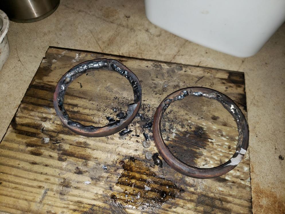

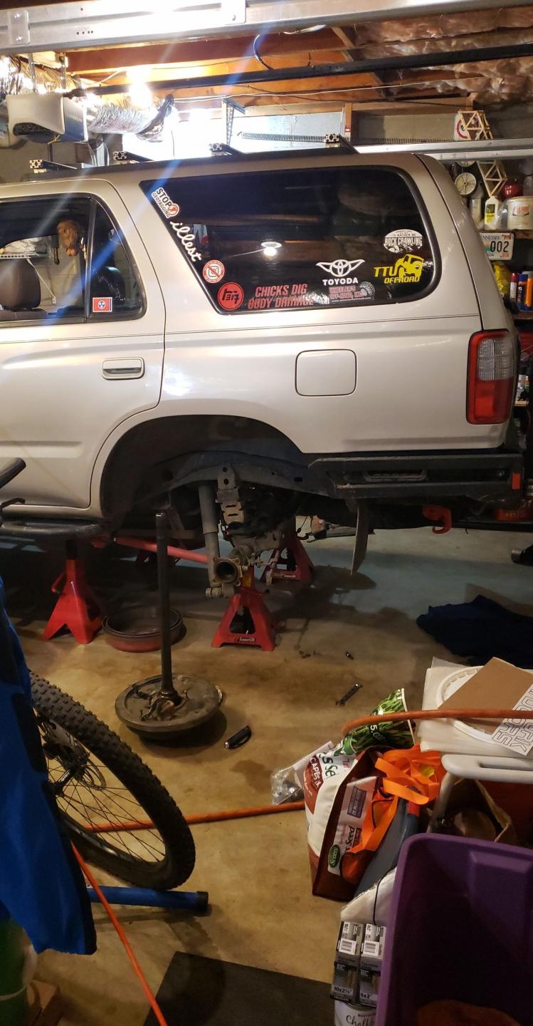

So with my surprise half-day off work, I cannibalized my original rear axle to make a press tool and got to work! The steel I used was all free stuff I dug out of trash cans on a jobsite btw :rockon:
Friday, I was able to get a bearing and seals from the Toyota dealer nearby. When I got home from work, I tore the axle apart and was not able to get the outer race out of the bearing cup.
Saturday, after asking for advice, I welded a bead on the race and chiseled it out from the backside. It wound up breaking in half and I repeated the process to get it out.
Luckily, everything went together really easy! Went for a test drive and everything was nice and smooth!

Was that the original wheel bearing? The grease in there looks more like mud, probably had some contaminant ingress that contributed to the explosion.
I think it had about 70k on it. Probable had some contamination in there for sure LOL

Well, after the fact, the ticking noise I had been hearing while cornering went away. It had been doing that for probably 6 months.
On the day it happened, no warning signs... it just started grabbing while going 65 on the interstate and at first, I thought the AC compressor had locked up, but the engine idled fine.
