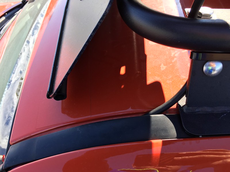

wiring for light bar
Hi, I ended up running the wires under the weatherstripping and down the driver's side windshield and into the engine bay. I'll try and snap a few pics and post them on here.
hey, [MENTION=62757]chudiddy[/MENTION] did you ever post pix of how you ran the wire from the light bar. i have my wire running in that tiny valley between the windshield and the body, but I can't quite figure out how to get it to stay put.
can you fill us in (preferably with photos) on what you did? thanks a lot!

Sorry for delayed response. Here are some pics of the wiring. When you run the wire down along the windshield gap, strip away the black sheathing and only run the black and red wires so the weather stripping sits flush. Hope this helps.
Thanks, dude! what a great move that was! I've been racking my brain on what to do with the wire, and this is the perfect solution. super clean. i refuse to drill through the roof to run the wire, and this solves it. thanks again, and great looking build. FYI, I've read that the bushwackers can damage the paint, so you may want to put in some 3M protective tape like you did with the wind deflector. i actually did the same exact thing with the wind deflector.
