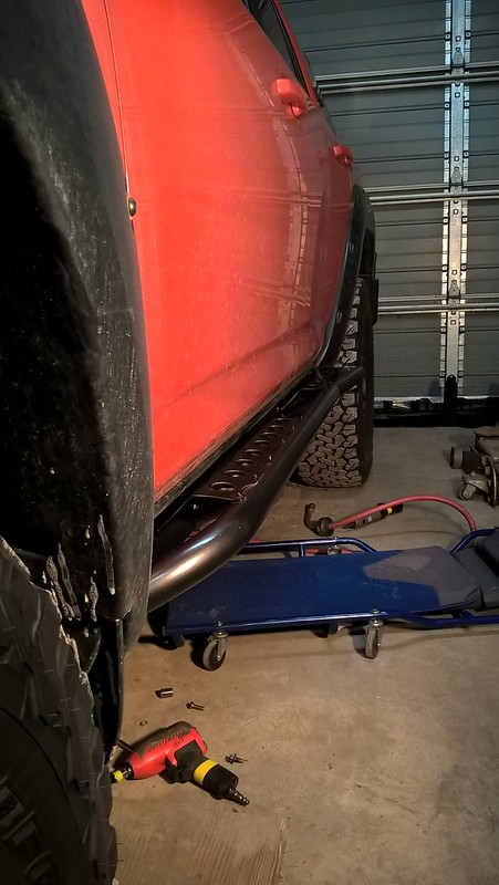

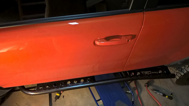

What did you do to prep the metal and then what paint did you end up going with? I'm very interested in those sliders!
Awesome build man. On the sliders, were the removable top plates a custom order thing or are they now making them all bolt-on rather than welded on? I really like the idea of being able to remove them if you choose.
All of the sliders now come with removable step plates. We have gotten a couple requests for this option to make it easier to paint. It really doesn't take us any longer to make them this way, so we made the change!

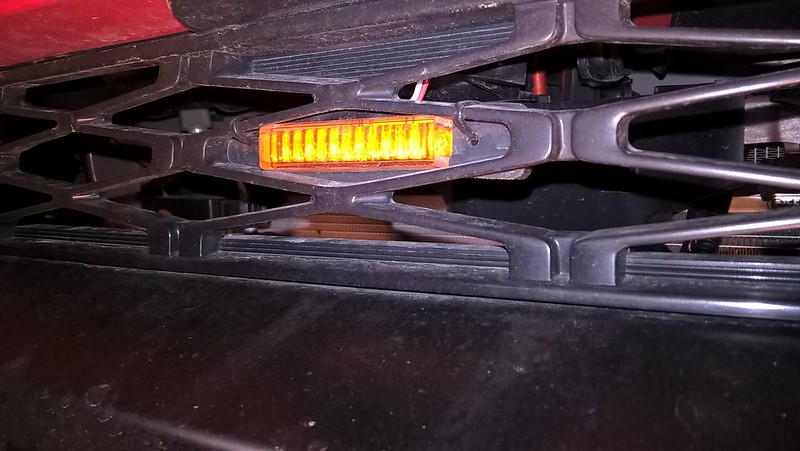

Ok so since the most common question regarding my truck has been the 3 Amber Lights in my grill, I thought I would do a quick, simple write up on what was used, how they're mounted, and how they're wired. Its actually more simple then what people think.

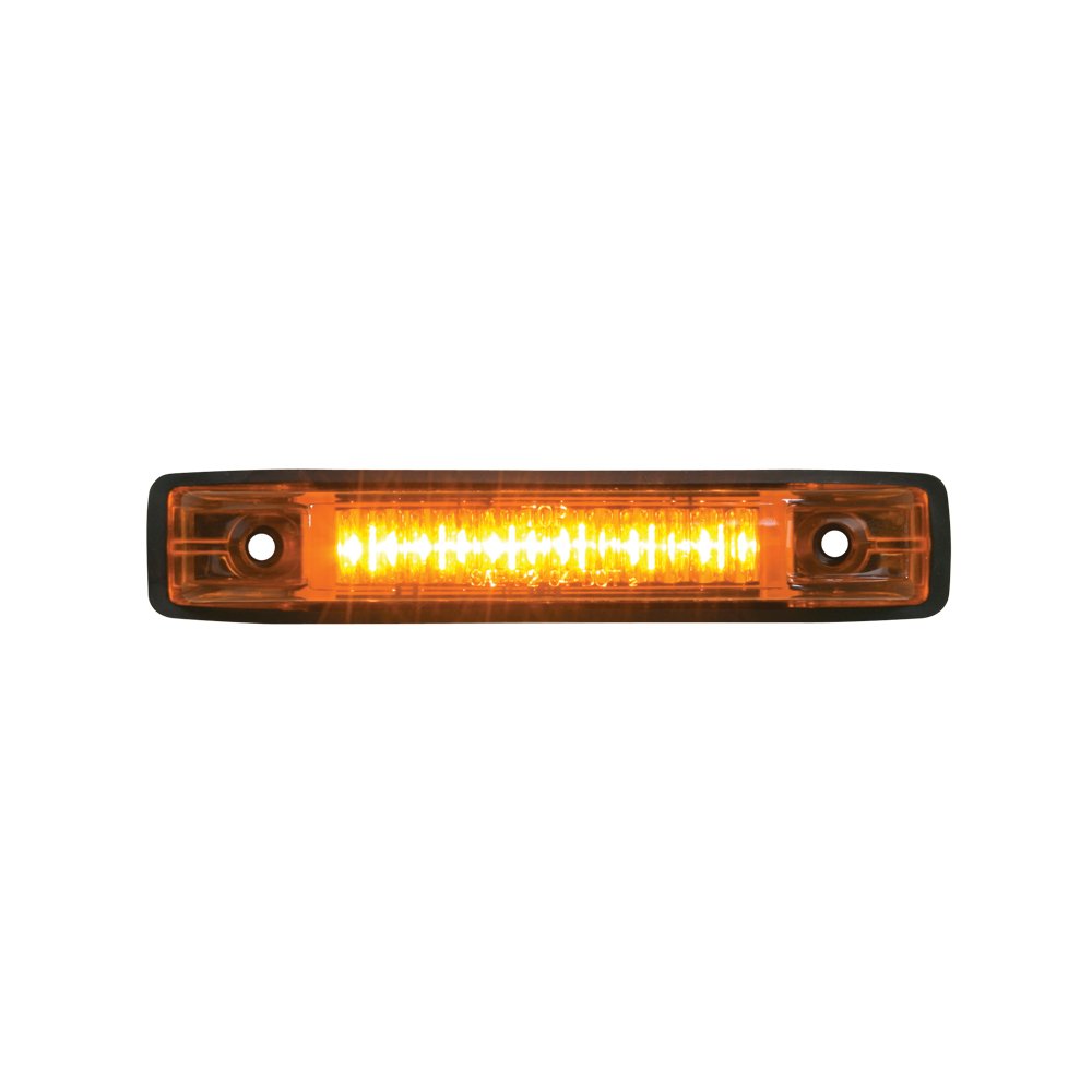

First off these are the Amber Marker lights I chose:
Amazon.com: Grand General 77650 Amber Thin Line 6-LED Marker and Clearance Sealed Light: Automotive
The next part pertains to installs for the TRD Pro grill: What we ended up doing was trimming the plastic ribs that extended off the main body of each marker light. That way they fit in each opening of the TRD PRO grill. A bench grinder was used to do this although i'm sure a dremel would work as well.
Ok next is the hardest part:
The marker lights are simply attached to the grill using zip ties. Simple, yet effective. That's it!!
As far as wiring goes, the marker lights are wired in parallel. Take all the red (positive +) from each marker lights and wire them together. Do the same thing with all the black (negative -) wires and wire them together. Then take each red and black wire and tap in to the corresponding (+) and (-) parking light wires. Solder them up, wrap them in electrical tape, and VOILA...you're done.
You do not want to wire these LED's in series, there will be a drop in voltage if you do this and won't be as bright.
Enjoy!!​
[MENTION=62757]chudiddy[/MENTION] your set up is amazing! I have the hybrid bumper coming in a few weeks. What winch are you using and what is that orange piece on the outside of the bumper holding it there?
thanks for the info. it appears you shaved the rounded ends off the lens covers and cut some sort of rubber/plastic cover to slip over the front, correct?
they fit really well in those grill slots with the ends trimmed off. great work
+1 I would like to know what you cut to go around the LED bars.
Updated the write up to include what was done to make them fit. I forgot that step. Sorry

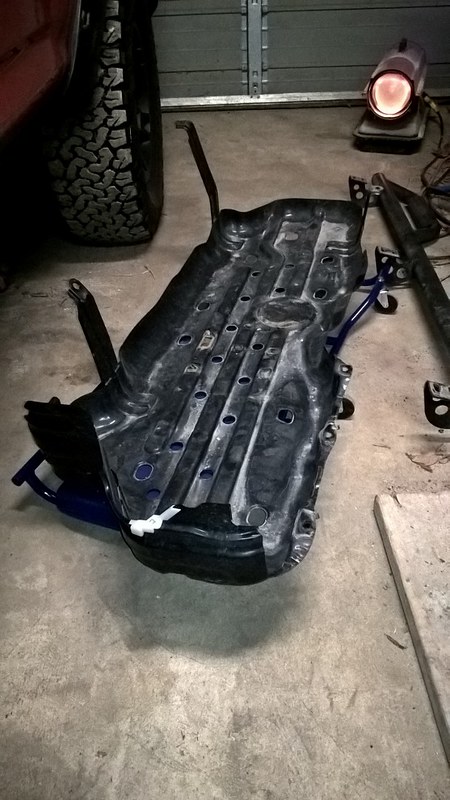

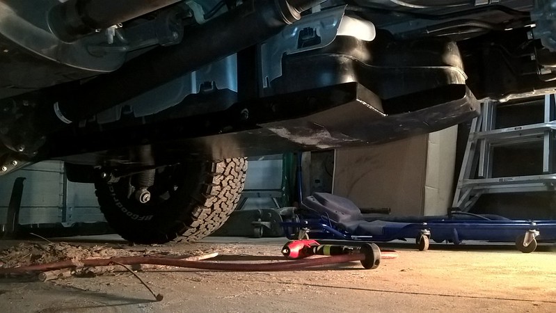

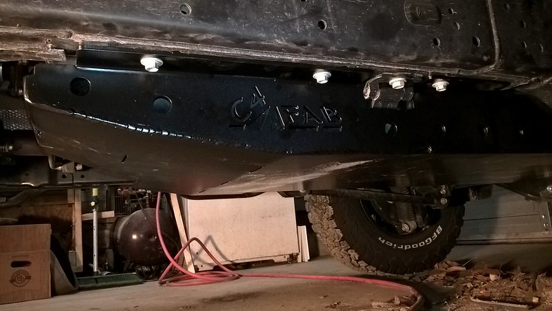

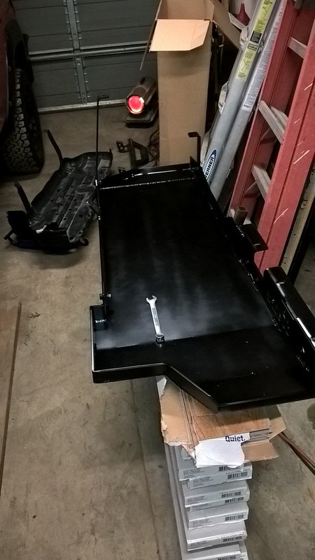

New Fuel Tank Skid and Sliders are mounted. Still a few more things to do.
OEM Fuel Tank Skid:
C4 Fuel Tank Skid:
Sliders installed:
Really can't say enough about the quality of the skid and sliders. Wonderful craftsmanship and build quality. Super pleased with them.​
Update...
Thanks so much for the positive comments on the products. Im glad they fit well and you are pleased with them!:hatsoff:
