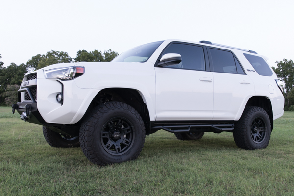

Had the [MENTION=131444]C4 Fabrication[/MENTION] sliders installed for about a week now. Just getting around to posting some pics of them. I think they turned out great and i'll say it again...the sliders and the fuel tank skid are a work of art. They are beefy and look amazing. I 100% recommend them. Enjoy the pics.

After my recent trip to Rausch Creek, it seems the suspension has finally settled and has softened the ride up quite a bit. I actually like this as the ride is not as stiff anymore. I am still very happy with the spacer lift, I think it compliments the TRD suspension nicely. For the serious off-roader however, it probably wouldn't suffice.
When I upgraded to the 285's, I got quite a bit of rubbing. Even worse after Rausch Creek. I recently did the body chop mount mod on both sides and now I have absolute no rubbing whatsoever. I'll try and post some pics but you can hardly tell anything was modified.

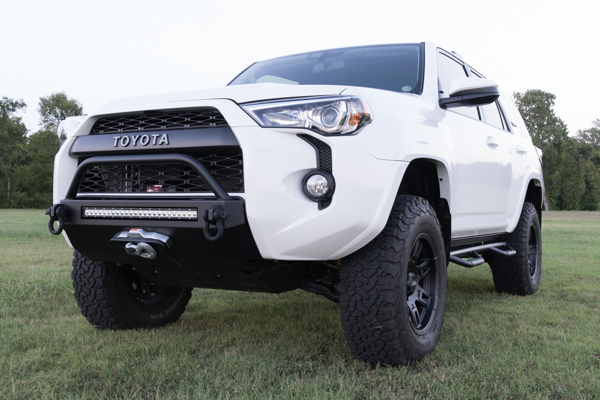

Which rear bumper is that? It is hard to tell as most only show pics with swing arms on them and I definitely havent really looked at all of them. Hell I am still trying to save up just to do the front bumper. I am doing the SS slim with Loop, have to bu a new light br probably. Rigid 28: E2 if it will fit, and a Warn Zeon. That shit right there is 3k easy. Hard to do when I am sending off my Glocks to Agency Arms to get a make over.. To loves and they will break you Firearms and Trucks. Either have a damn good job with good income or a well paying sugar momma. Not this military retirement stuff. By the time I am able to save up to get everything done it will be damn near 10 years old.... Haha

Steve, this is the CBI Rear Bumper. I opted not to get the swing out just because I need access to my trunk quite often. The rigid E2 28 is exactly what I have in the front bumper, took a plasma cutter to extend the length but the height fit perfect. I cut about and inch off on each end to fit it but it came out perfect.
Thanks. I like the looks of it. Have used swing outs before. I like the ones that open automatically with a swinging door. But they become problematic with the regular ones and two armed swingouts. Especially with regular use, they tend to stick out a good bit when parking and doing every day stuff. Though on the positive side they do provide an excellent platform for mounting items.
IE the SS Bumper and the 28 Rigid E2. "Height fit perfect" that is the regular cut that SS had on the bumper? They will not cut out the bumper to 28 due to the welds with the tubular bar and the mounting points for the recovery anchors. They also said bends and welds prevent them form cutting any larger than they do. I take it that they cut the bumper pre production. Not after the bumper is assembled and it prevents them from being able to cut it out. Without having the skill or anyone with a plasma cutter being able to cut it out I may be forced to use a single instead of double led light bar. It is unfortunate.
Yes the cut for the single row led that they include is the correct height for the E2 Rigid 28. I was fortunate enough that my friend had both a plasma cutter and the knowledge to use it to fit the 28 E2. Huge difference.

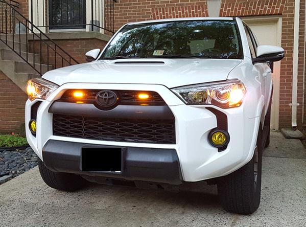

Ok so since the most common question regarding my truck has been the 3 Amber Lights in my grill, I thought I would do a quick, simple write up on what was used, how they're mounted, and how they're wired. Its actually more simple then what people think.

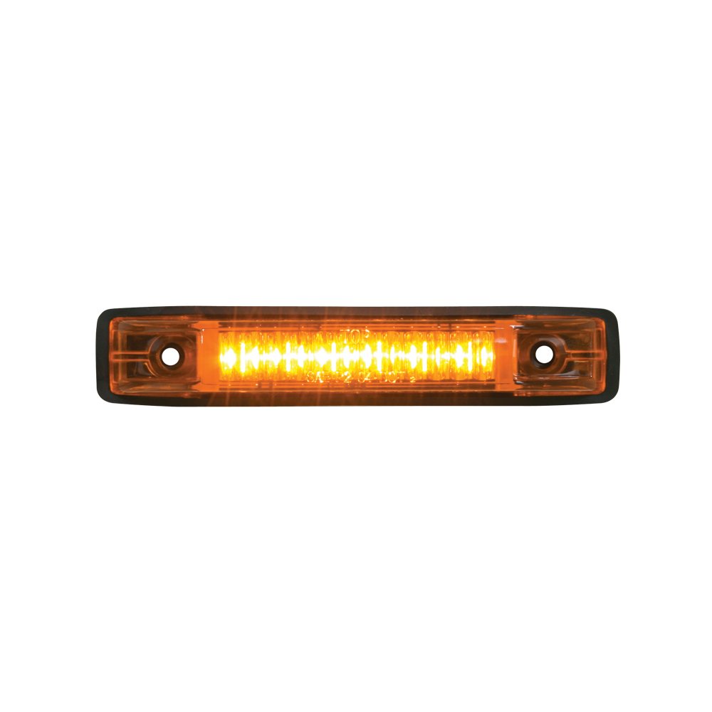

First off these are the Amber Marker lights I chose:
Amazon.com: Grand General 77650 Amber Thin Line 6-LED Marker and Clearance Sealed Light: Automotive
The next part pertains to installs for the TRD Pro grill: What we ended up doing was trimming the plastic ribs that extended off the main body of each marker light. That way they fit in each opening of the TRD PRO grill. A bench grinder was used to do this although i'm sure a dremel would work as well.
Ok next is the hardest part:
The marker lights are simply attached to the grill using zip ties. Simple, yet effective. That's it!!
As far as wiring goes, the marker lights are wired in parallel. Take all the red (positive +) from each marker lights and wire them together. Do the same thing with all the black (negative -) wires and wire them together. Then take each red and black wire and tap in to the corresponding (+) and (-) parking light wires. Solder them up, wrap them in electrical tape, and VOILA...you're done.
You do not want to wire these LED's in series, there will be a drop in voltage if you do this and won't be as bright.
Enjoy!!​

Love the LEDs. I'm going add this mod to my truck. Rather than wire to the parking lights, what can I tap into to keep it on as long as the truck is started? The harnesses to the lights are a bit tricky to get to.
It is easier to tap into the parking lights, you can grab it right from either side. If you want it on constantly then you have to connect to ignition which would be more difficult. Hope that helps.
