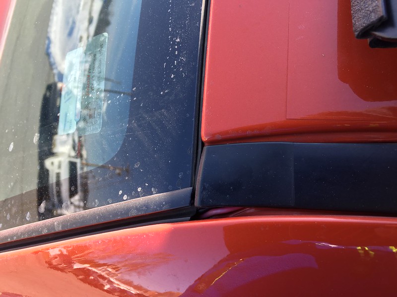

The Gobi roof rack comes pre-wired on each side with openings at the 4 corners for you to tap into. For the LED light bar in the front, I ran it down the drivers side under the windshield molding. I cut the weatherstripping away from the wires and ran those down the channel. Makes for a nice, clean install. The rear lights are run through the wire loom that feeds into the rear hatch area. I believe I posted some pics a few pages back in this thread.
Here is a pic of the wires running down the drivers side windshield.
Just seeing this. Nice and clean. I ran my wires actually on top of the windshield molding, in the rain channel. I used a screen roller to stick the wires in there, but I don't like how it looks as much as I like yours. I never thought there was room under the molding, I think I will pull the molding tomorrow and put the wires underneath and see if I can achieve that same clean look. Nice build!

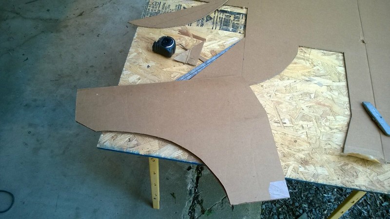

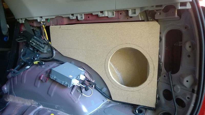

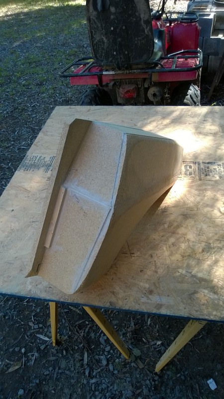

Ok just a little teaser update of whats going on in my build. This is really exciting as we are nearing completion of a truly "one off" build. I will let the pics do the talking:

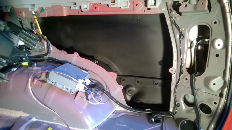

Rubberizing the inner fender:
Creating templates:

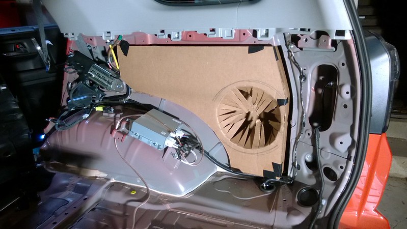

Cardboard mock-up fitting:

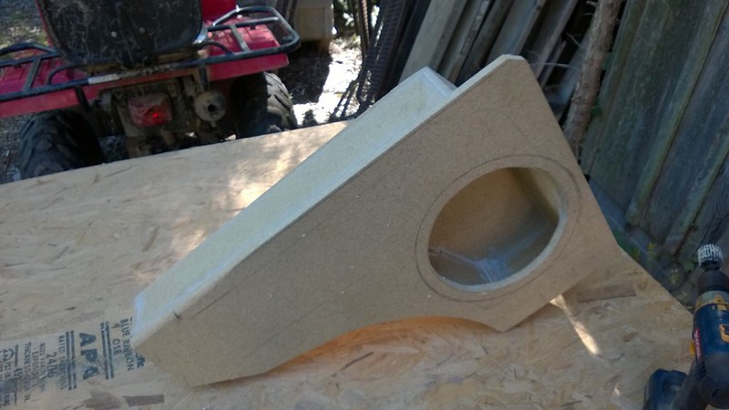

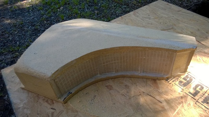

Building the box:

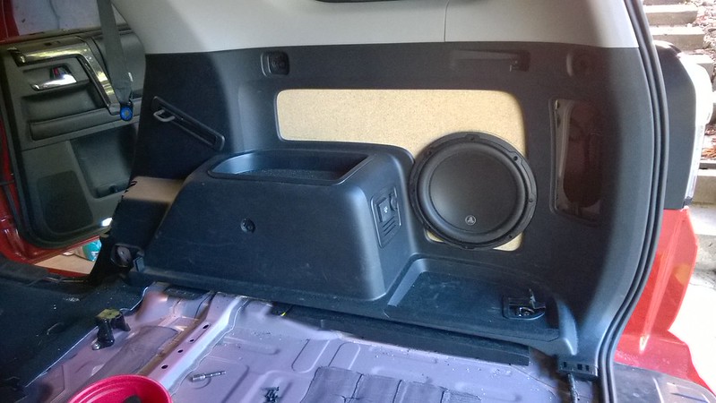

Perfect fit:
That's it for now, a few more tricks up my sleeve and i'll post the final product as soon as its complete. I can say that it sounds amazing. I'm really excited to get my 4Runner back, its been 3 weeks between doing the bumper, winch, all the lights, and the stereo work. All worth the wait though!!
My friend receives all the credit for the work, i've mentioned it before but he is a sheer genius when it comes to this stuff and I am so grateful to have him do this for me.
Stay tuned...and thanks for following along.​
So... What does one have to do to get you to build a second subwoofer box? I just won an OEM Audio Plus system at the FJ Summit Raffle... Their Subwoofer box goes on the driver side. I would prefer to have it in the same space as yours.
Great looking 4runner. I purchased one two weeks ago and want to add a sub in the back, similar setup to what you have. Which JL sub were you able to put in there? The enclosure looks great, you have any specs or measurements?
Hi, I can ask my friend who built the box. He put a lot of time and effort into the box to truly make it one off. Not sure what he would charge but it would be more about whether he had the time to do it or not.
JL 10" W3, no specs on the box, sorry about that.
