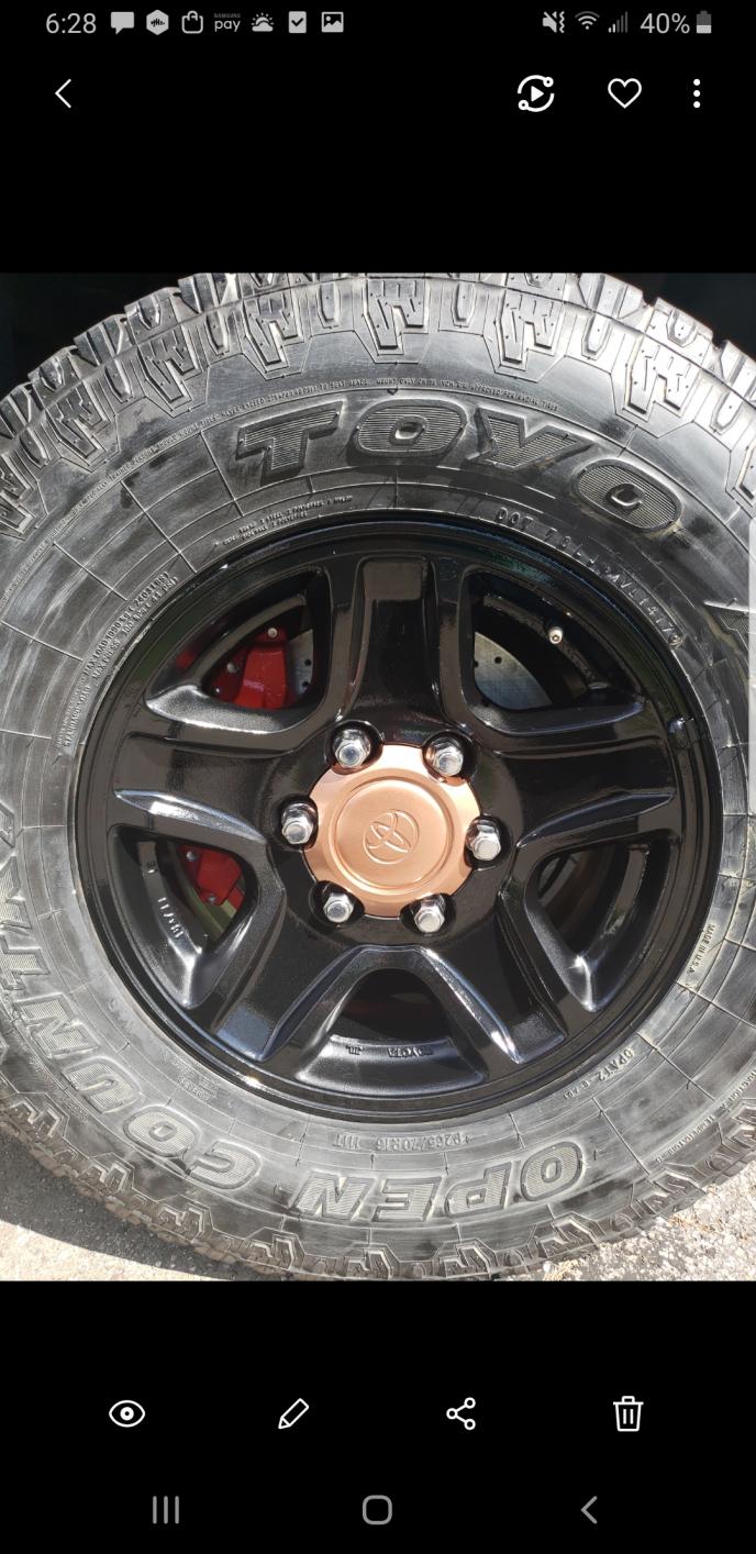

Planning the brake conversion on my 2002 Limited and have done lots of research but can’t seem to find consistent answer to this: Will the 231mm Tundra calipers clear my stock 16”, 5-spoke wheels without modification? If not, I’ll install the 199’s.

From what I've seen, the answer is yes (assuming you mean Tundra, not Tacoma).

If they're the same dimensions as my 5spoke then they will with actually a comfortable amount of room.

Yes. 231mm will fit on those (aka "coke bottles").
I had those on my truck when I did the 231mm Tundra conversion. Later got Method's.

What paint did you use to paint your rims? Any primer or sanding looks good thx
I took a fine wire wheel on an angle grinder to them and stripped them down to complete silver. Took about 15 minutes per rim. (And some beer) I did inside and out. Then I primed them with Rustoleum grey primer in a taller than usual stainless steel rattle can and then finished with outdoor rustoleum gloss black protective enamel and center caps I used a rustoleum metallic spray can also primered before hand. I appreciate it!! I also have my front emblem painted the same metallic and plan on doing all the emblems if the paint holds up well which it has so far.
