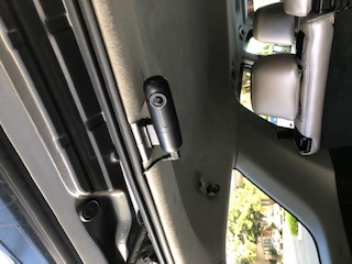

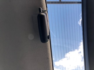

The clips i had weren't wide enough for the base of the mount for my cam so i actually just stuck two money clips side by side. cheap solution and not noticeable. cut/trim the clips as you wish for a more minimalist look but i just left them as is. (**EDIT** i dont know why my pics always uplaod sideways)

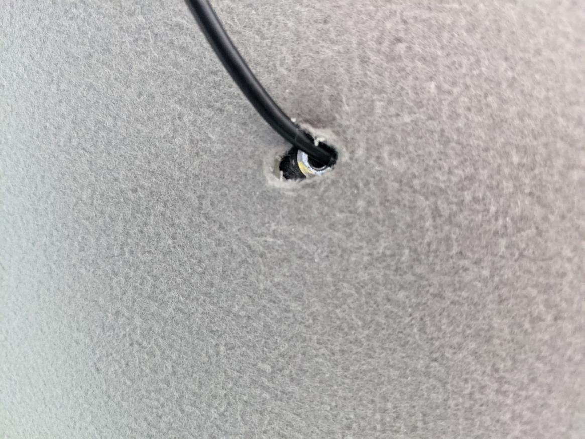

When you remove the headliner clips, is the hole there already threaded for a bolt or do you have to make it?
How are you feeding the cable from front to rear? Right now I'm actually going down the sides and along the floor but all of these look across the headliner - did you have to remove the entire headliner to get the cable through?
I picking up my new 4runner next week! Already have a dual channel cam to install.
Not threaded. I tucked the wire up along the edge of the headliner. Worked pretty well and did not require the whole thing to come down.

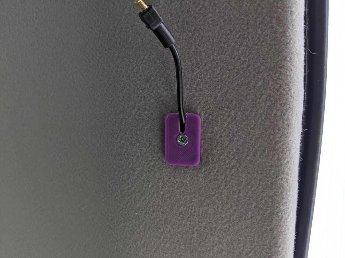

I reused the push pin thingy from the rear headliner, I just had to trim one side of the tab so it would fit the bracket:
I decided to off center the rear cam to the passengers side so I could reuse the same headliner mounting location, plus I won't get the ladder in the frame:

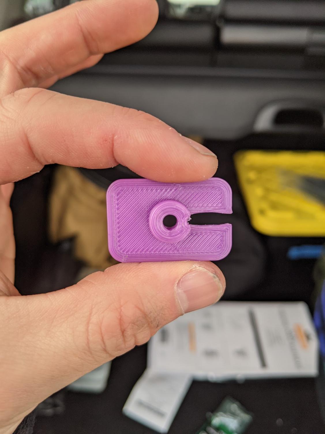

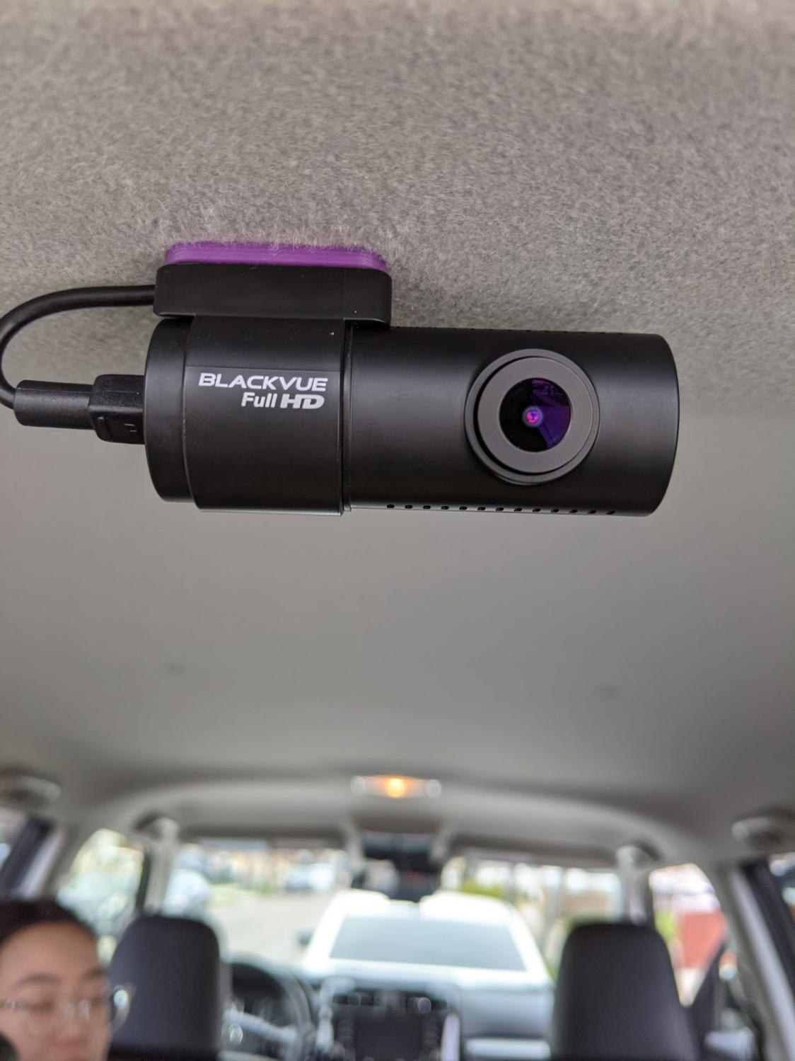

Well, I had no luck reaching out to the OP for the STL file, sooo, me and my friends made our own! 3d printed but the dimensions were a little bit off for where the wire is threaded but we just cut some 3d printed stuff away.
Key thing is to get a threaded riveter tool and the right dimension bolt and threaded rivets .
