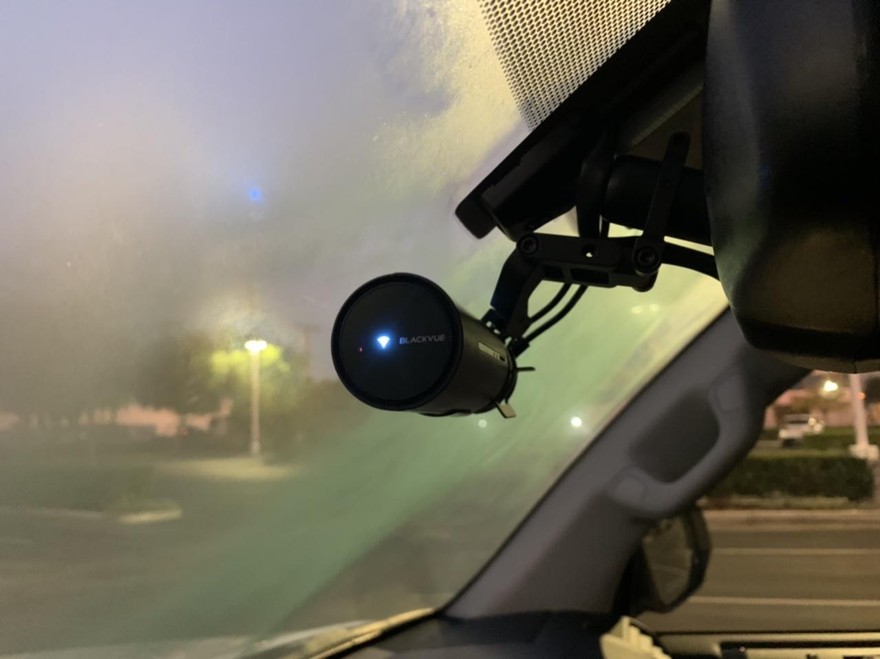

I used a Blendmount with my Blackvue DR900X. The rear is mounted a 3D printed mount someone on here made.
Edit: I just noticed you specifically said rear. I need more coffee.
