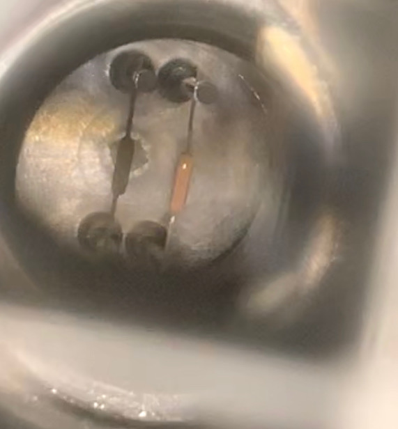

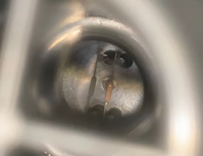

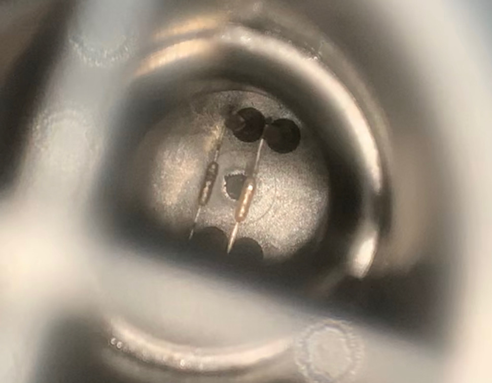

Jason B Official Vendor Feb 8, 2024 #1 96-98 4Runner maf is different than 99-02. Here are some pics after cleaning. Attachments IMG-8014.JPG 110.5 KB · Views: 946 IMG-8013.JPG 65.4 KB · Views: 923 IMG-8012.JPG 48.9 KB · Views: 919 Last edited: Feb 9, 2024
P phattyduck Elite Member Feb 8, 2024 #2 Looks good... The item on the right in the photo is the air temp sensor, and the much dirtier one is the hot wire that does the actual air flow sensing (the one that both gets dirtier AND is more important to be clean). -Charlie

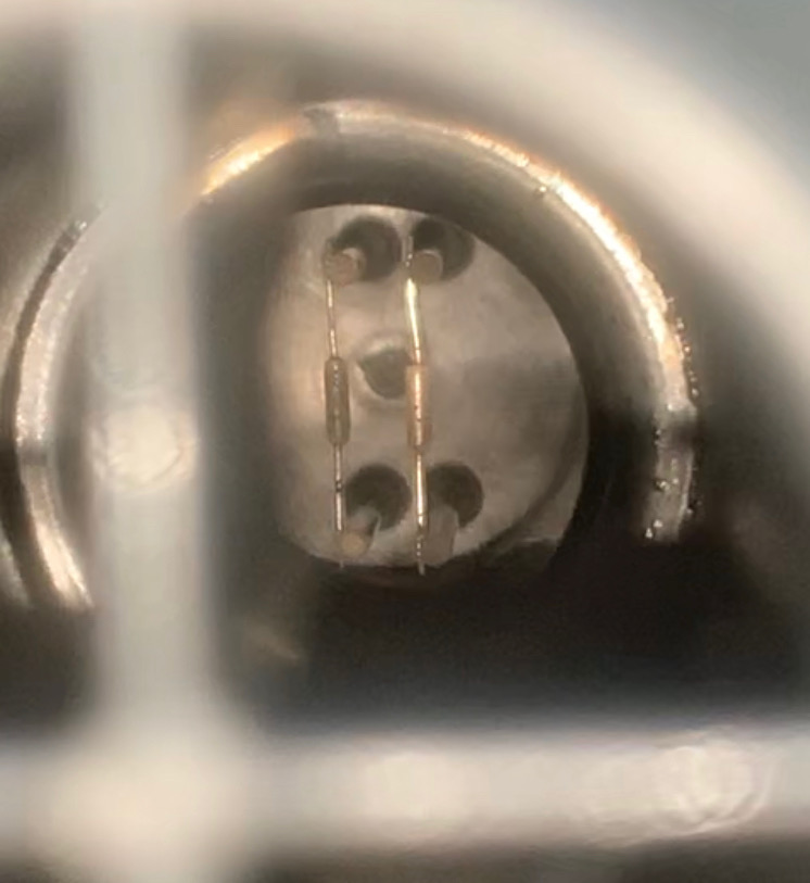

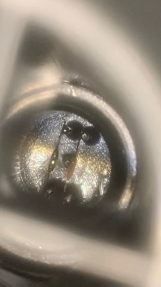

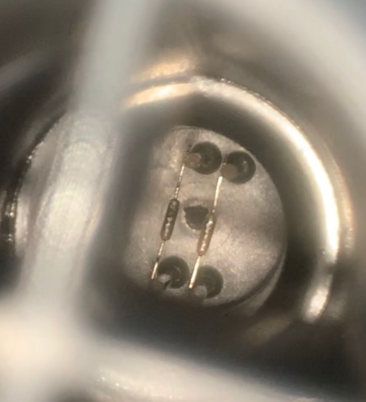

Jason B Official Vendor Feb 14, 2024 #3 I cleaned a 2nd time and got it a bit cleaner Attachments IMG-8066.JPG 83.2 KB · Views: 945 IMG-8064.JPG 83.7 KB · Views: 948 IMG-8065.JPG 102.4 KB · Views: 928
