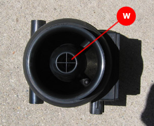

Yep. That's the stuff to use. Just did mine a week ago.
Hexane is extremely hydrophobic which makes it toxic and carcinogenic. Make sure you glove your hands when working with it and don't inhale the vapors. Don't pu$$yfoot around with the spray. Put the MAF on a piece of cloth you will toss and go full blast. The pressure alone will push most of the dirt off.
Be sure to blast the two wires, the inside of the ring and INSIDE of the tube.
Great results. Haven't done this in over 30,000 miles. Power and MPG went up.

Do not use electrical contact cleaner. Use ONLY mass air flow cleaner or brake kleen since both evaporate and dry clean and fast. Any kind of residue will screw with the sensor
you are severely mistaken. brake kleen will leave a residue, not CONTACT cleaner
we used contact/circuit board cleaner all the time at the dealership to clean the MAF

There really isn't a wrong or right way to clean it. Remove it, spray it generously, allow it to dry, re-install.

Stripping the screws is very easy. I used a dremel to cut a groove and got them out. I then found the best replacement at Home Depot
Part number 30699-82558 4mmx10mm cap screw with socket head
I can now use a hex wrench and never strip them again.

Thank you for the threads; I clean up my sister's truck today. MAF was trowing codes P0171 and P0420. Here is some of the data from the freeze data:
Frame 1 Mod#1
P0171
rpm: 2140 Load=41.5% temp=194F intake temp=51F speed=43mph
fuel system 1=CLSD fuel system 2=n/a
short term fuel trim1=0.7%
long term fuel trim1=37.5%
short term fuel trim2=-100.6%
long term fuel trim2=-100.6%
Clean it up the MAF, truck passed NJ inspection.Light came back after leaving inspection station. I failed to clean the two wires completely. The two wires were covered by dirt and now are silver, pvc was old and stuck open, intake was covered by crude. Air filter was clogged.
Hope this will help someone, thank God truck is Ok now.:wink2:

with a K&N CAI all you have to do is take off this and spray in the hole and around the assembly... super easy
I was shocked at how smooth and how much more power I had after doing this...
