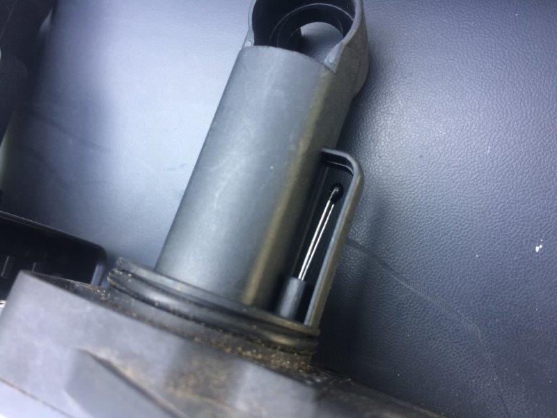

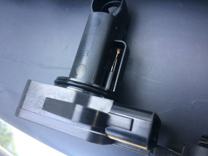

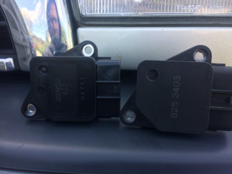

I've been getting an intermittent P0110 - Intake Air Temp. Circuit Malfunction error on my 2000 4runner. Cleaned my MAF a couple times but didn't seem to help. Gas mileage has gone down about 10-15%. Decided to buy a Denso part from Amazon and during the instal I snapped a couple photos of the (apparently) 3rd party sensor that was installed in my 4runner and compared it to the new Denso unit. The physical difference is obvious. Hopefully it fixes my error problems and mileage.
You can't see it well in the photo, but the Denso unit, in addition to the larger bulb (which I think is more similar to the OEM toyota Denso unit), has flat wires going to the sensor bulb. Couldn't be bothered to bust out a magnifying glass to check out the other wires in the tube.
Denso part number: 1976020 (197-6020)
