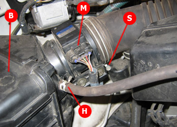

I used both the drop in and CAI. I used to run them in all my vehicles. Not no more. What part is that? I don't recall seeing that on mine...
thats a shame, I get so much more hp and torque from the K&N,
the part you are asking about is labeled "M" in this pic, its all thats left of the mass air flow stuff when you remove the stock airbox.
pretty much that whole piece between the tube and the box.
