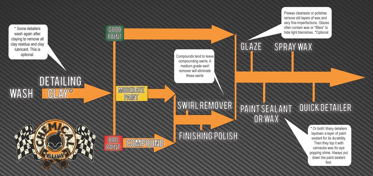

Detailing Flowchart
This was on the Chemical Guys site so I figured I'd post it to help people out. In all reality most of us are just going to wash, wax and/or seal (hopefully), and put on some dressing (maybe).

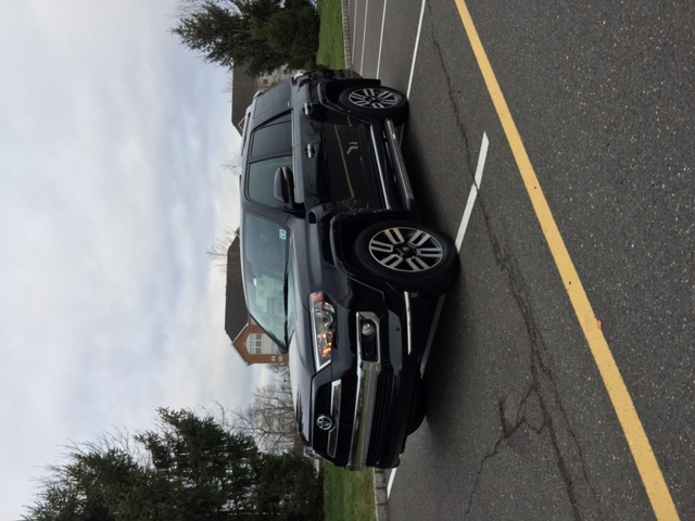

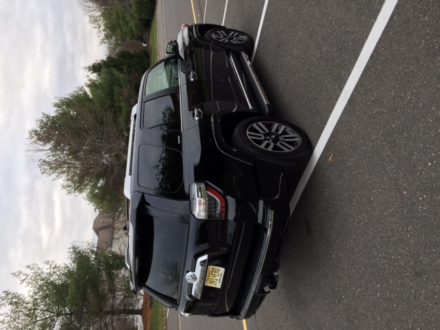

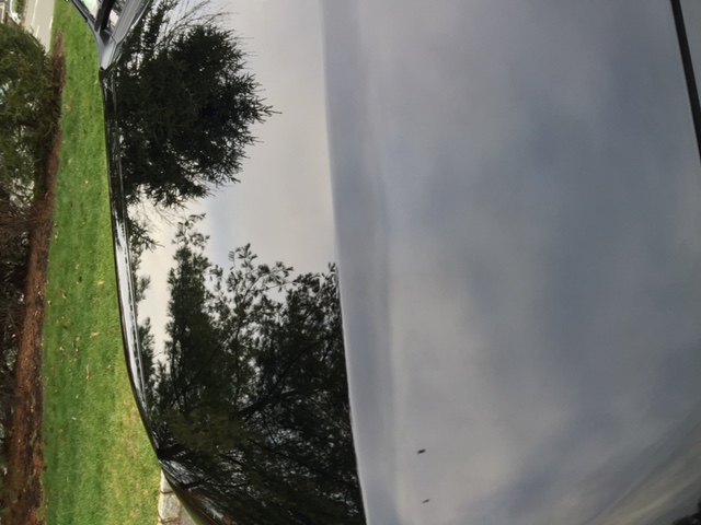

Just finished wash+clay+Klasse AIO+2 coats of carnuba for that deep sparkle. Here's a few shots.
