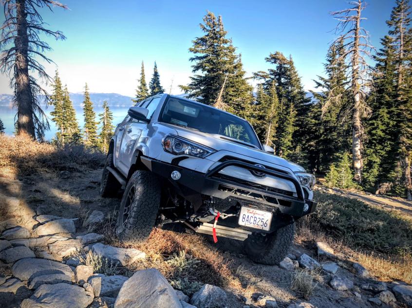

Hi guys, after doing a moderate trail I started hearing a loud click, or sometimes two clicks in succession, when I turn my steering wheel.
It doesn’t happen every time I turn, but it happens maybe a fourth of the time. It happens when I turn to one side more often than the other. It kind of sounds like there is some tension that is released. I can be turning the wheel without the car going forward or reverse and it'll still happen.
It doesn't happen with each wheel revolution, just with extreme wheel turning to the left/right.
This weekend I spent a few hours retightening up the suspension bolts to spec on the left side, and it didn’t make a difference. I did install my own suspension so I was worried something may have loosened. I didn’t get to the right side so I’ll try that next but I didn't think the sound was coming from the right.
The CV and tie rod boots all looked intact but I worry that maybe something inside is broken. I did put my car into a large flex situation on the trail, but I drive pretty slow and carefully so I’ll be surprised if it was damaged.
Any ideas? Thanks in advance.
