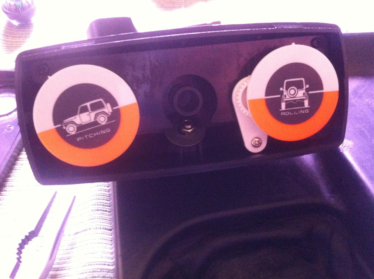

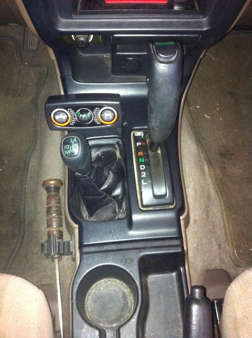

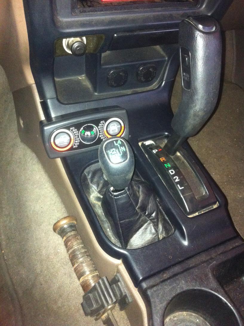

Step 1: Find your location. It comes with a bulky mounting pad with sticky tape but I wanted more a stock look. I originally wanted to mount it under the temp gauge/above the rear locker switch. This location provided good visibility, but when I removed the mounting surface that location would have required more drilling to make work. I played around with different spots and ended up on the center counsel for easy of installation and it looked clean down there.

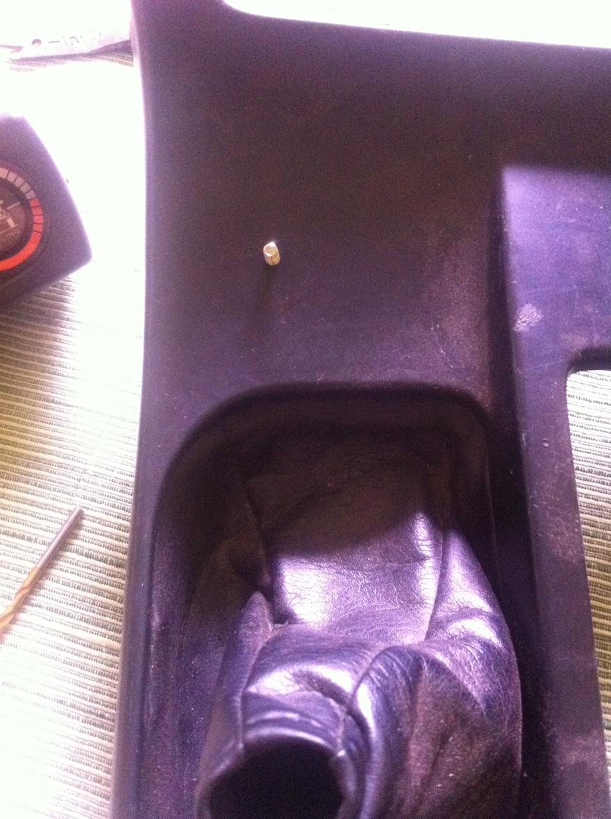

Step 2: With your truck on level ground, find the area where both pitch and roll are centered and mark. Drill the hole using a 1/8th drill bit.

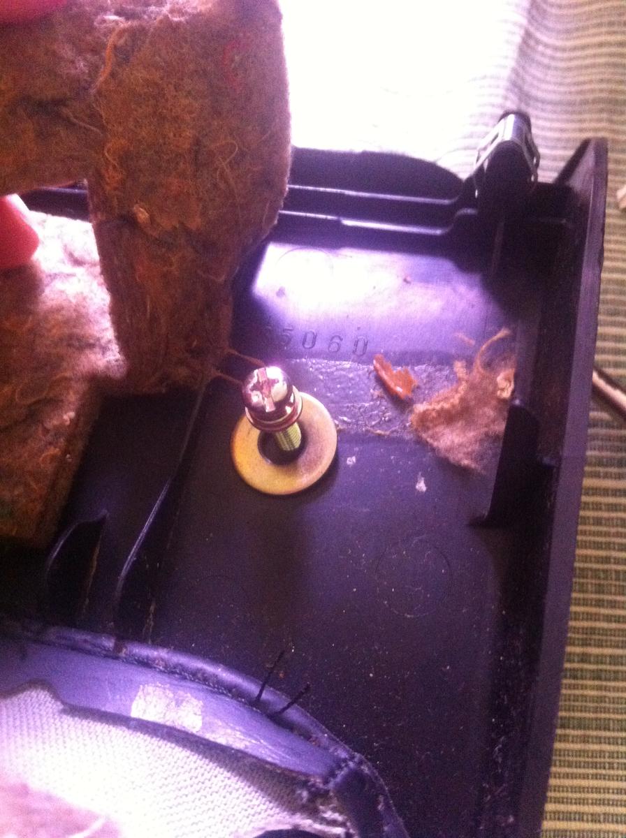

Step 3: When I removed the mounting pad the little nut on the inside came out of its location. The front of the clinometer pops right off. Make sure your on carpet because when it came apart my compass when flying. I had to add a washer to the back side of the plastic counsel and inside the clinometer to get it to secure. You can see that in the pictures.
Step 4: Simply tighten down and reinstall the plastic center counsel.
Don't mind the dust/dirt. I have been out off-roading a lot lately which is great! If you have something similar show it off here! I would like to see the other set ups. I would recommend things if you just want a fun, personal gadget for your vehicle. Its a great cheap way to cure the mod bug. I also ordered 300 ft of green (my 4Runner is Imperial Jade) para-cord to make some handles with.
Total time: 30 minutes.

Looks good, I like that location. I've always wanted to get more guages down there, I've tried to suction cup my Ultraguage down there but it doesn't stay... I like the knife/mount!
