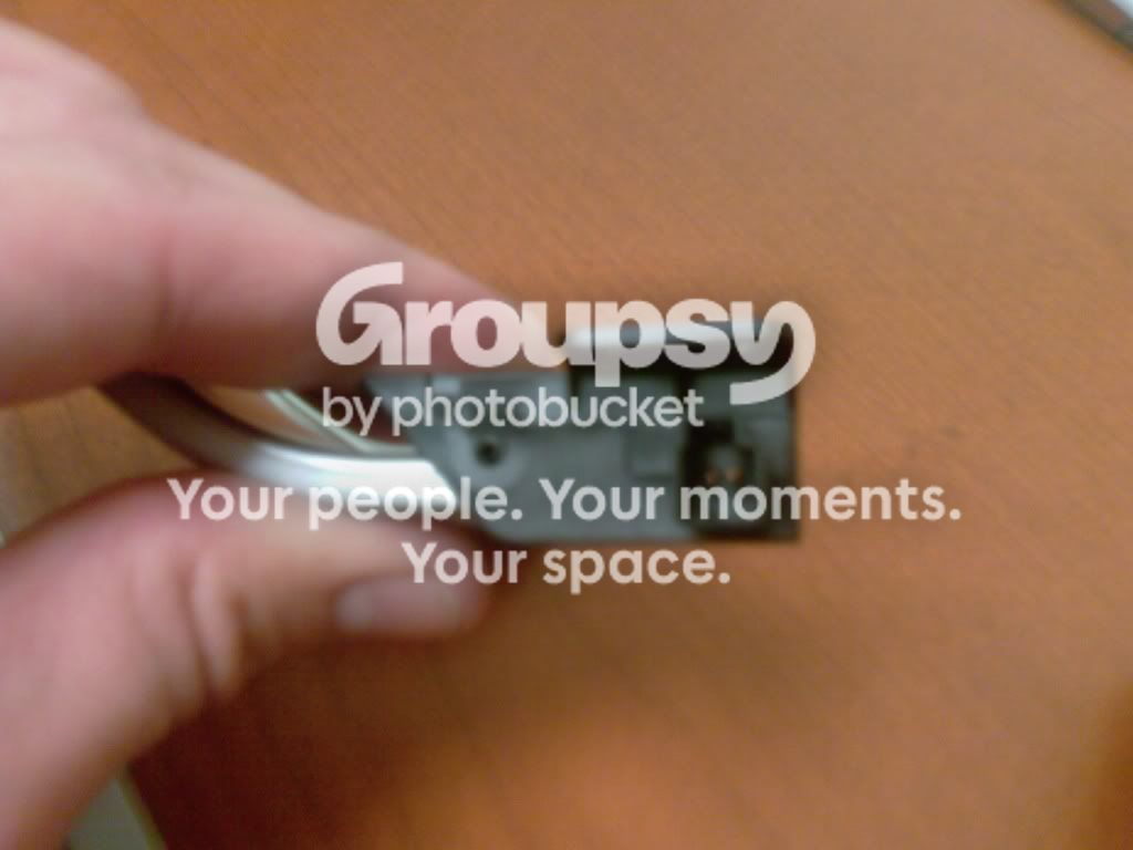

this just reminded me to get the wire ends from this 4runner in the junk yard. I got a bunch of stuff planned out on how to make a paddle shift setup but just wanted a better plug and play system. I can check around a couple other cars that might have the same plug if you want one.

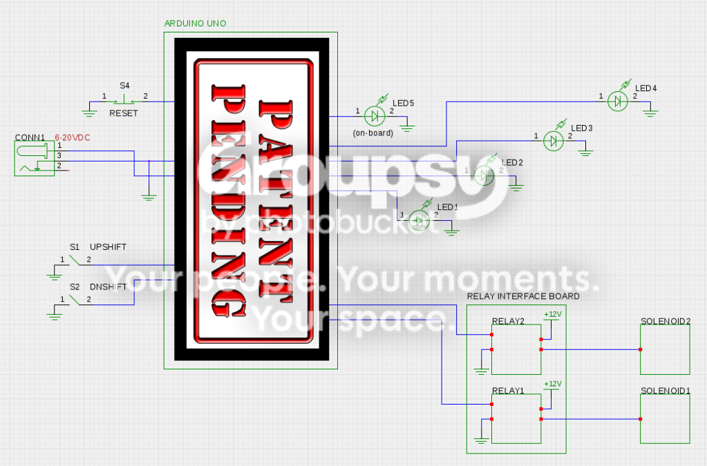

After talking with my collaborator over the last week looks like this project is going to happen. Paddles showed up today and he emailed me the first blueprint for the control box. Needs to be built and tested, just need time, which is in short supply.
The program came to about 150 lines of code and a total of 2496 bytes, pretty small. This will run the shift solenoids, calculate paddle input, and run different colored LED's on a gear indicator to show you what gear you are in.

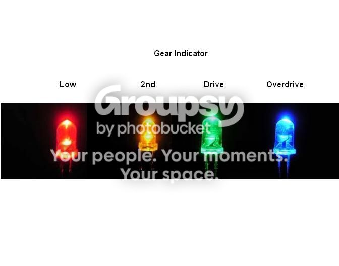

Colors I chose for the LED's in the gear indicator that will probably go somewhere on top of the steering column or inside the cluster somewhere.
gearindicator.jpg~original
I think a good place for them would be in the instrument cluster. Since yours is a 98 I think a good spot would be where the warning lights are at on the bottom, there is a empty black space of plastic. It would be cool too if you were able to have some sort of face over the LEDs that would say 1, 2, 3, 4 or something similiar so it's says what gear you are in over just remembering a color.
