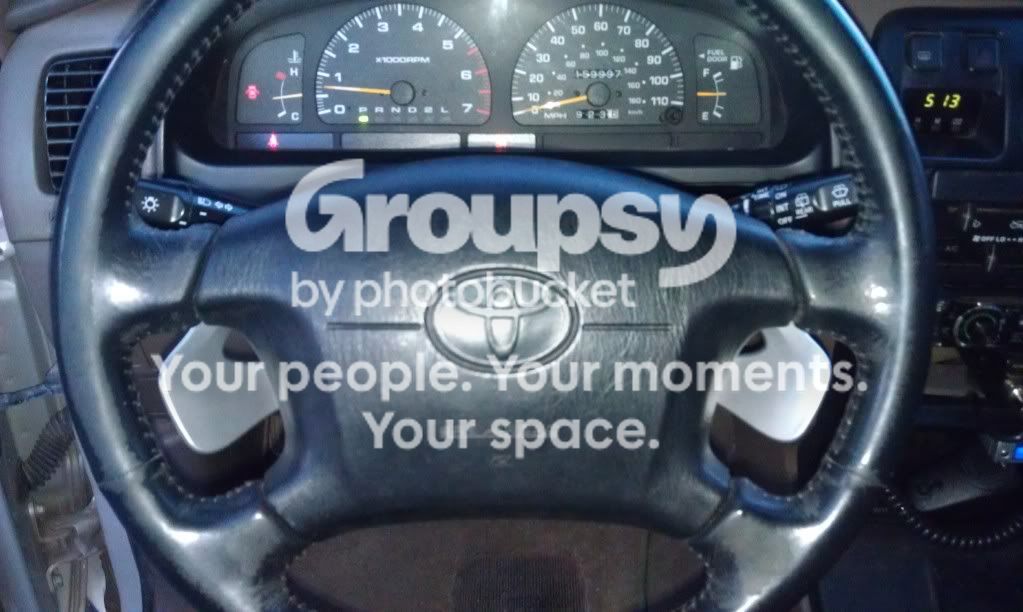

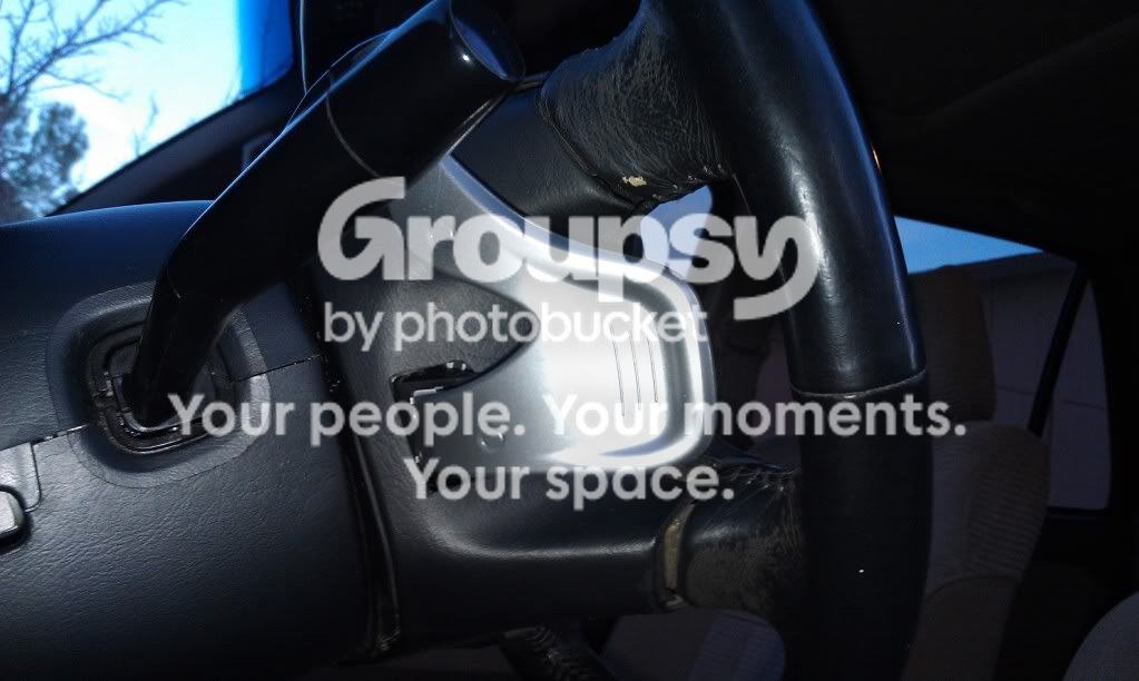

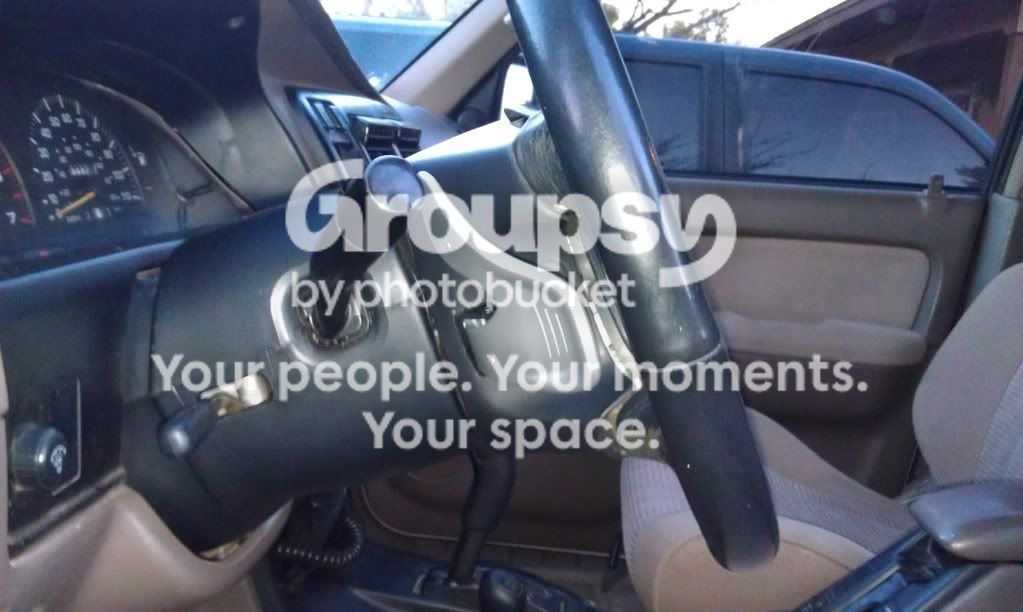

Came across this video today, same concept this guy had about 5 years ago. Mine will use paddles and less cardboard.
<object style="height: 390px; width: 640px"><param name="movie" value="http://www.youtube.com/v/arfZ09zO8qY?version=3&feature=player_detailpage"><param name="allowFullScreen" value="true"><param name="allowScriptAccess" value="always"><embed src="http://www.youtube.com/v/arfZ09zO8qY?version=3&feature=player_detailpage" type="application/x-shockwave-flash" allowfullscreen="true" allowScriptAccess="always" width="640" height="360"></object>
Cardboard is a nice nonconductive material for a base of an electronic circuit, just doesn't do it for me I guess, lol.

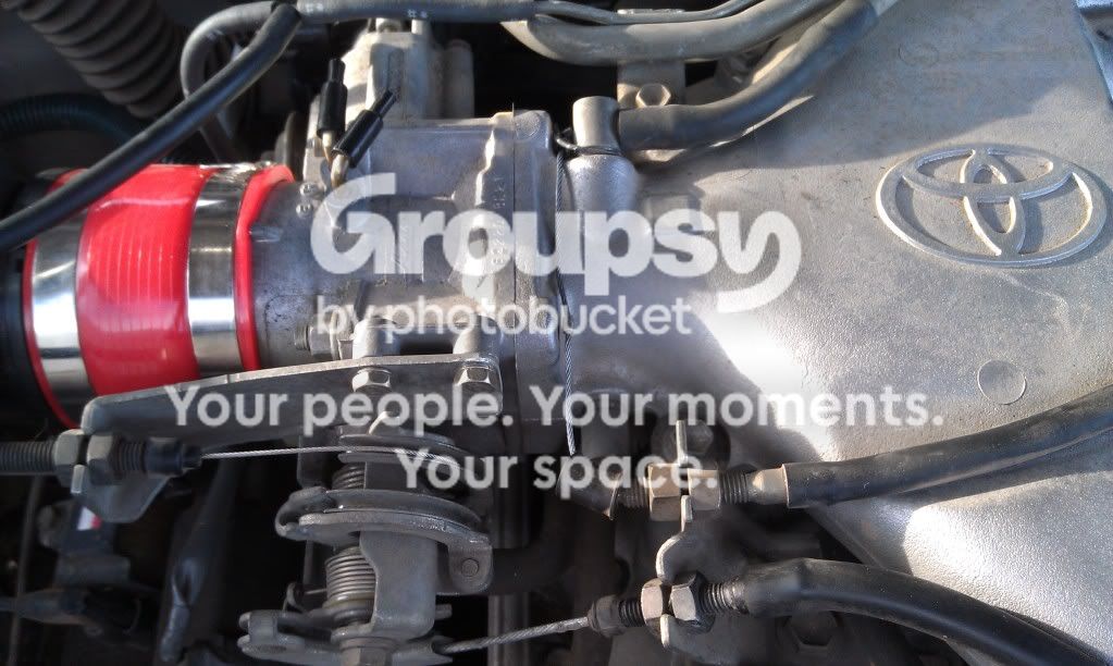

Poor mans shift kit, pulled the throttle pressure cable out all the way and tied it down. Nice snappy shifts all the time now.
IMAG0004.jpg~original

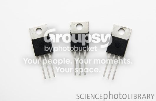

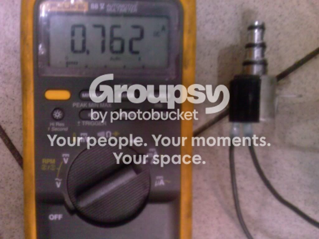

So instead of using regular relays to trigger the solenoids, FET's (field effect transistors) will be used, I believe MOSFET type.
BLOWERMOTORCONTROLPROJECT011.jpg~original

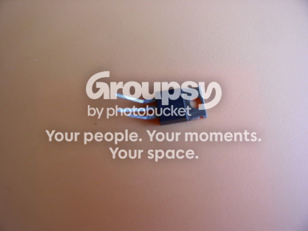

Looks like FET's (field effect transistors) will be used. So no additional clunky automotive style relays to be wired with moving parts and clicky noises. The amp load from the solenoids is pretty low about 750mA, so probably MOSFET style, doing this will keep size down too since they can be integrated into the control unit.
mosfet.jpg~original
