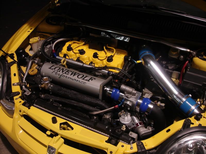

x2. Lol, why'd you have to go and get a turbo 4runner on my brain? This is one of the other vehicles in the garage.....
BumbleBeeDone019.jpg~original

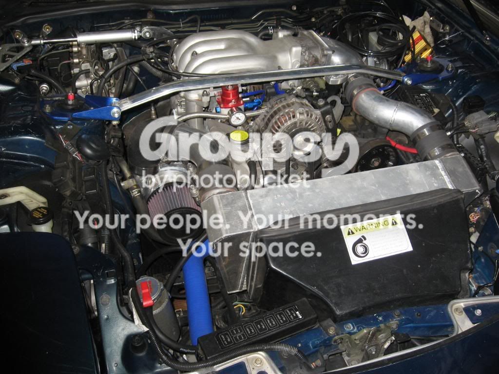

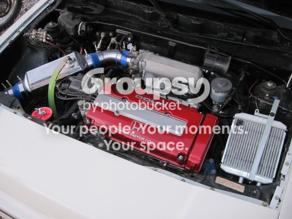

I'll put a turbo on everything if I can!
