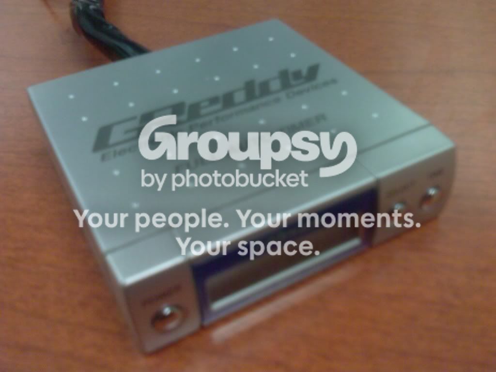

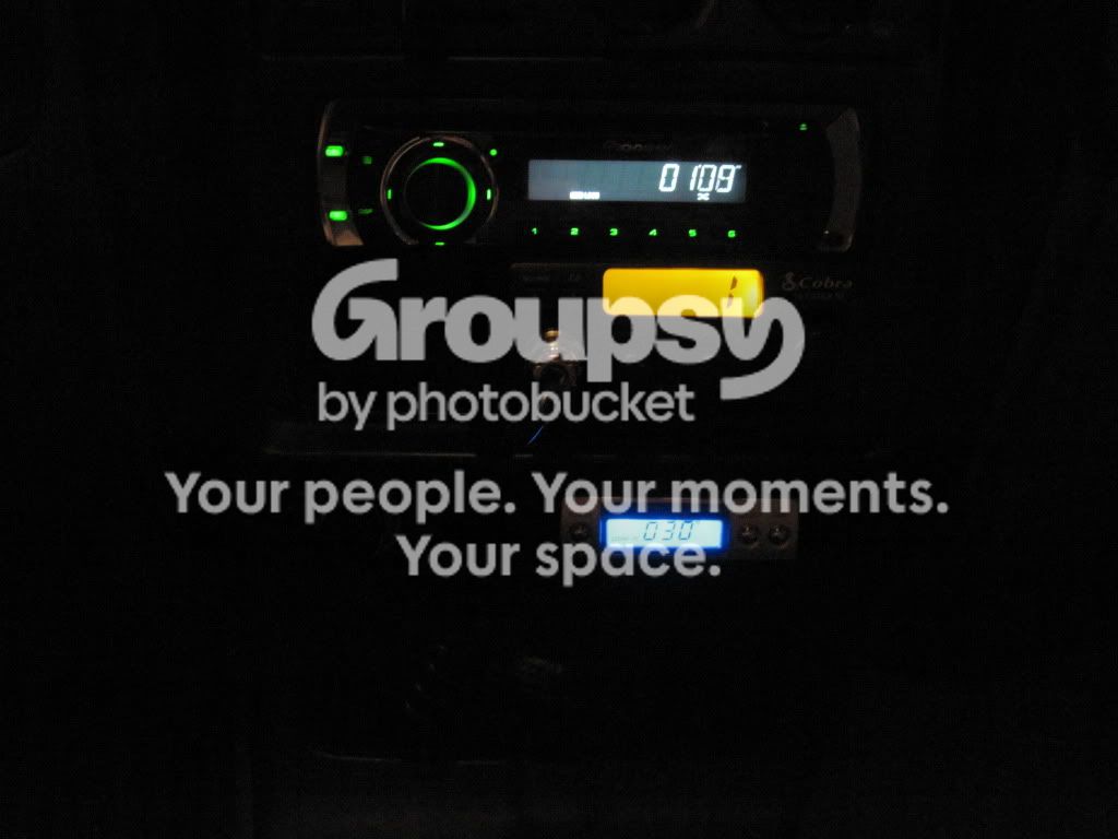

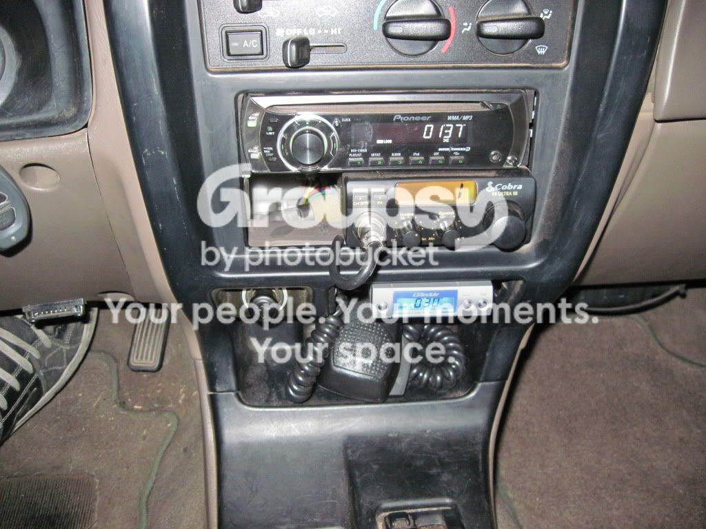

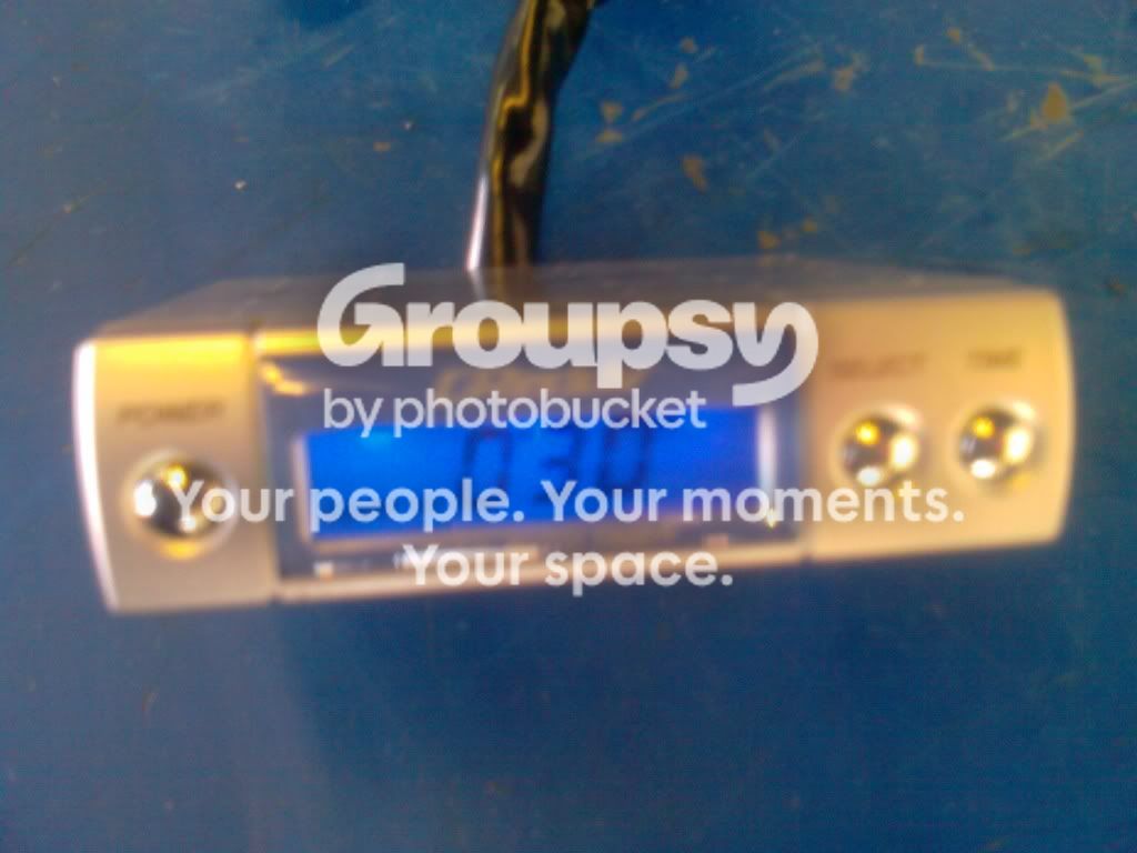

Going to put my turbo timer in today to run the scavenge pump for a minute after I shut the truck off so I dont get oil draining back into the turbo.
