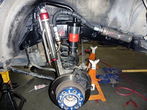

I found this only pic.Is this what you are thinking of? How much is this going to help? other than making it easier to remove the shock...
Installing my rear shocks made me want to give up installing my lift...lol
Funny you found that too. I talked with this guy "Chappy Steve" and am going to do something similar without the bumps stops though.
