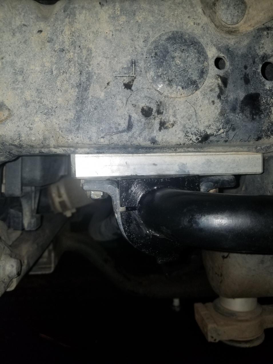

After jacking up my 4R & checking all components + searching other related threads - I'm hoping it could be 1 of 2 things. Either my UCA's need a serious amount of greasing (although would the UCA needing grease cause a 'knocking' sound? Or would that be more of a creak/squeek :shrug:). OR could this be due to my new sway bar bushing with a little gap in it?? I don't see how the bushing would cause such a knocking sound either though because it's super snug in the bracket & loaded with fresh grease.
These bushings are the 29mm polyurethane bushings by Whiteline (the ones that are recomended for our 5th gens). I don't really want to go back to the OEM ones, but I guess I can do that to help diagnose this issue & see if the clunk goes away. BUT what other size (in mm's) would I get for this sway bar because I want the poly ones?? Anyones else go 30mm, 31mm, 32mm, etc...?? Here's a pic of the gap for reference:
Thanks!!!
*EDIT: this pic was the driver side sway bar bracket. If only I would have concentrated on the passenger side to begin with.... :redbrick:

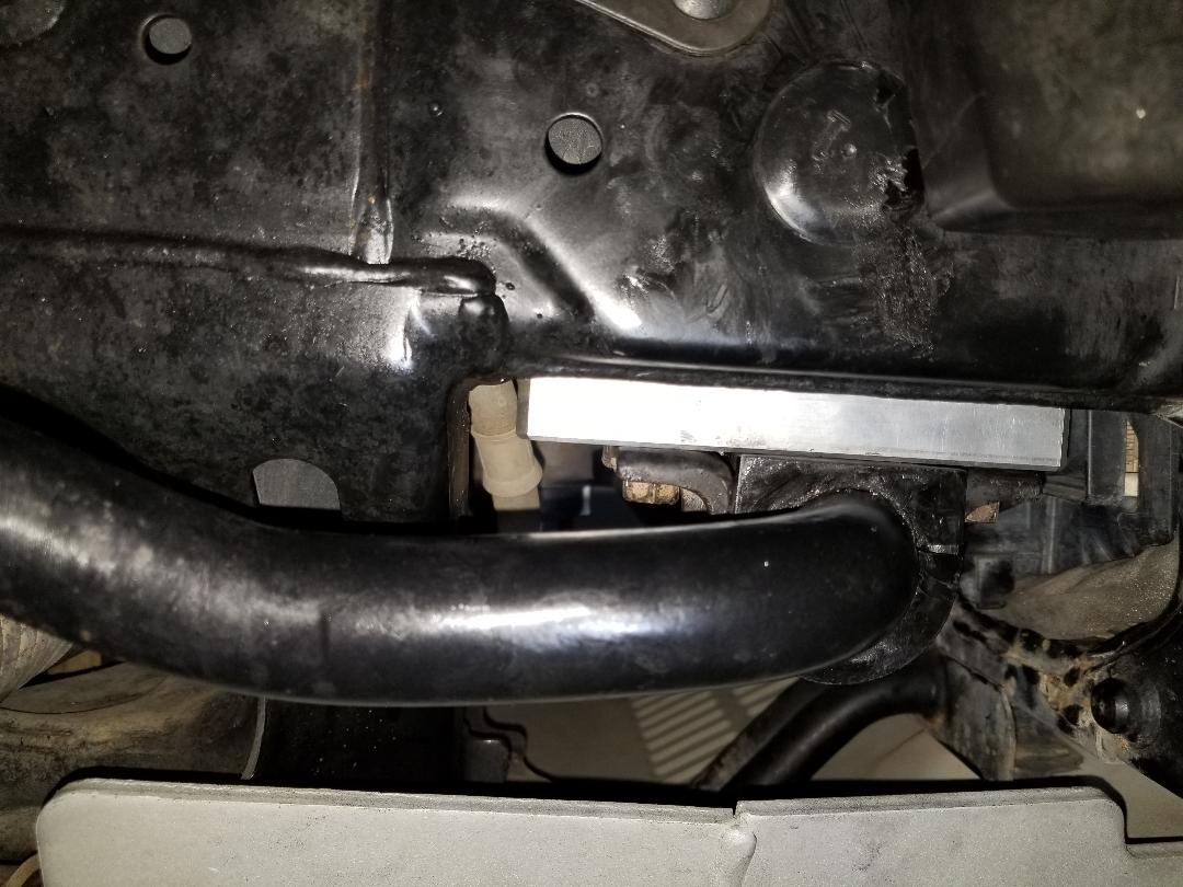

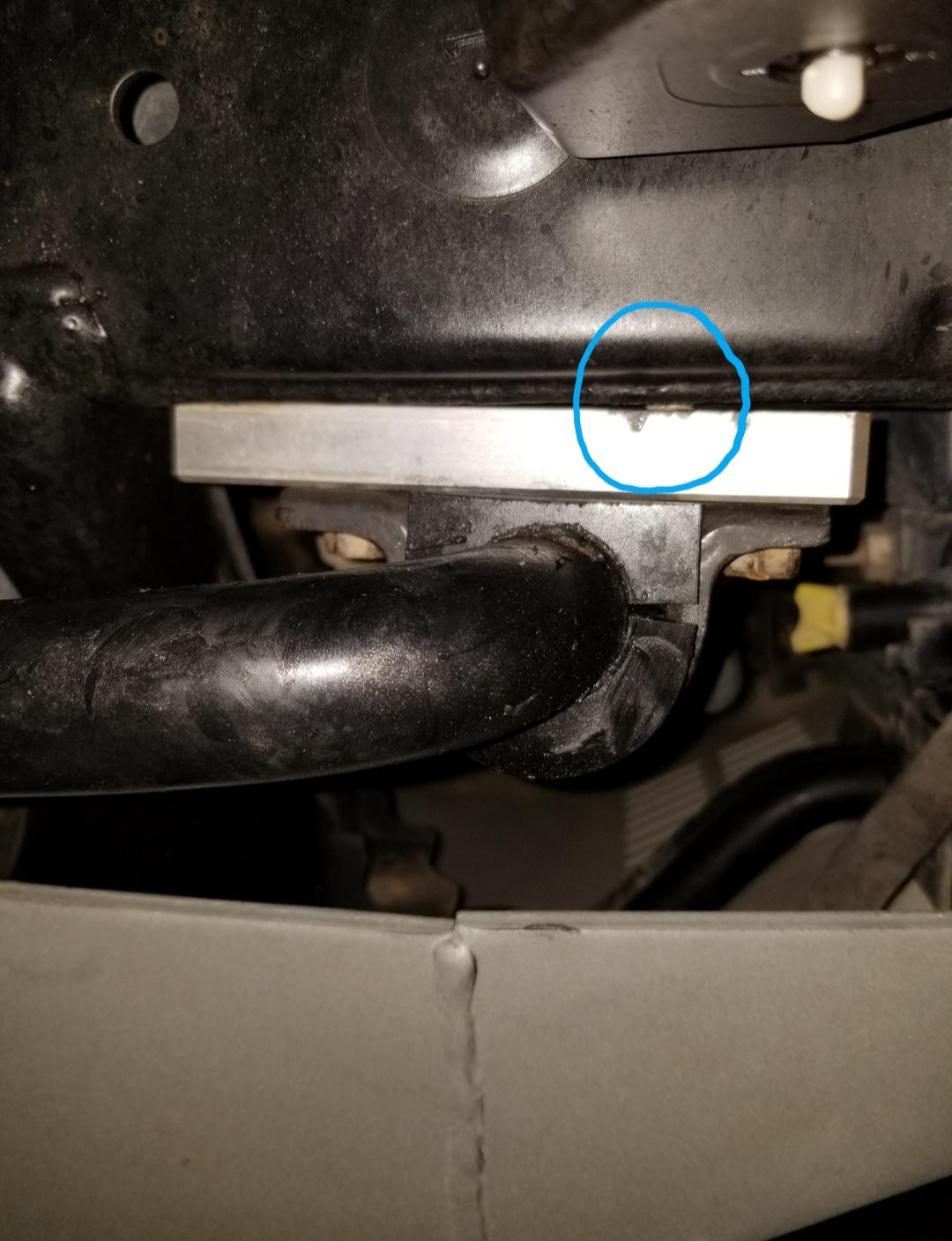

Sway bar def doesn't hit the skid & the sway bar is good & away from the coil & links due to the sway bar relocation kit. BUT that relocation kit was the problem!! After removing the wheel to inspect tie rod ends thinking that could be the prob...nope, thing was super tight and has a lot of life in it - when (super frustrated) about to put the wheel back on, I noticed the spacer used to relocate the sway bar had a little gap at one end & I could even see the bolt in between the frame & spacer!!
*I have circled this in blue in the picture below.
After removing the skid to get to the sway bar bracket/relocation kit easier, I noticed that the problem bolt wasn't tight at all. In fact, while trying to remove it - it would not even spin out!! Turns out the threaded "nut" within the frame broke out of its tacweld or whatever Toyota uses to secure it. I had to pry off the frame plug (also shown in the second picture where the relocation kit/bracket is now fixed) - & stick my finger in the frame to secure the loose nut to get a solid torque on it. Now that it's tight I'm wondering just how long it's going to last :confused: BUT it seems super tight now & I made sure to lather it in red loctite.
The clunk is now completely 100% gone :clap2::clap2:. But for how long... Even closed up a little bit of the gap I have on that polyurethane sway bar bushing. For anyone paying attention, I ordered the 29mm bushing as recommended by Whiteline. Measured the sway bar today with my new digital caliper & it reads 30.5mm. Not going to stress the gap for now.
