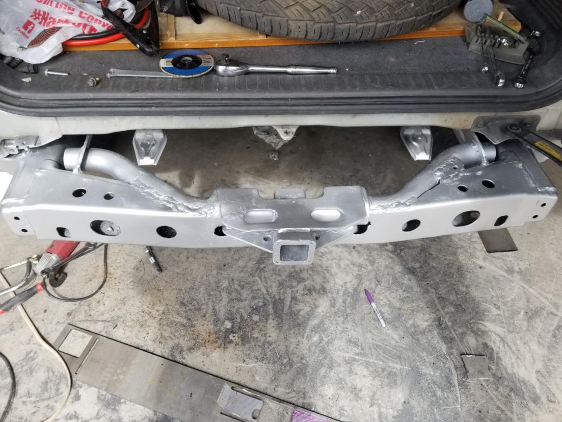

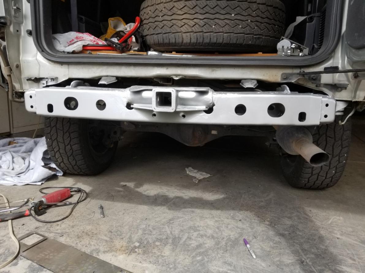

My 2005 GX470 is almost identical to the 4Runner, but the rear crossmember is really in the way - I took the unusual step of cutting off the top of the crossmember and welding in the factory hitch, so that it wouldn't hang down below the bumper. Ugly welding (my first project) but it works.

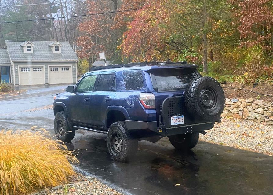

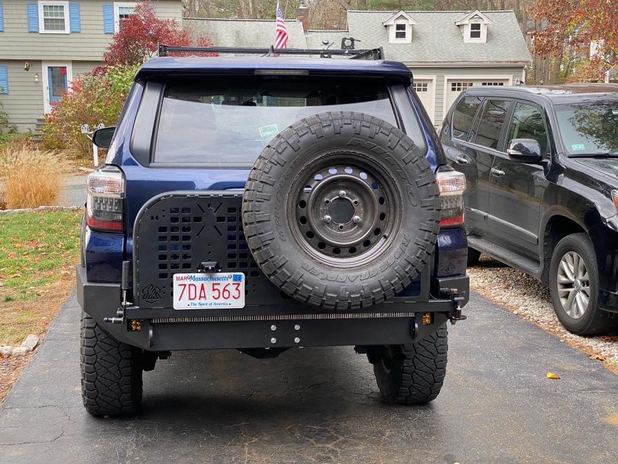

Nice build. Is that the way the hoops are supposed to be installed?
That would explain why these stick out so far..
Also this is the full height setup. My plastic was too beat up to use, and as you can see there are pod light holes in this one.

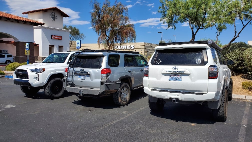

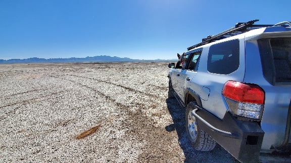

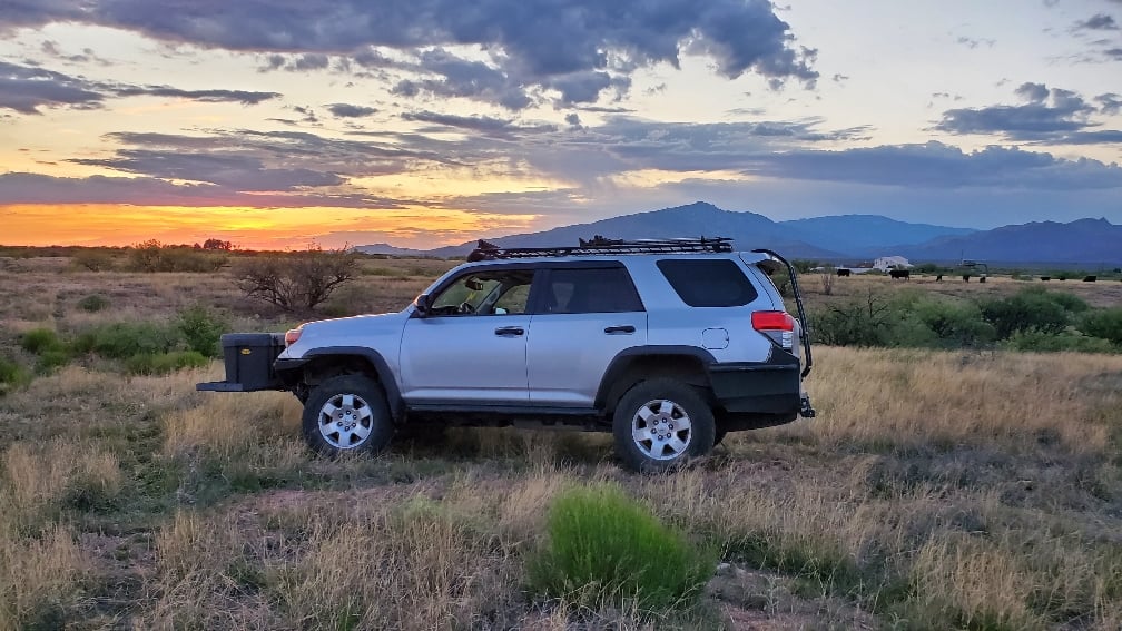

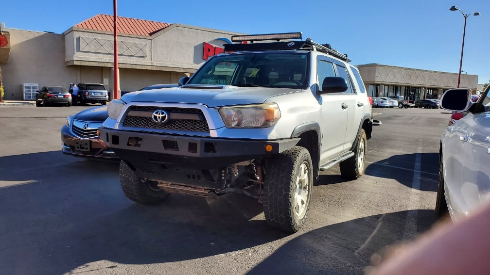

For anyone still wondering - on my '11 Trail Edition I tried mounting the factory hitch receiver back on over the bumper. Close, but doesn't quite fit. I removed the steel on the underside of the bumper and left the rear face and then could fit the receiver. My camping trailer is around 2500# and I didn't want to wonder about their receiver kit. In fact, I installed the receiver tube into my front Coastal bumper so that I can put a cargo carrier up there. A front receiver is surprisingly handy, and I can build modular attachments to go up there if need be, such as a pole/carrier for extended lumber or steel on the roof.
I guess I don't have any good pictures of the receiver installed on the rear(and no swingout carrier), but here is me parked between two beautiful mall crawlers.
Sent from my SM-N975U using Tapatalk
I have only seen them on two other bumper kits, and they were mounted like I did mine. Here is one my friend Nick from NTK FabWorks did on a GX470 recently.
