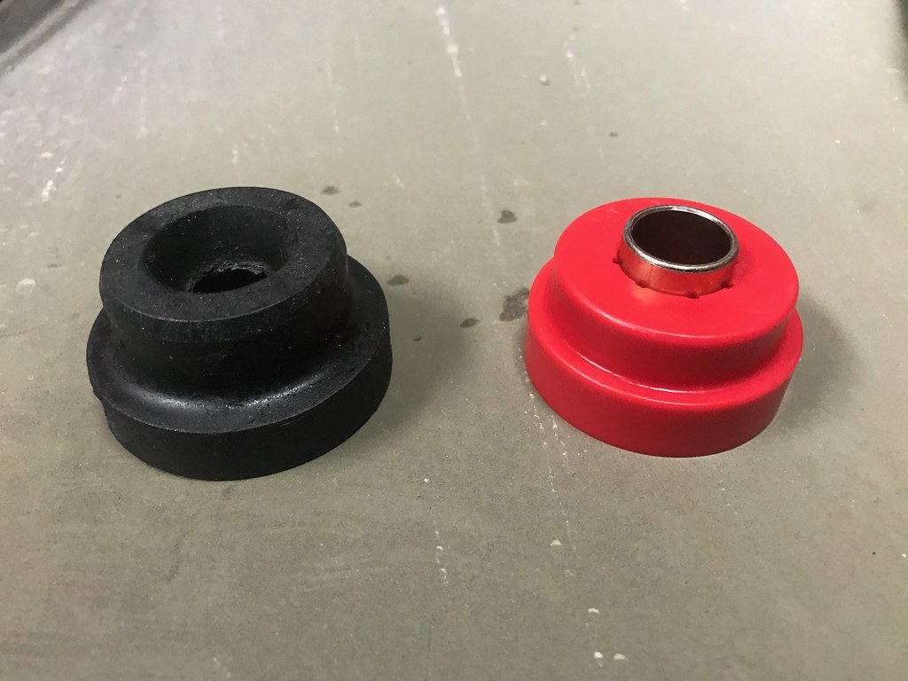

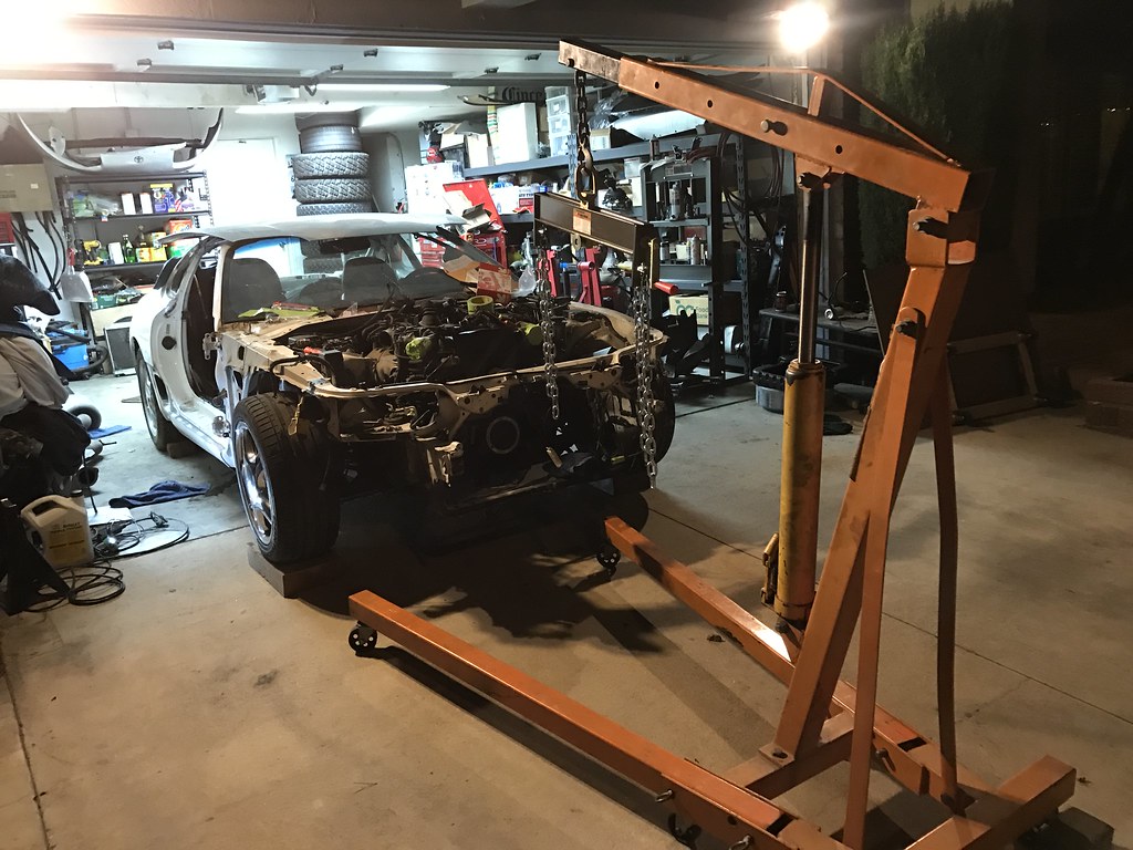

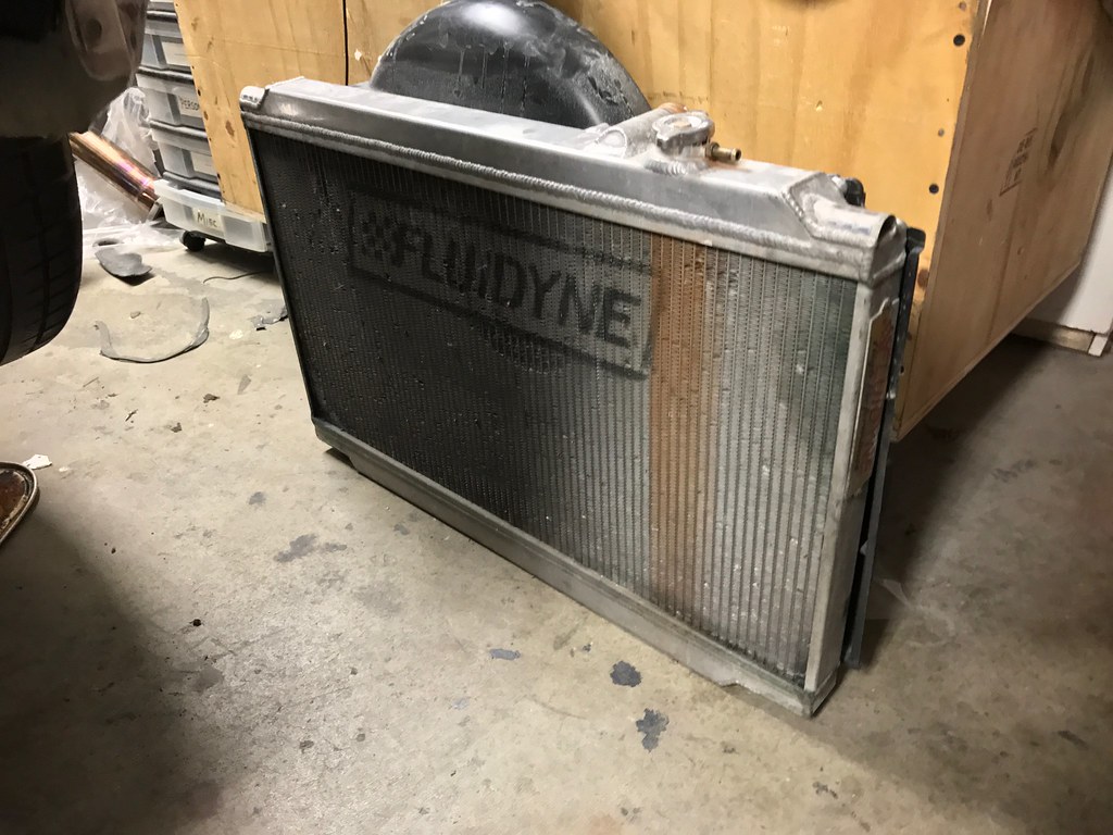

I sourced a couple polyurethane bushings that fit the radiator mounts very nicely, using a medium durometer material that allows for some vibration dampening. The inner diameter is not the right size, but a couple short metal sleeves fixed that issue. There’s even a few grooves on the ID of the bushings for lubrication. I’m going to have to clean the radiator up really nice and maybe even a bit of solder/weld work on a couple spots. It does its job rather well, so repair is worth saving the money I’d have used on a new aluminum radiator. Perhaps it may be replaced with a better unit in the future, as the AC fan mounting is not accurately positioned.

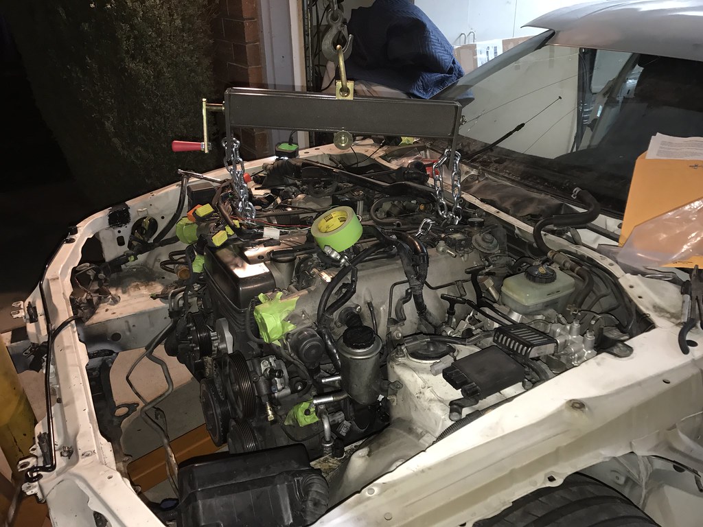

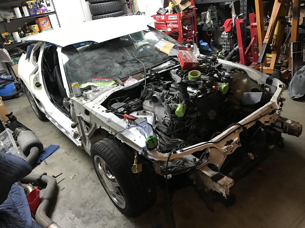

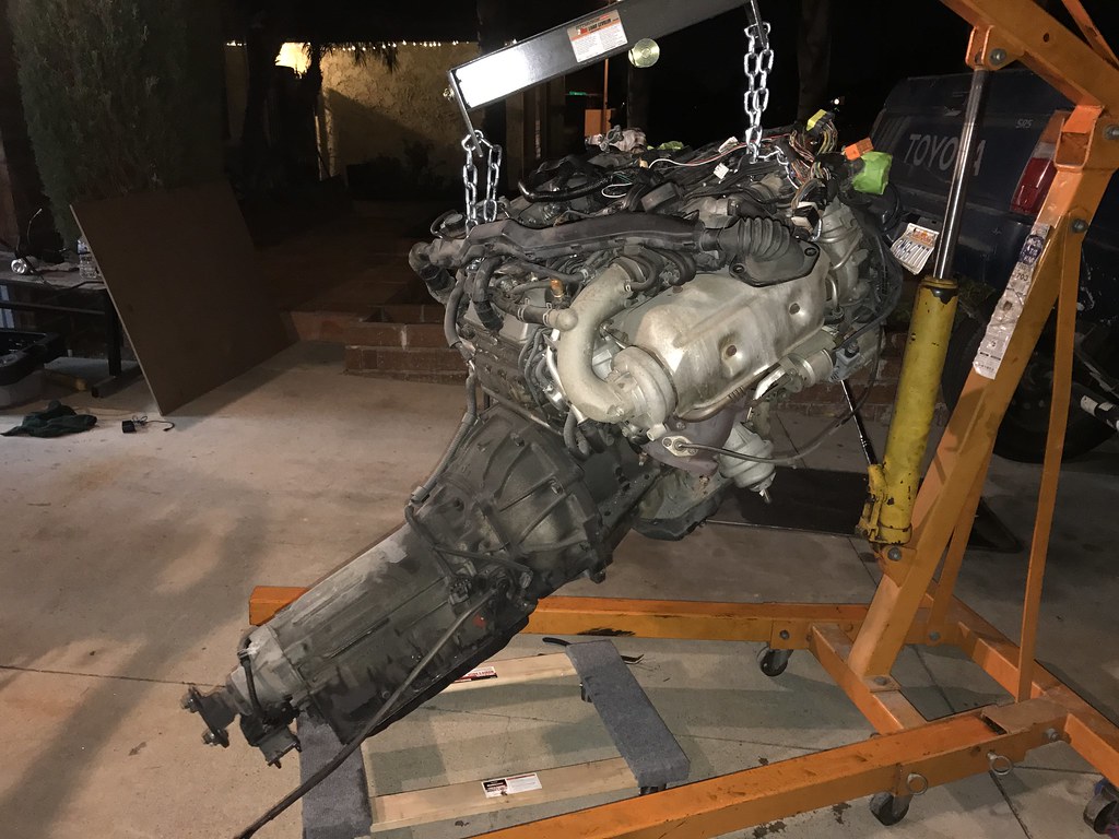

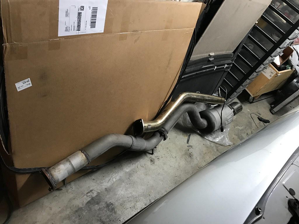

Megan downpipe and HKS Super Drager catback removed. Polyurethane exhaust hangers are also going in to reduce movement near the exhaust tip, in an effort to prevent contact with the rear bumper. The Megan downpipe is angled poorly and brings the exhaust down too low, thus I may be considering modifying it with a pie cut to straighten things out. I plan to go single turbo in a year or two, that would be a great time to get a higher quality downpipe.

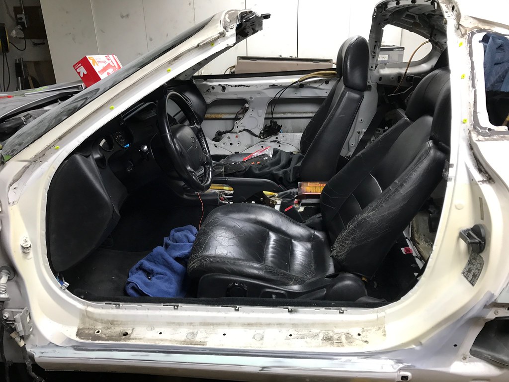

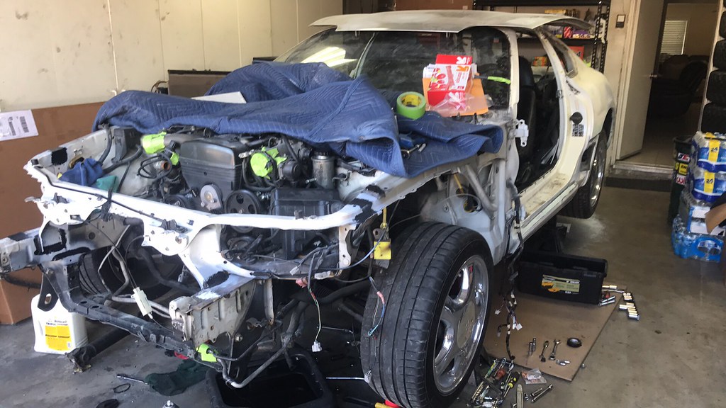

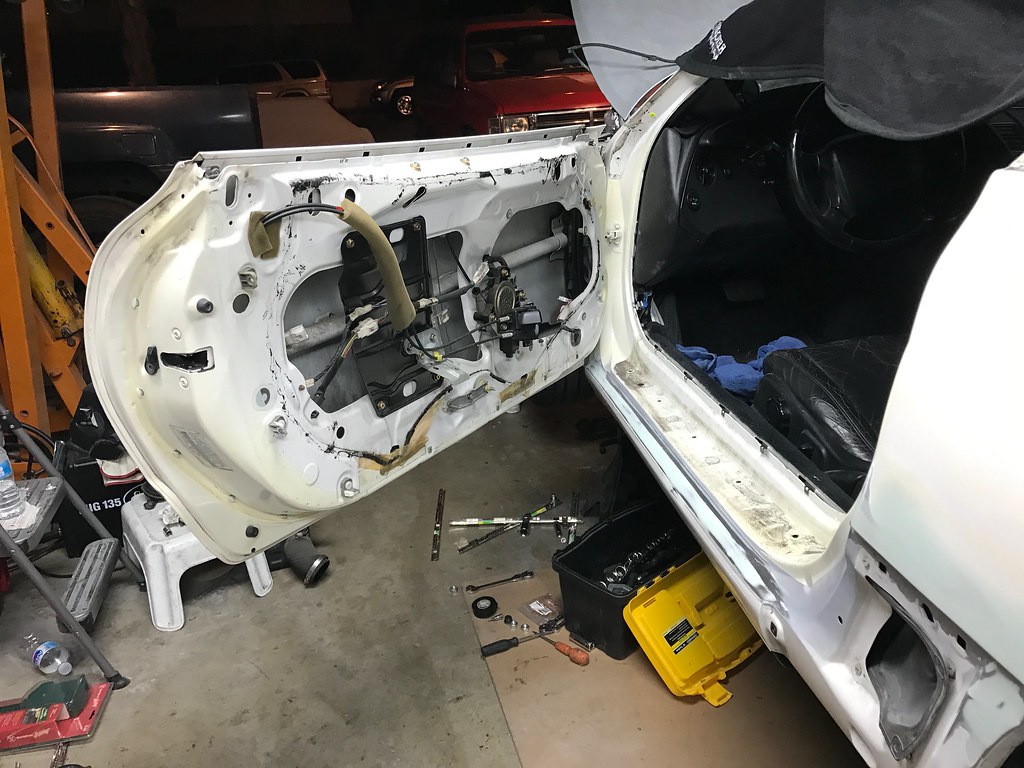

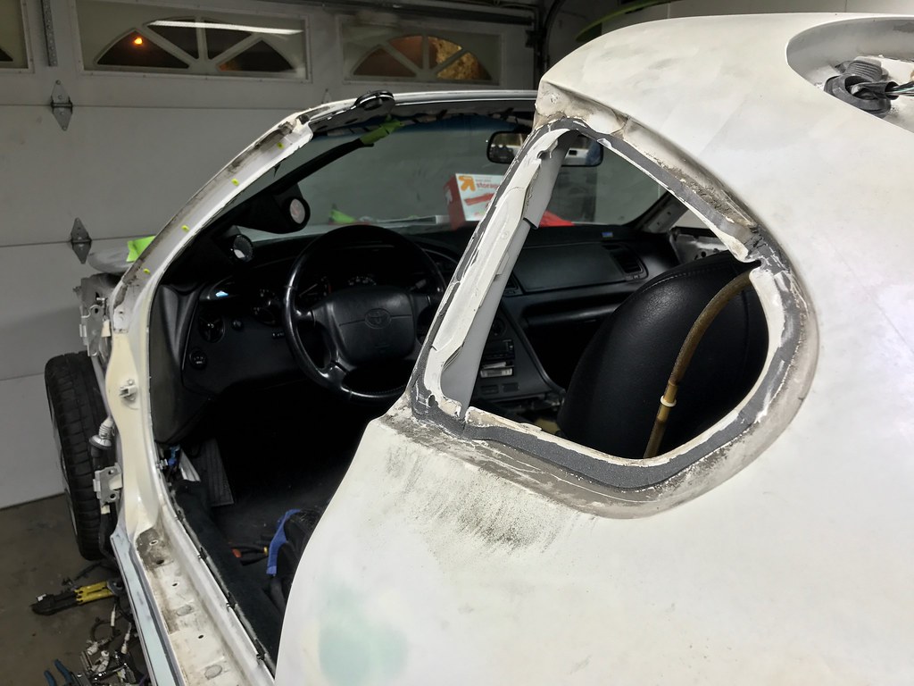

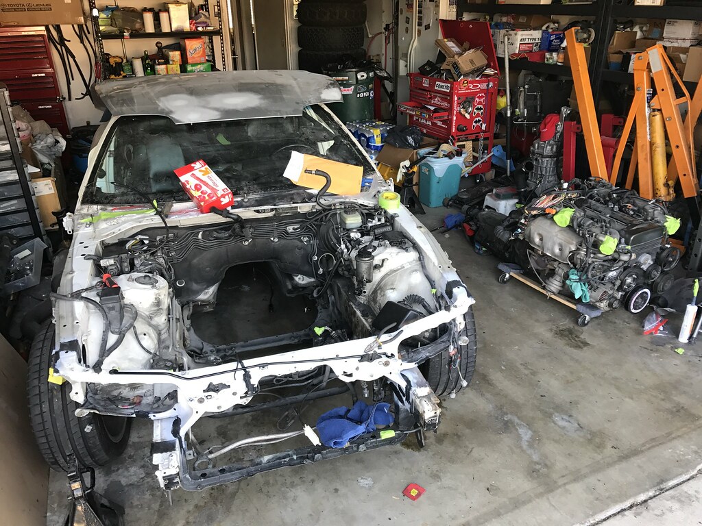

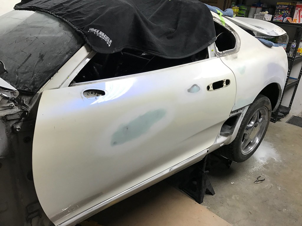

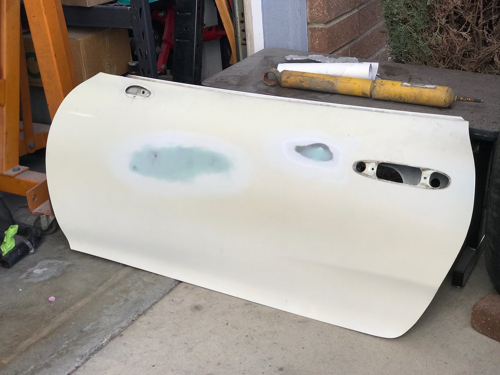

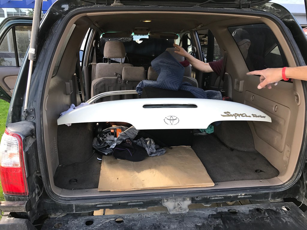

Doors coming apart.

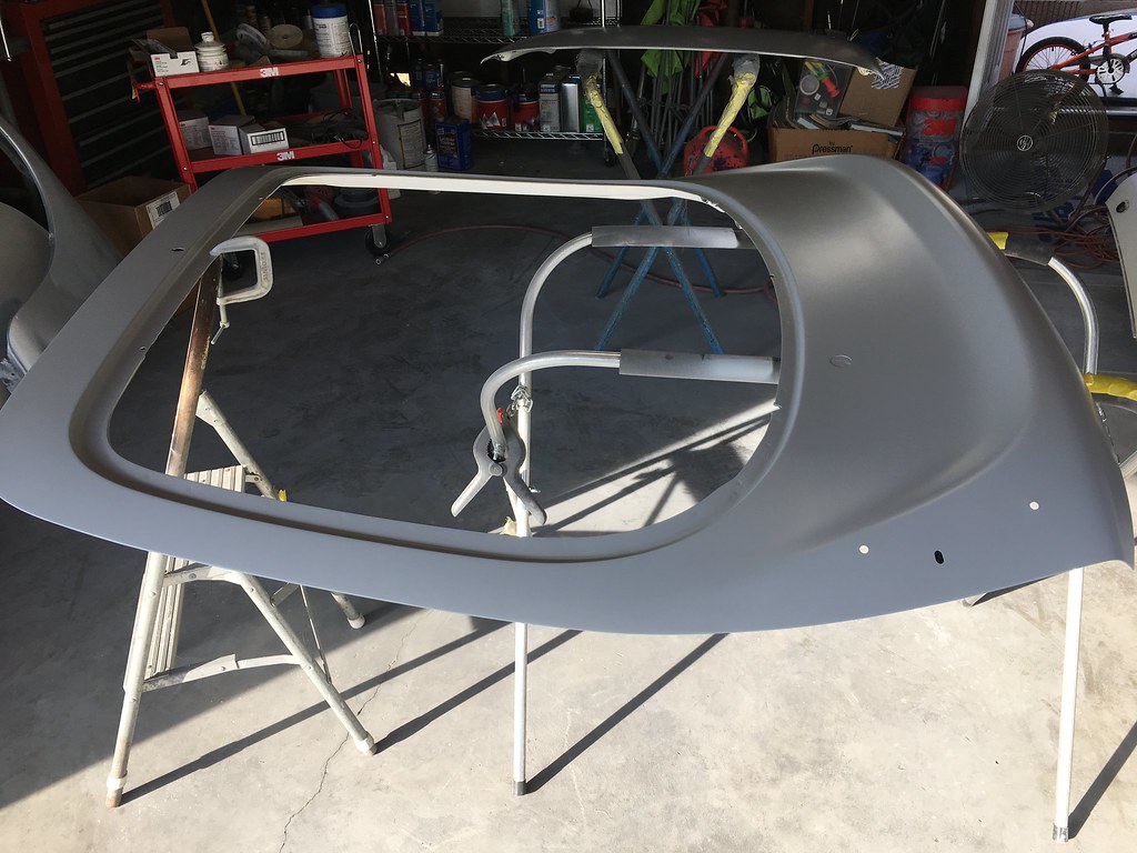

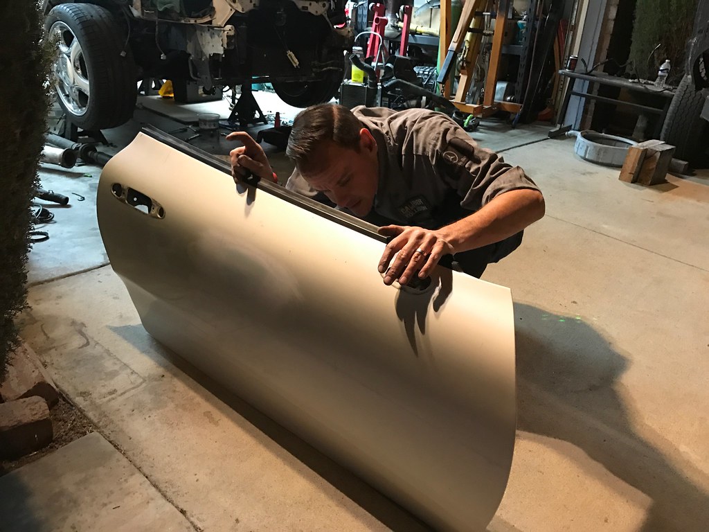

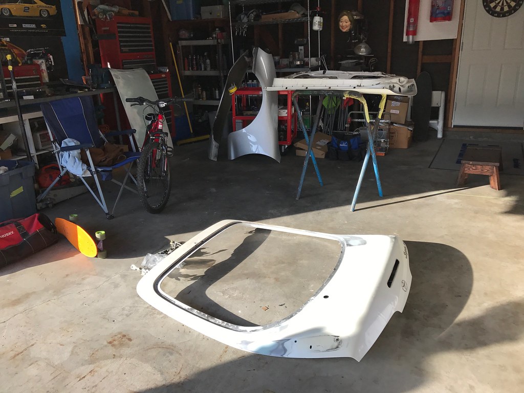

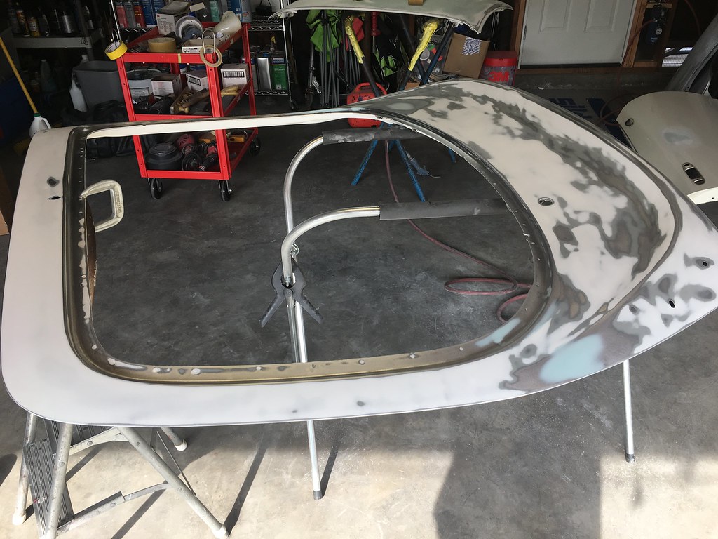

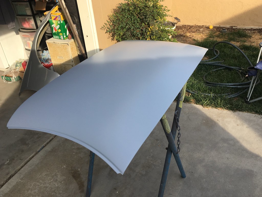

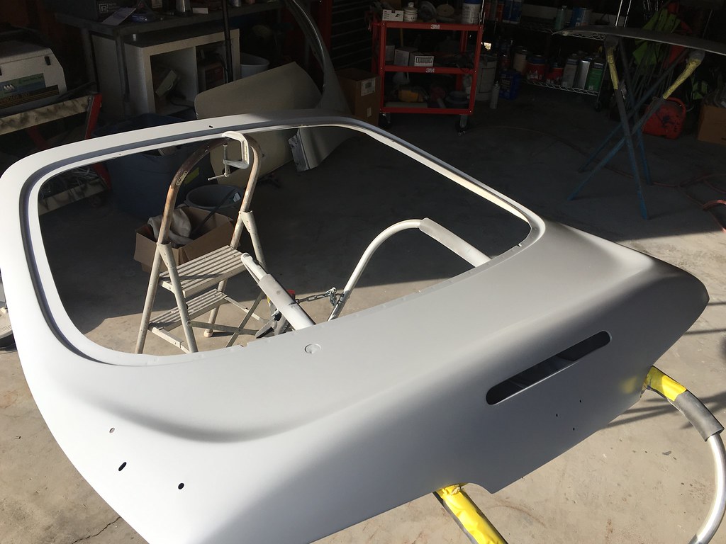

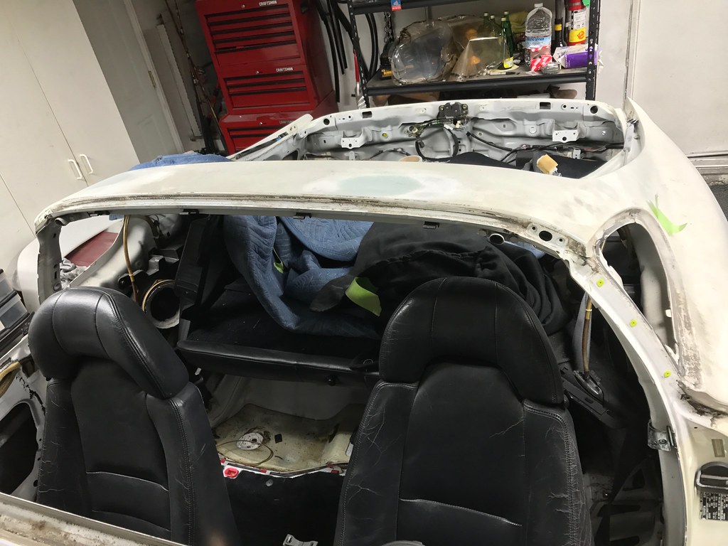

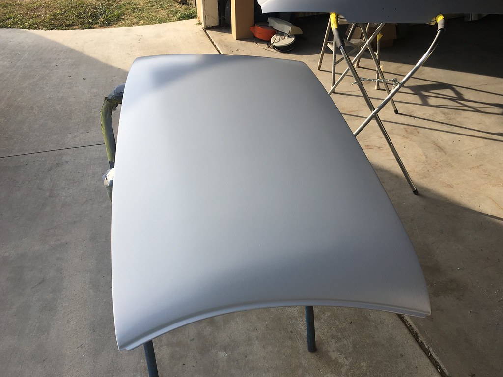

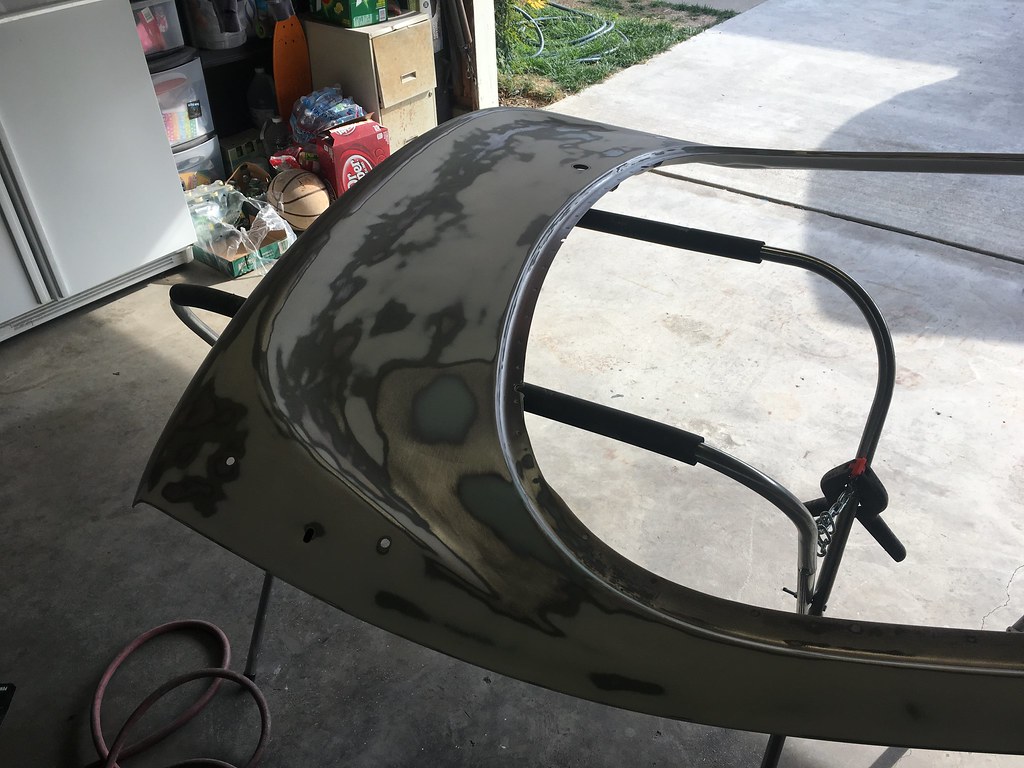

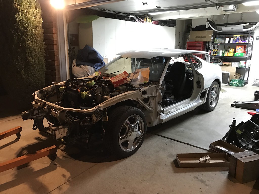

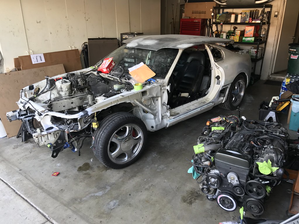

Hatch, driver door, roof, and both fenders off to paint, then later the passenger door.
A peak at the product to be used… Sikkens Superior 250 2-pack Clear

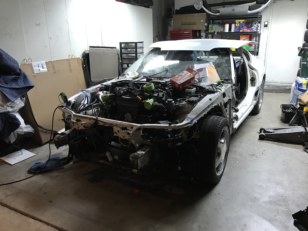

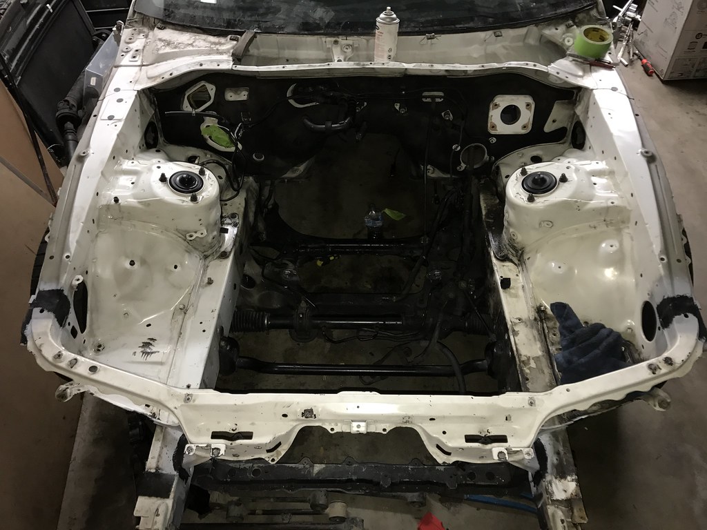

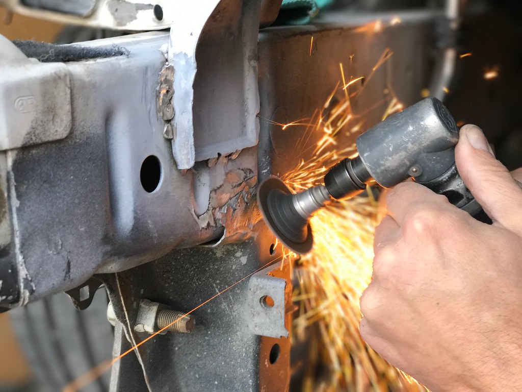

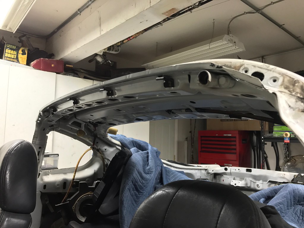

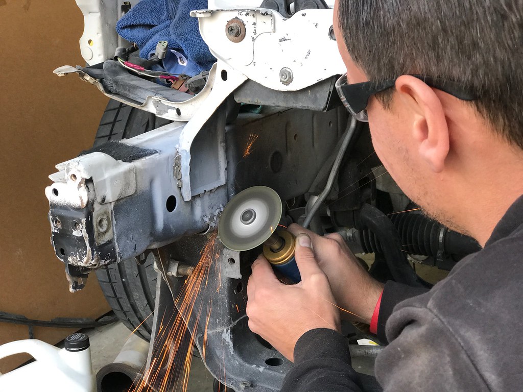

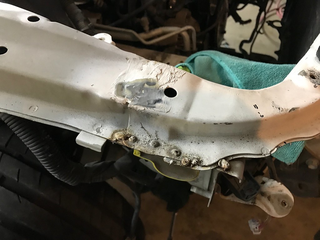

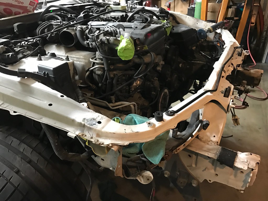

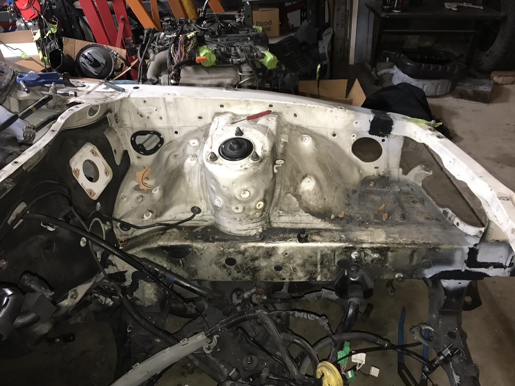

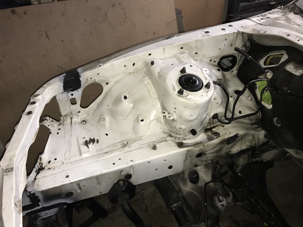

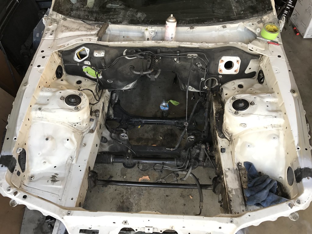

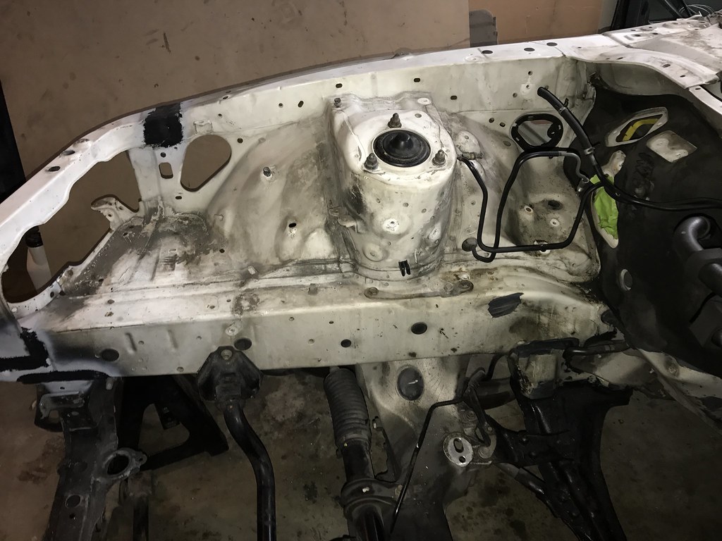

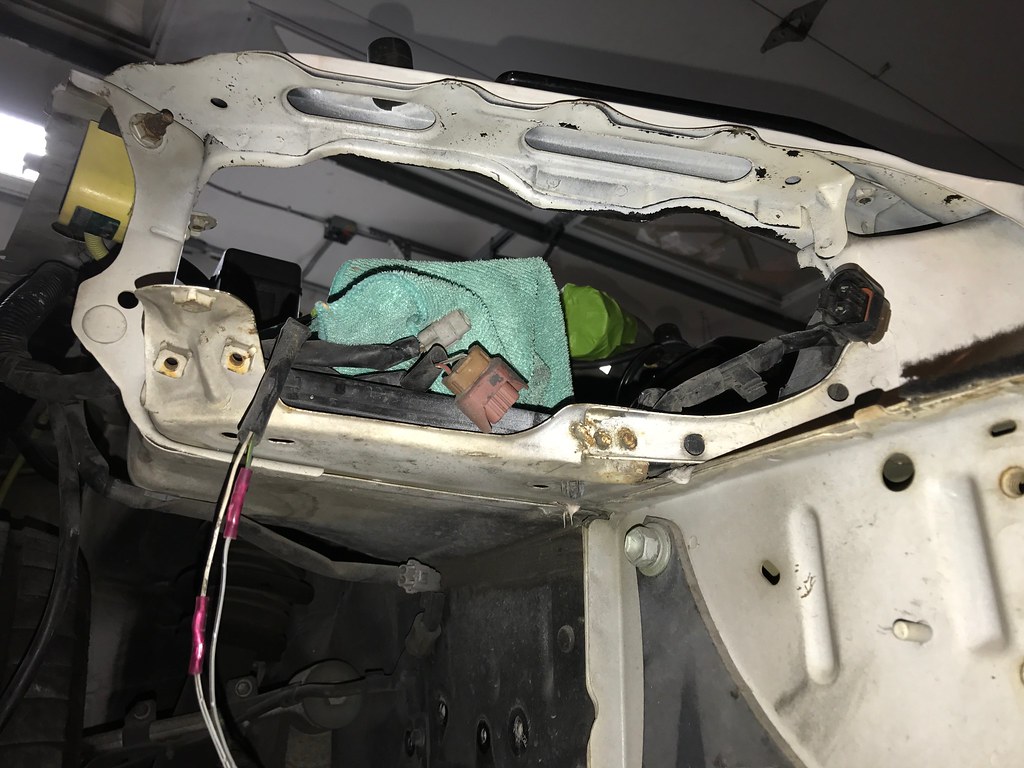

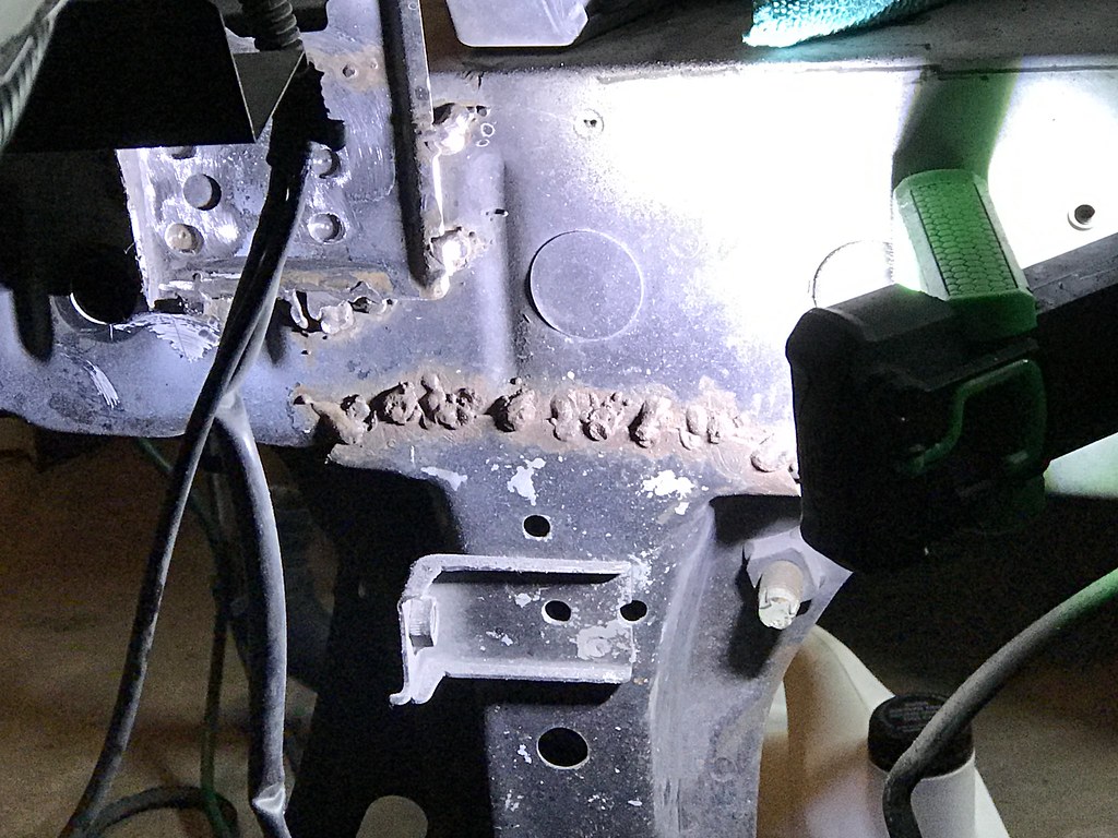

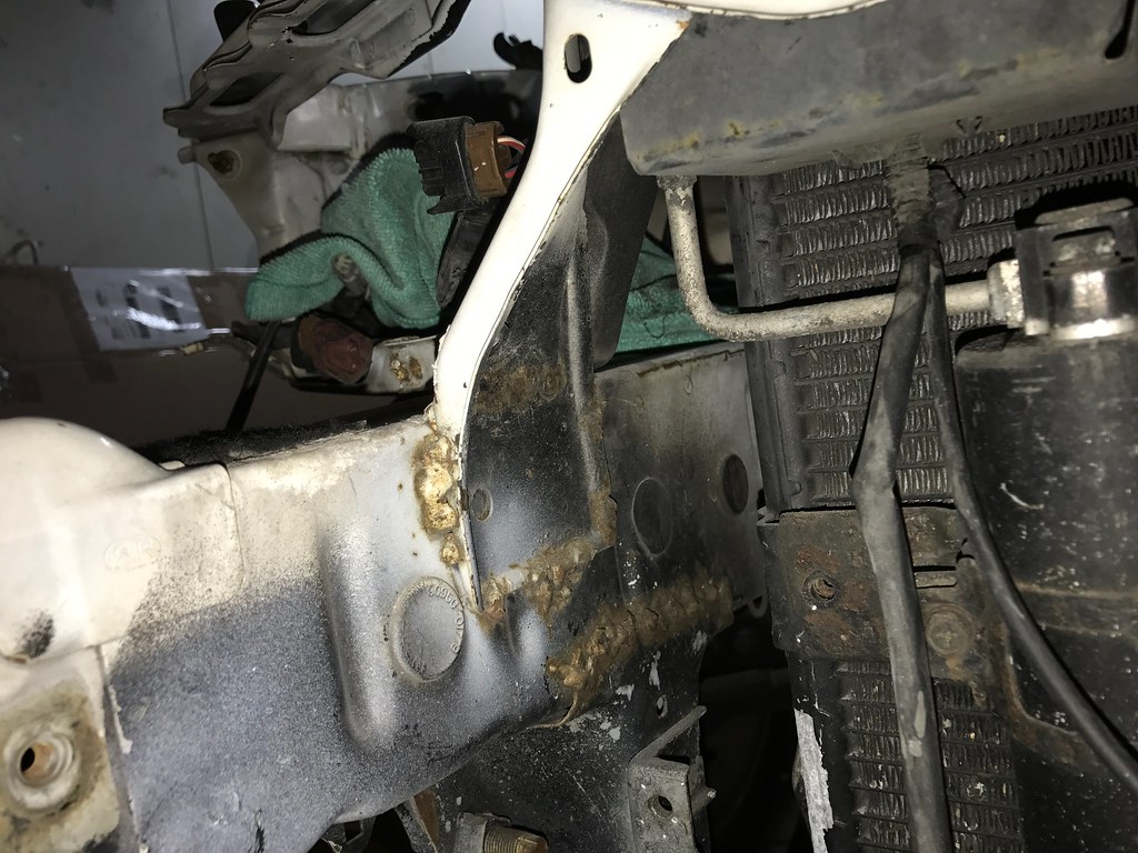

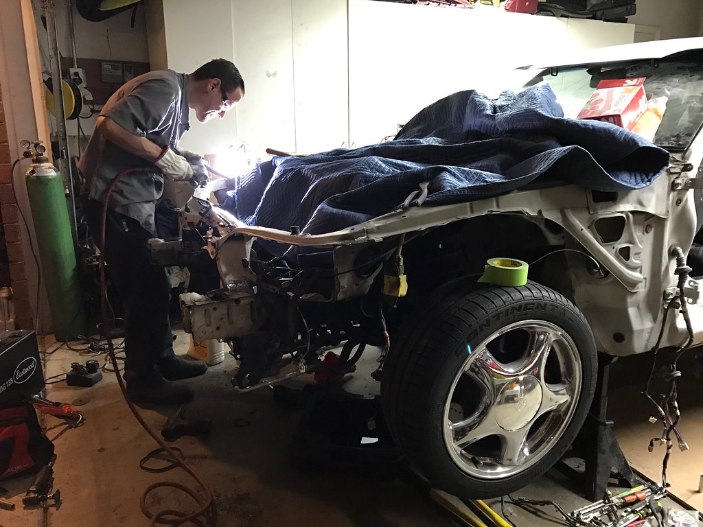

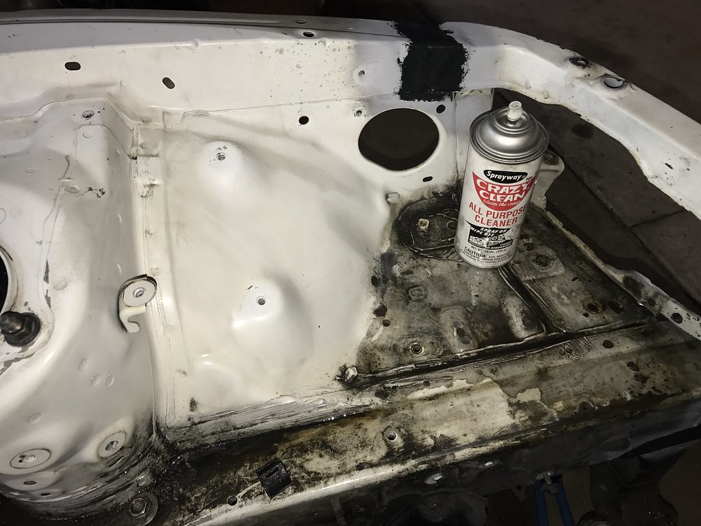

Digging into the core support. Good lord… it doesn’t get any better!

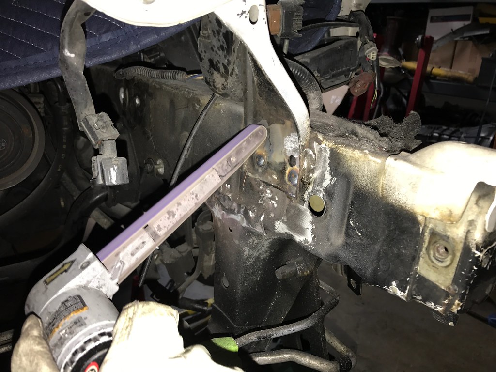

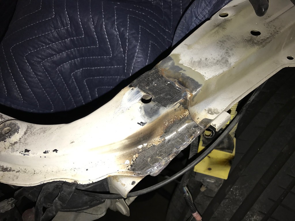

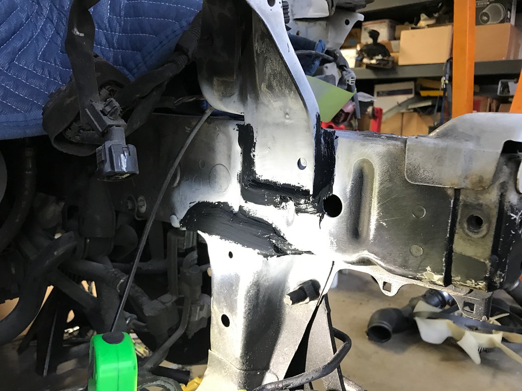

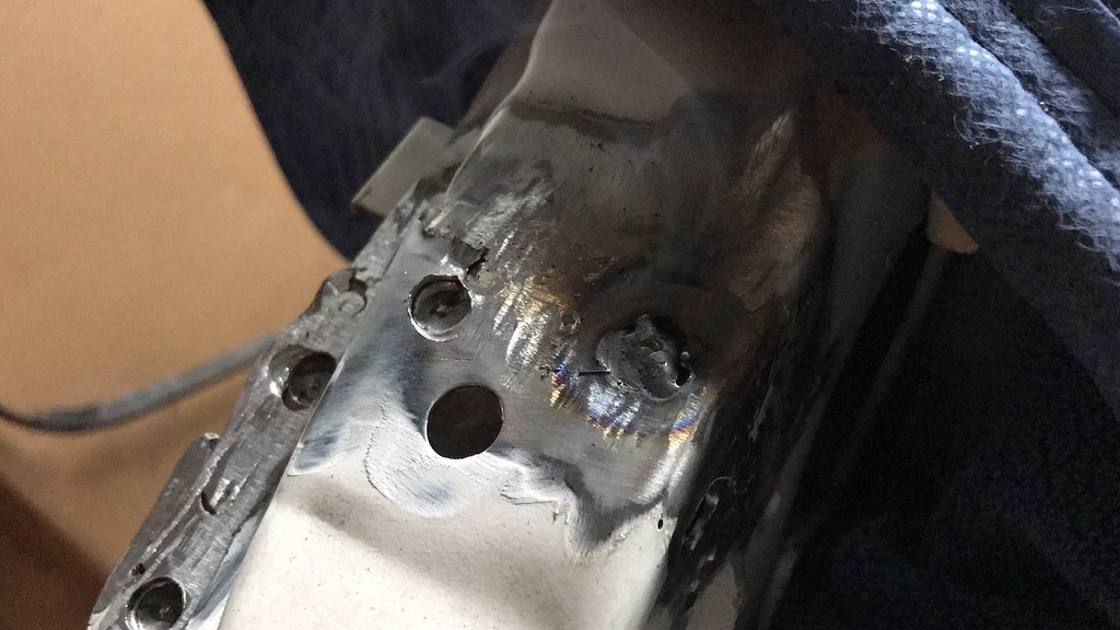

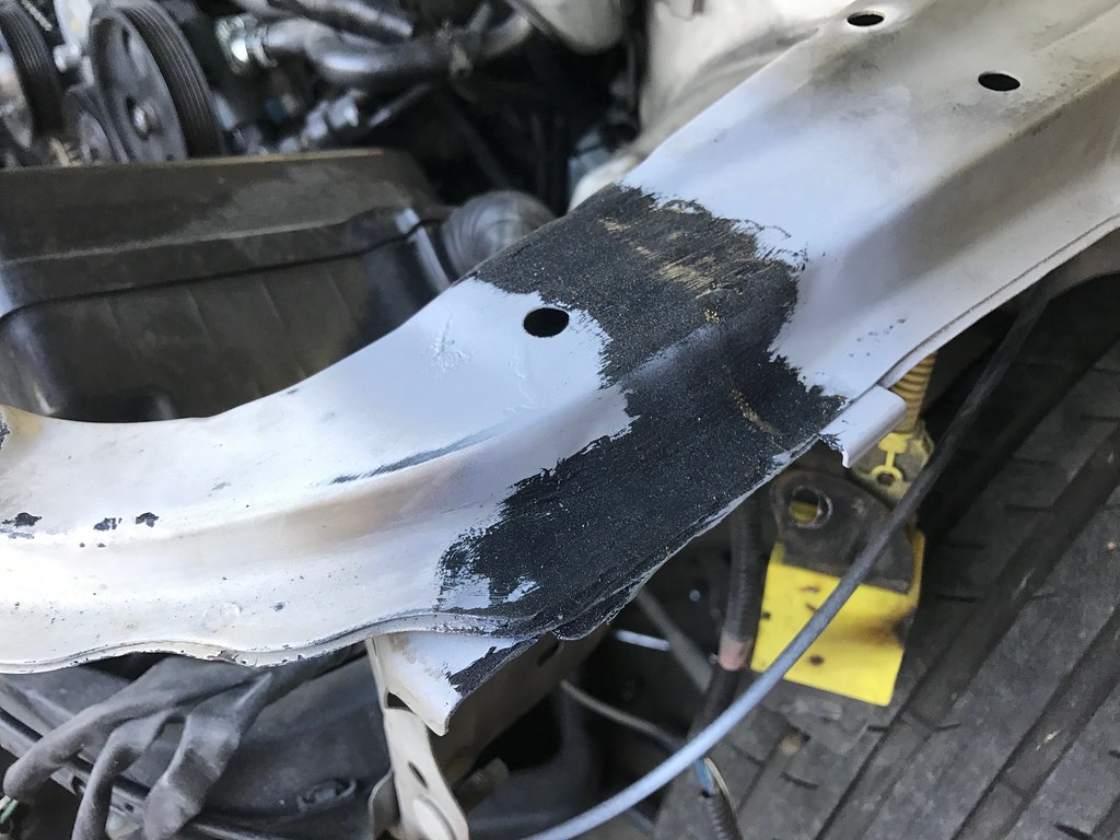

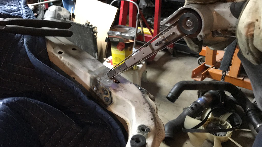

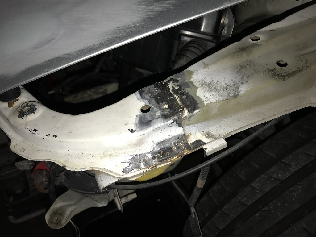

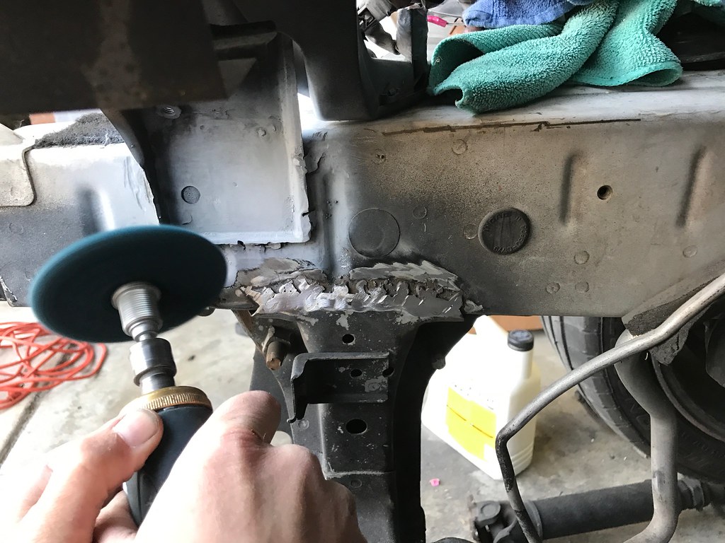

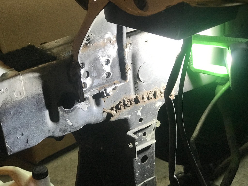

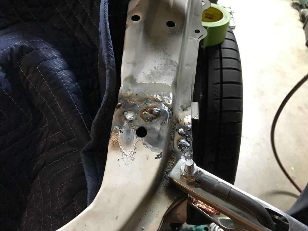

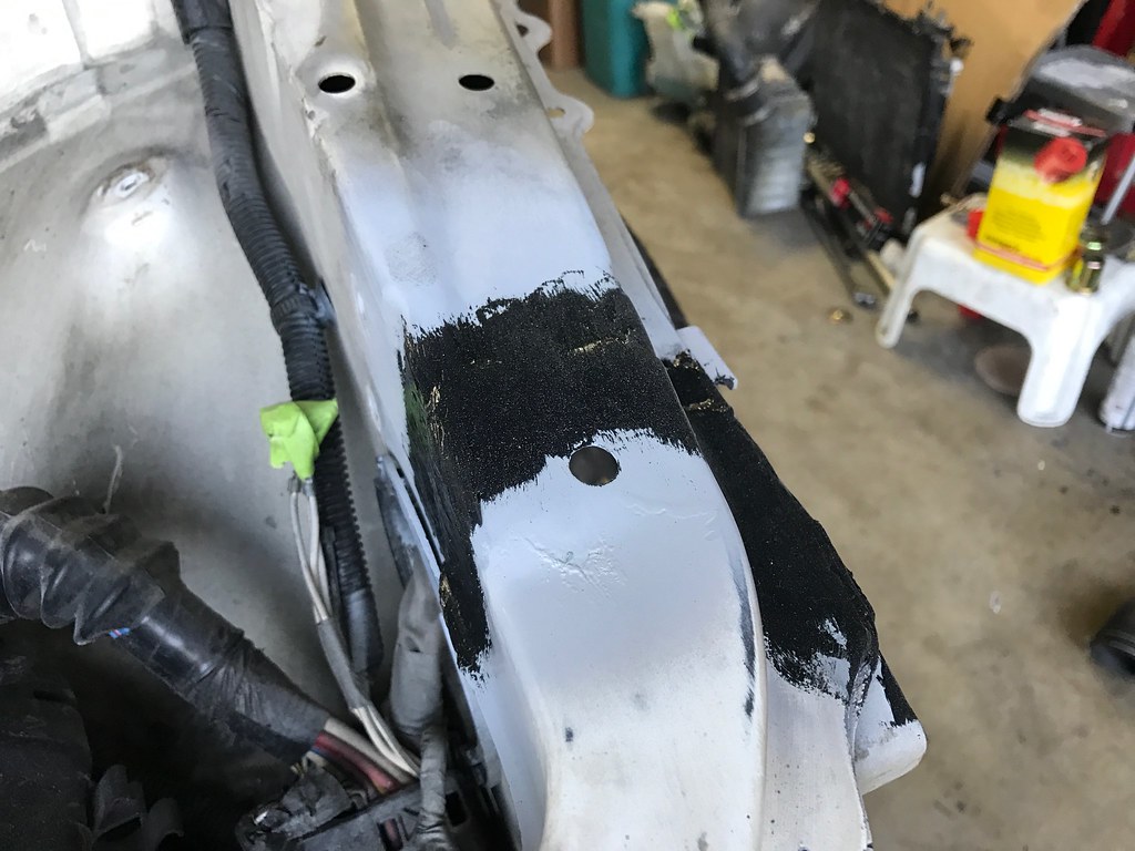

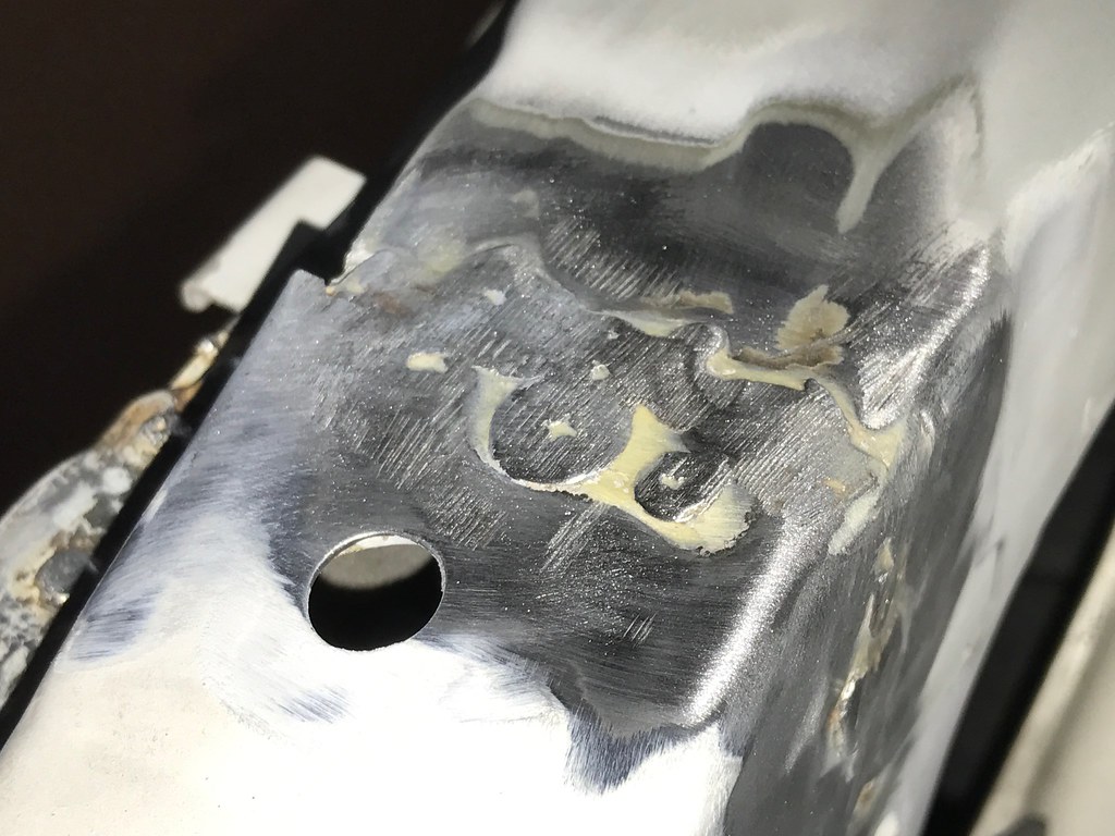

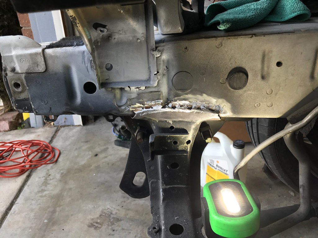

Try not to look… whoever did this should never touch a welder ever again.

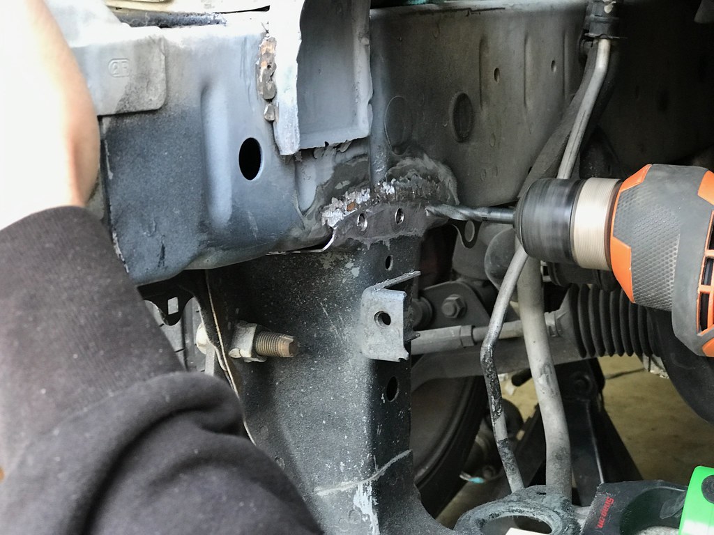

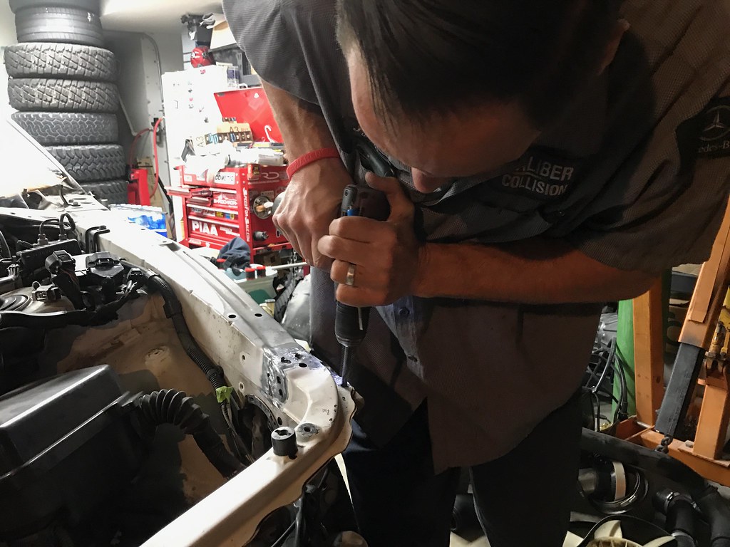

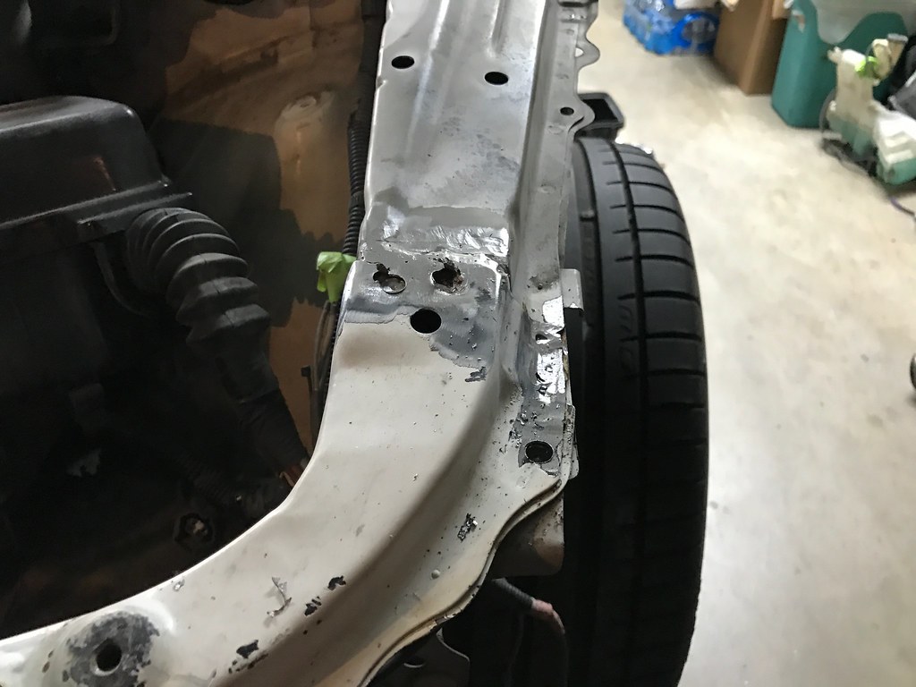

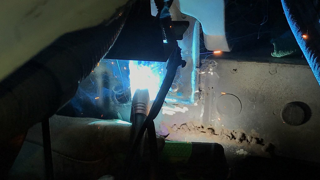

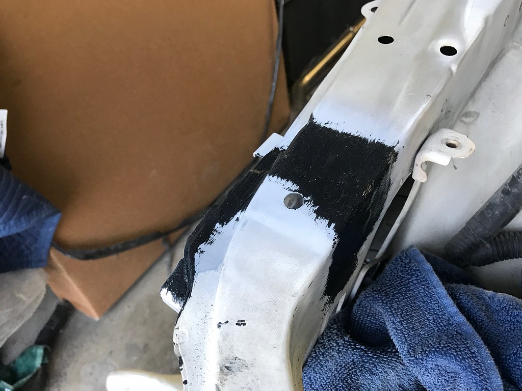

Drilling out some holes to redo this the right way
Booger welds with little penetration to the metal below… holes drilled through the tie bar, welds from the frame rail up through the holes.

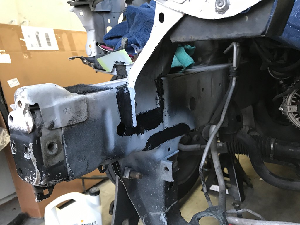

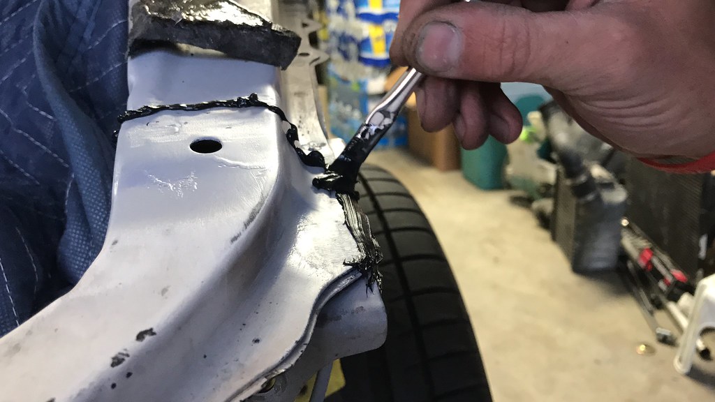

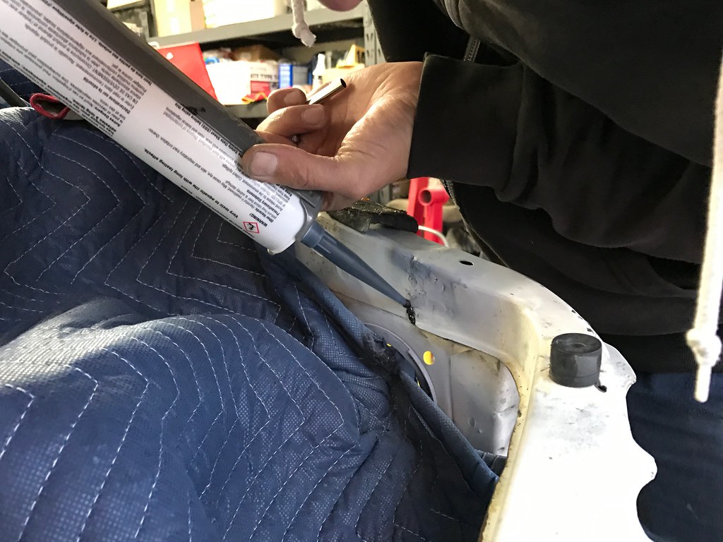

Lower tie bar also welded via the drilled holes, but I didn't get a picture of that before application of the black seam sealer

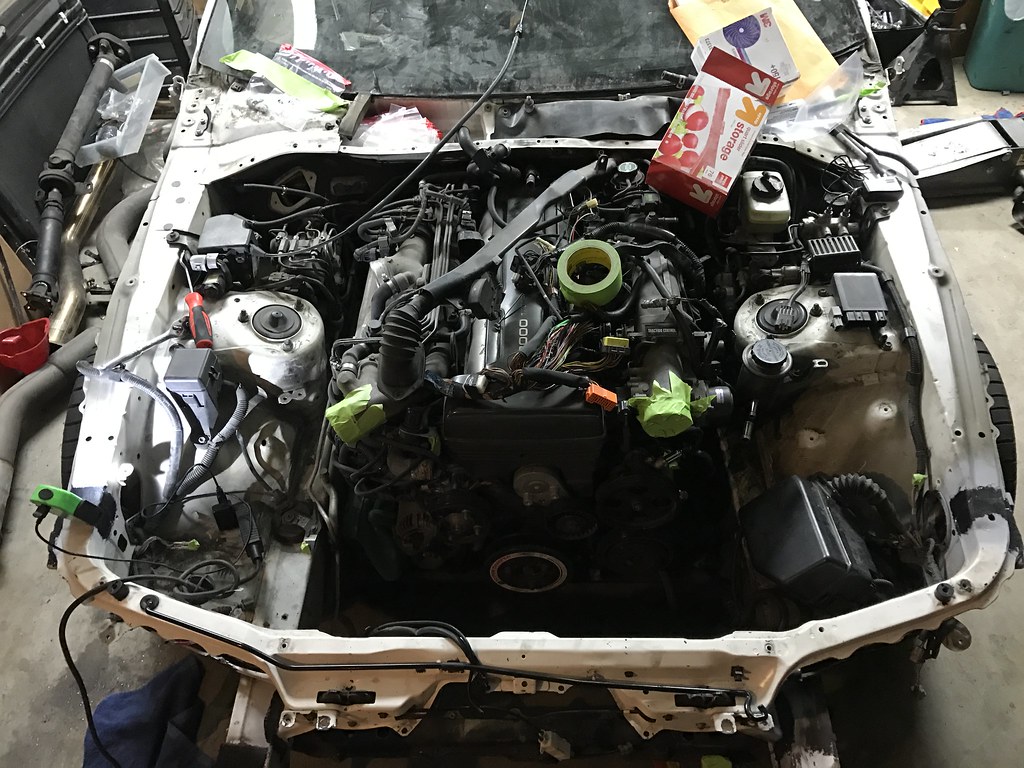

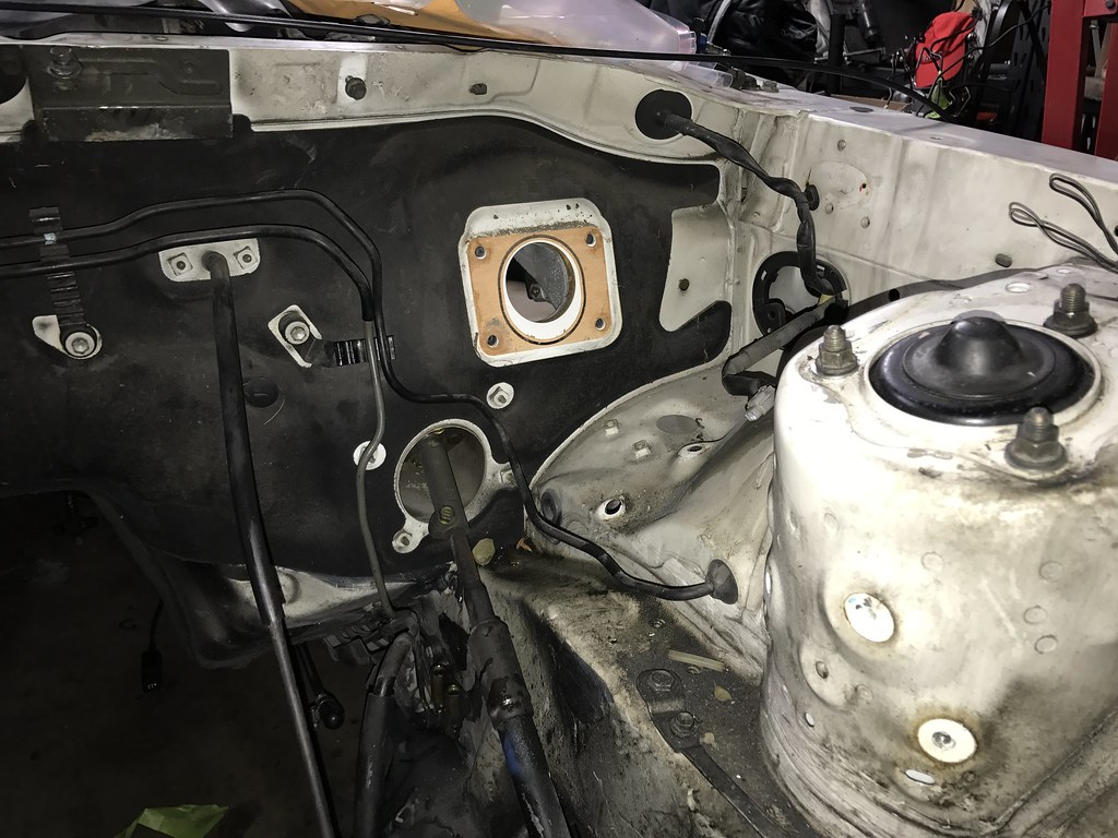

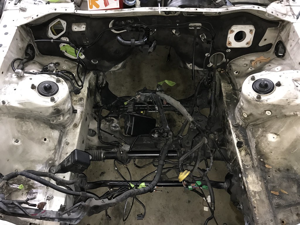

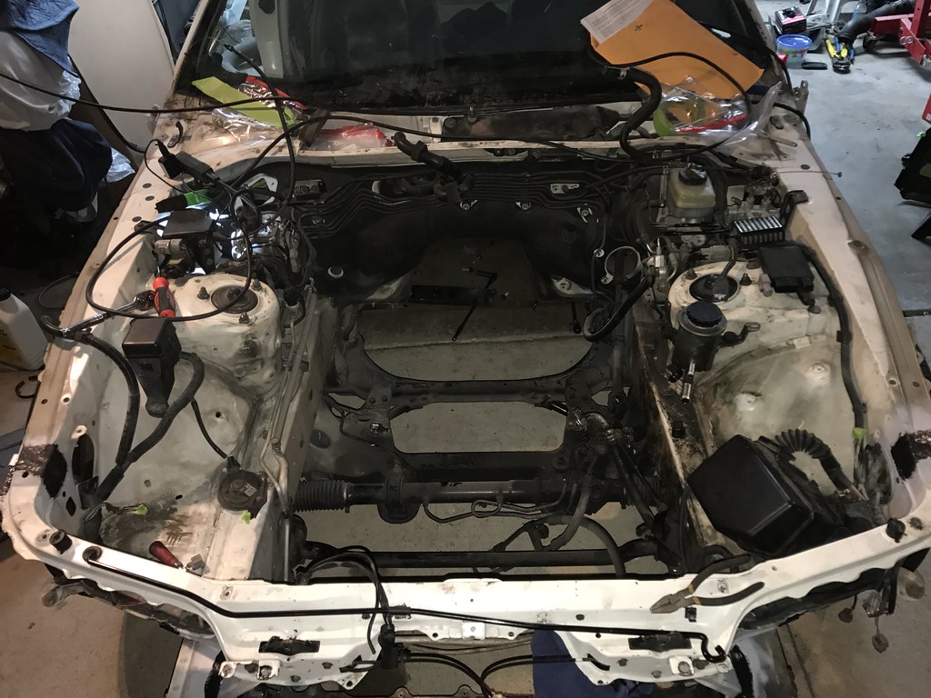

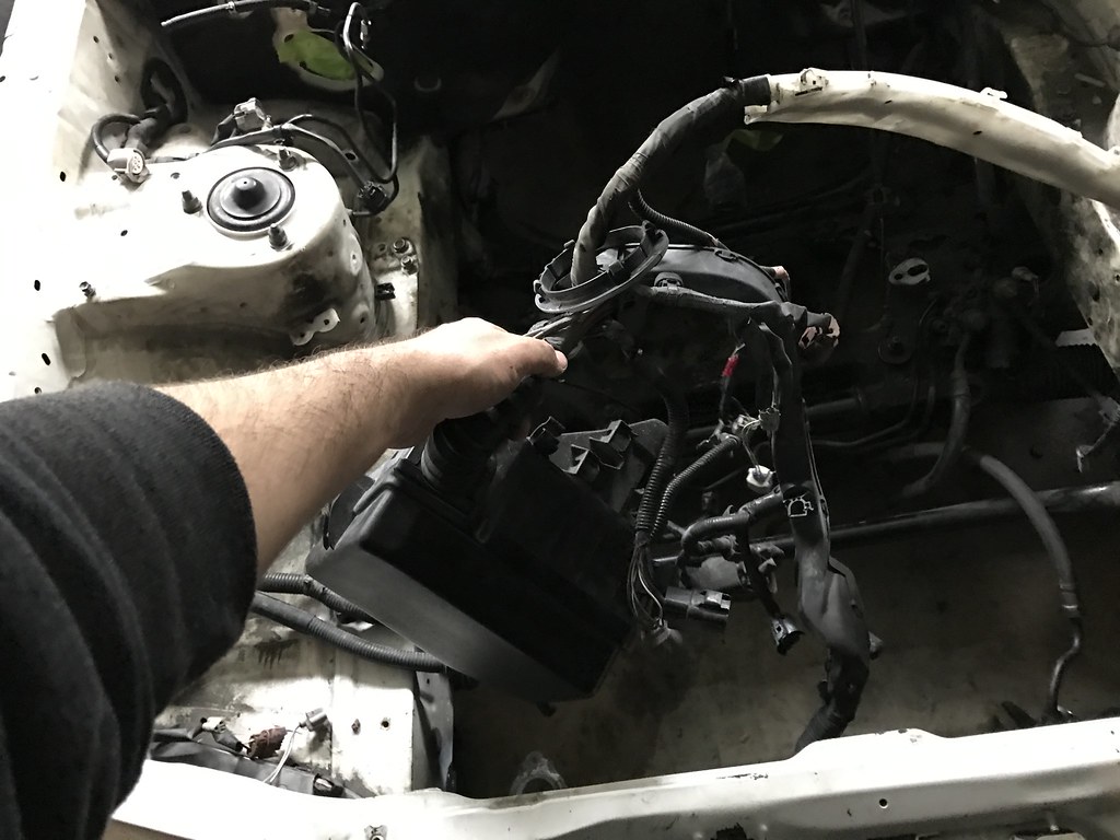

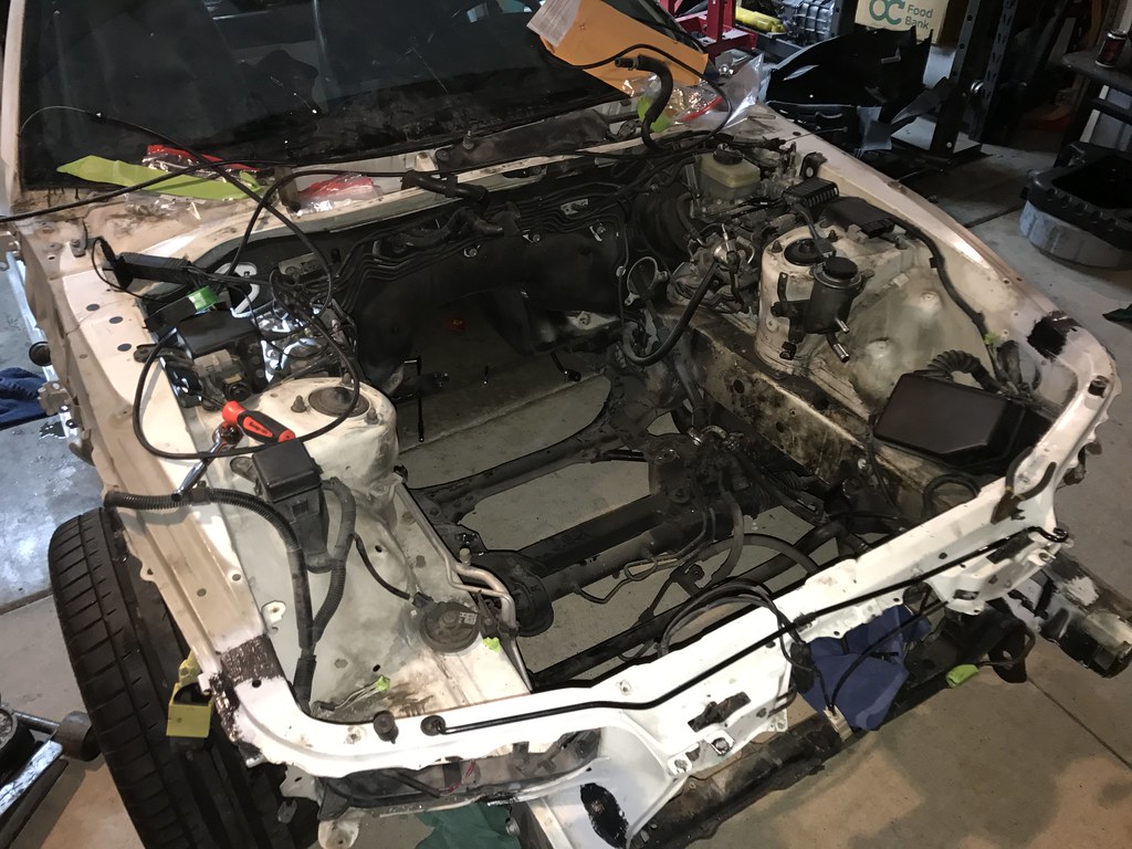

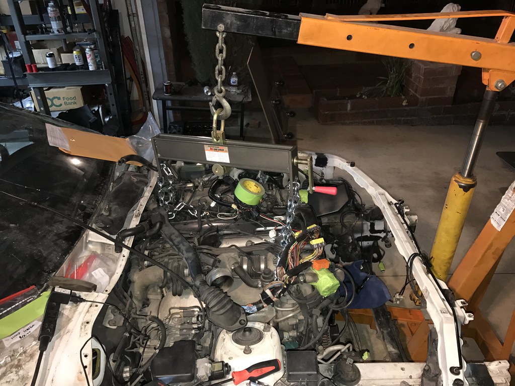

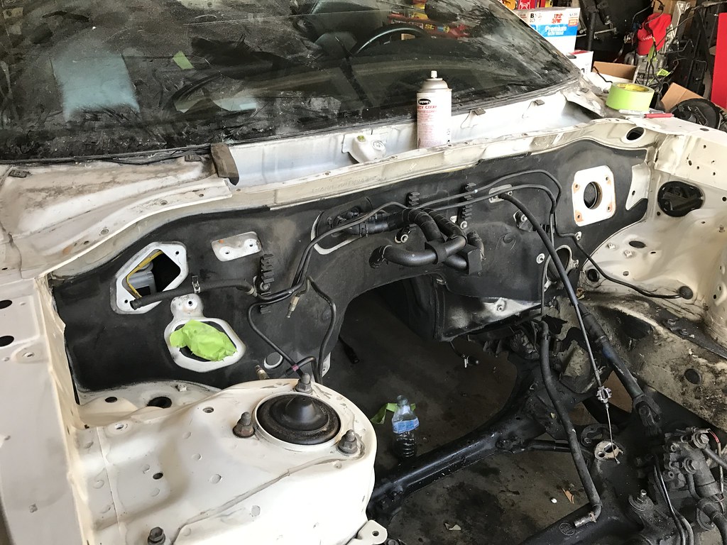

ECU Wiring out through the firewall.

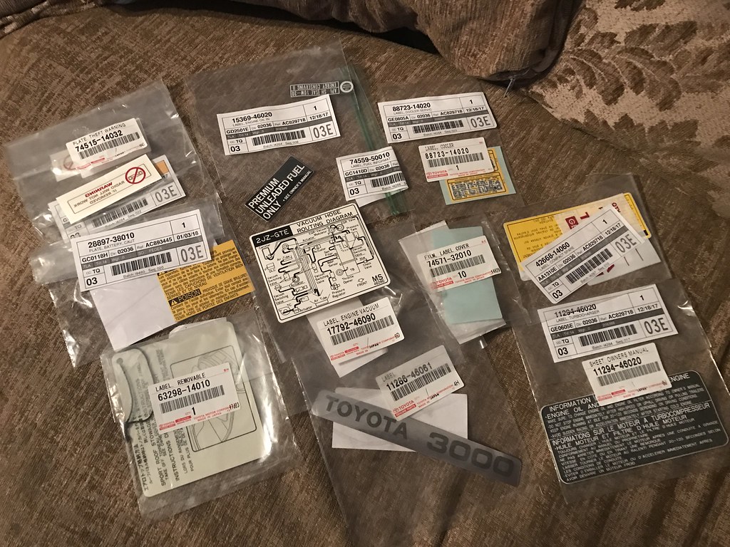

Stickers for when relabeling happens. I literally bought all that were available, even a few too many because some N/A stickers showed up too.

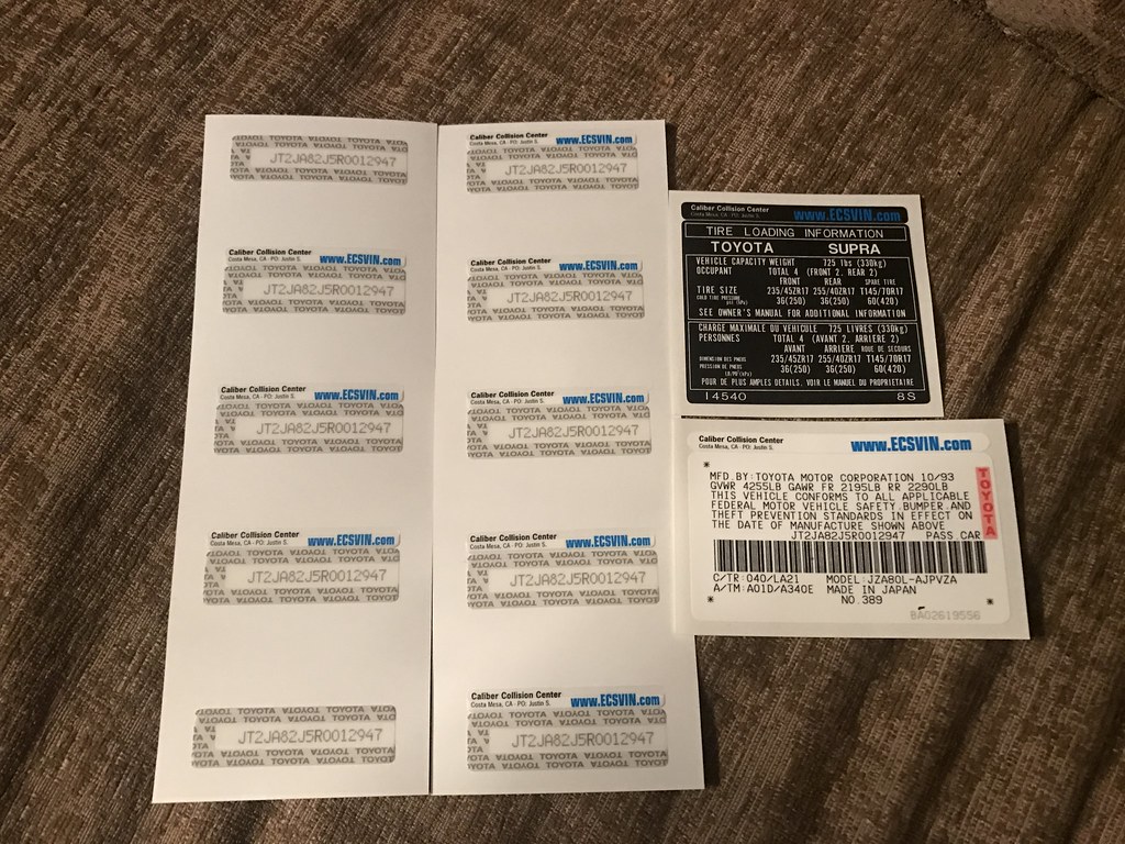

Reproductions from ECS Vin. All 10 Security tags, tire loading info, and door jamb tag.

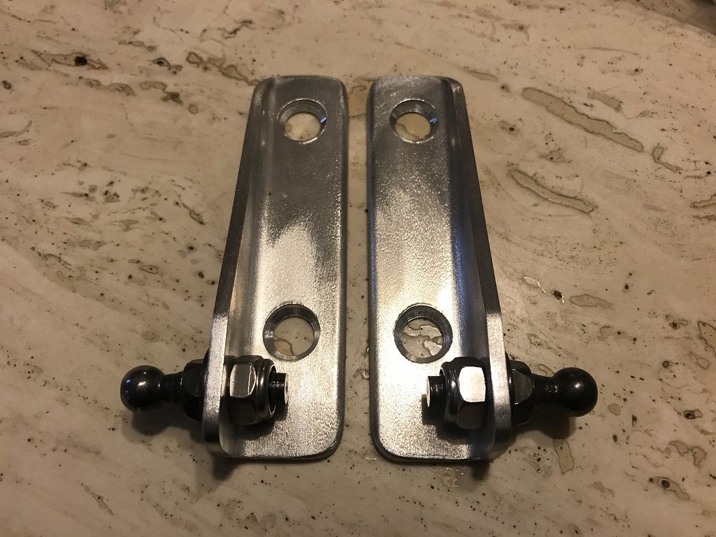

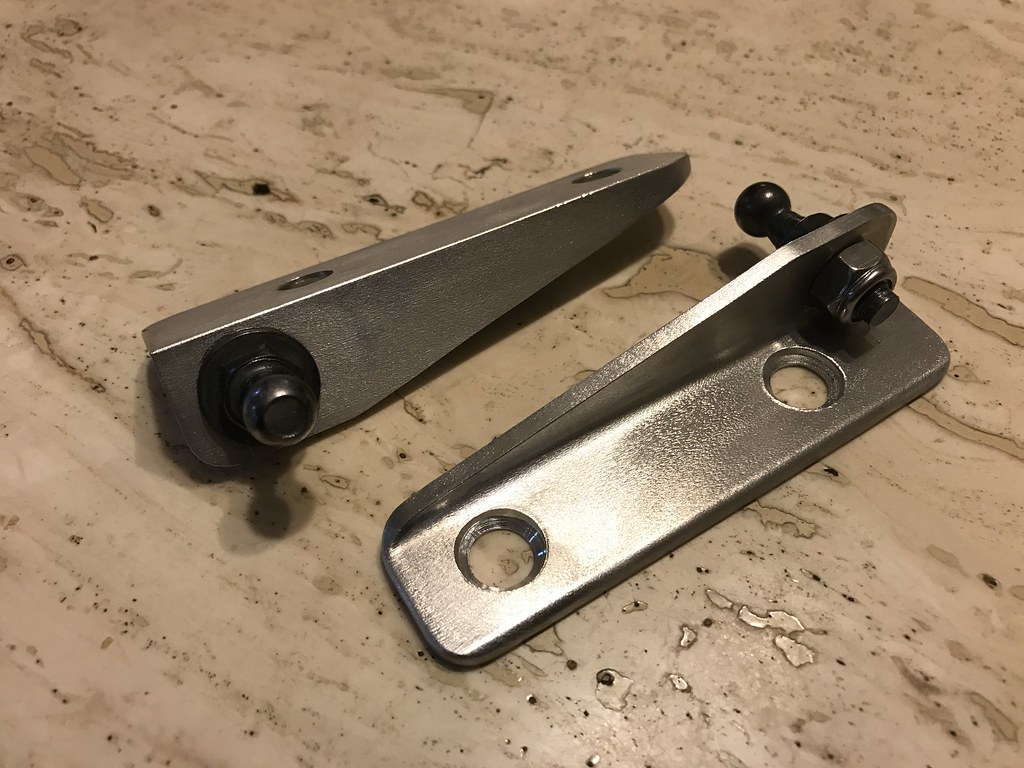

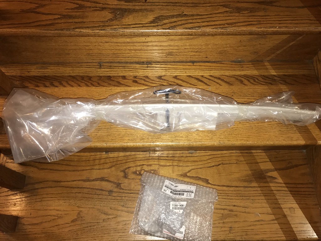

Hood brackets for struts. Also got struts for front and rear.

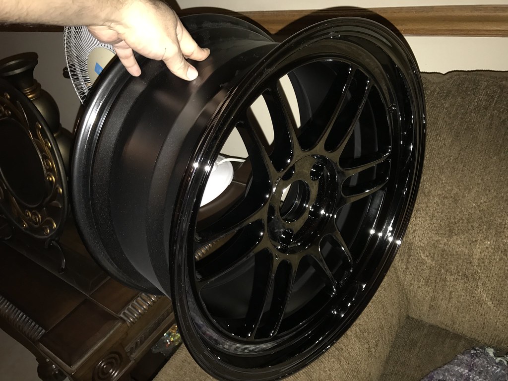

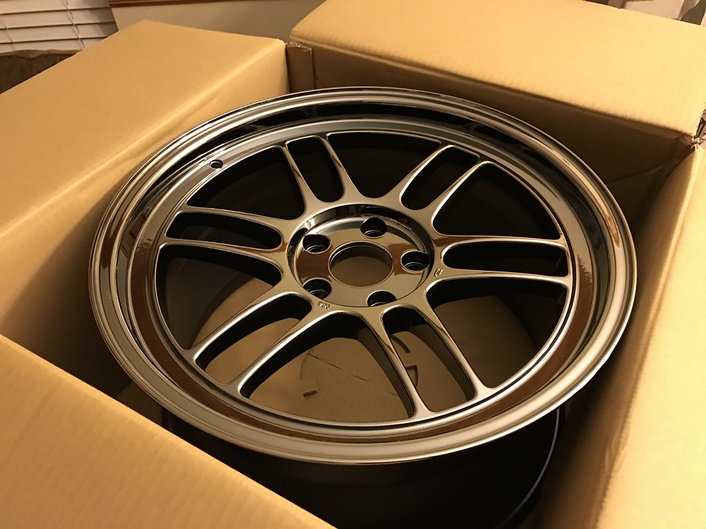

Enkei RPF1's in SBC - 18x9.5 +38

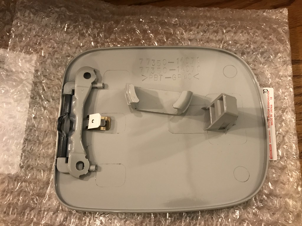

Fuel door with cap holder!

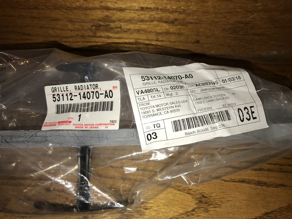

Grille in white, to be painted.

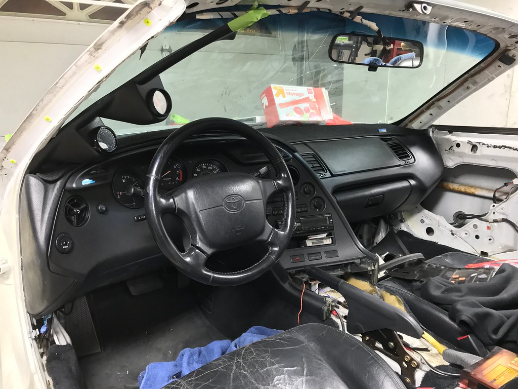

I'm not a huge audio nut like some people. Most of the time, I leave the radio off. After seeing the rear speakers, I grabbed a set of (4) 6.5" Rockford Fosgate speakers for front and rear. ANYTHING is better, and the price was right. I hate the combo speaker look so these will be hiding behind a rewrapped OEM speaker grille.

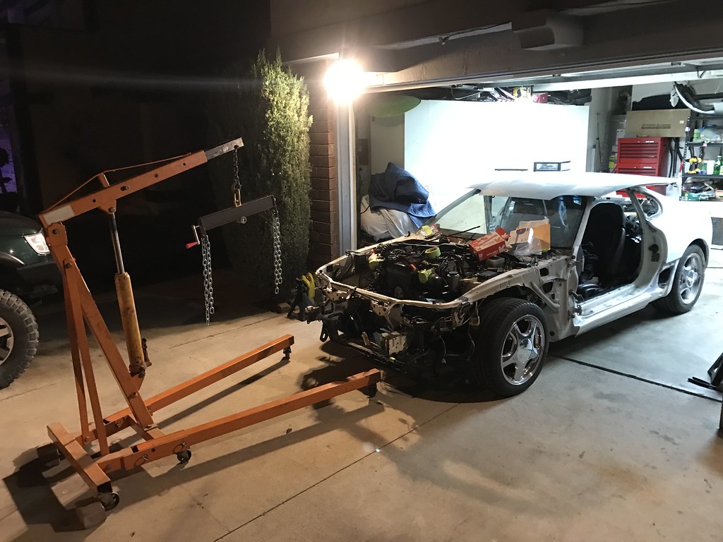

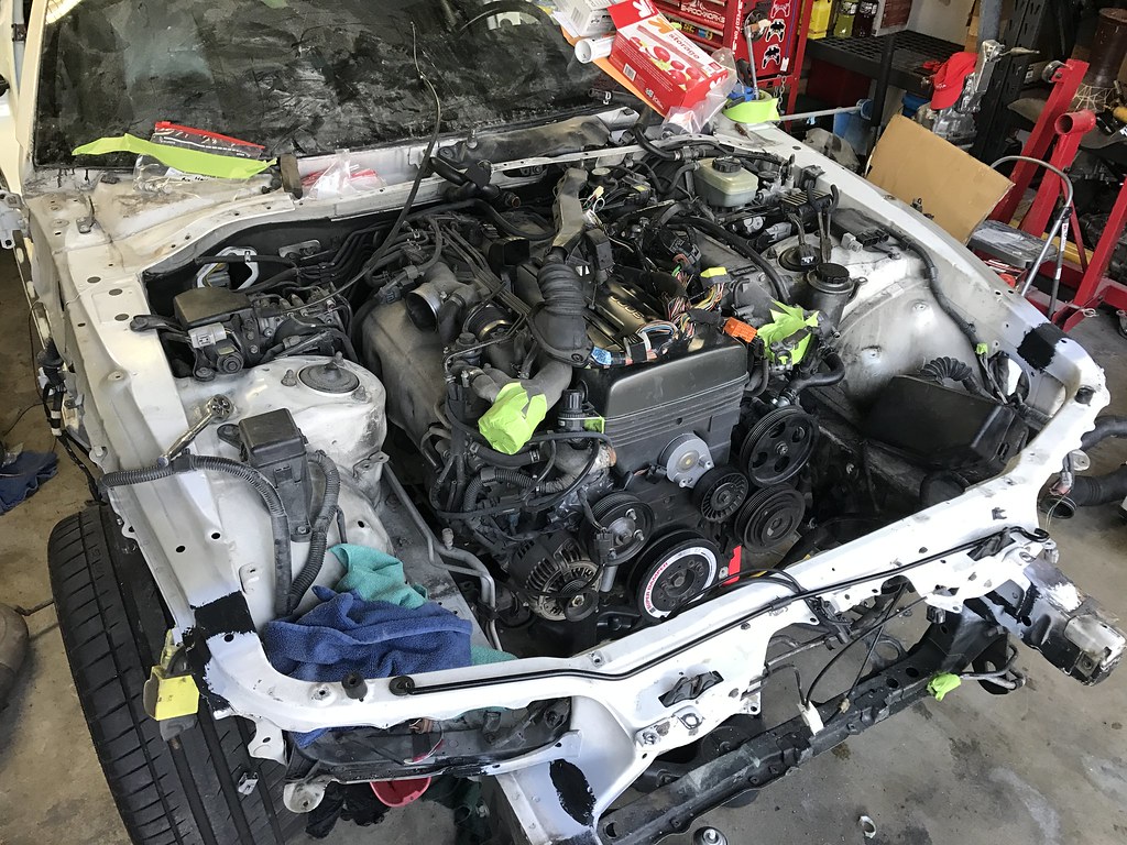

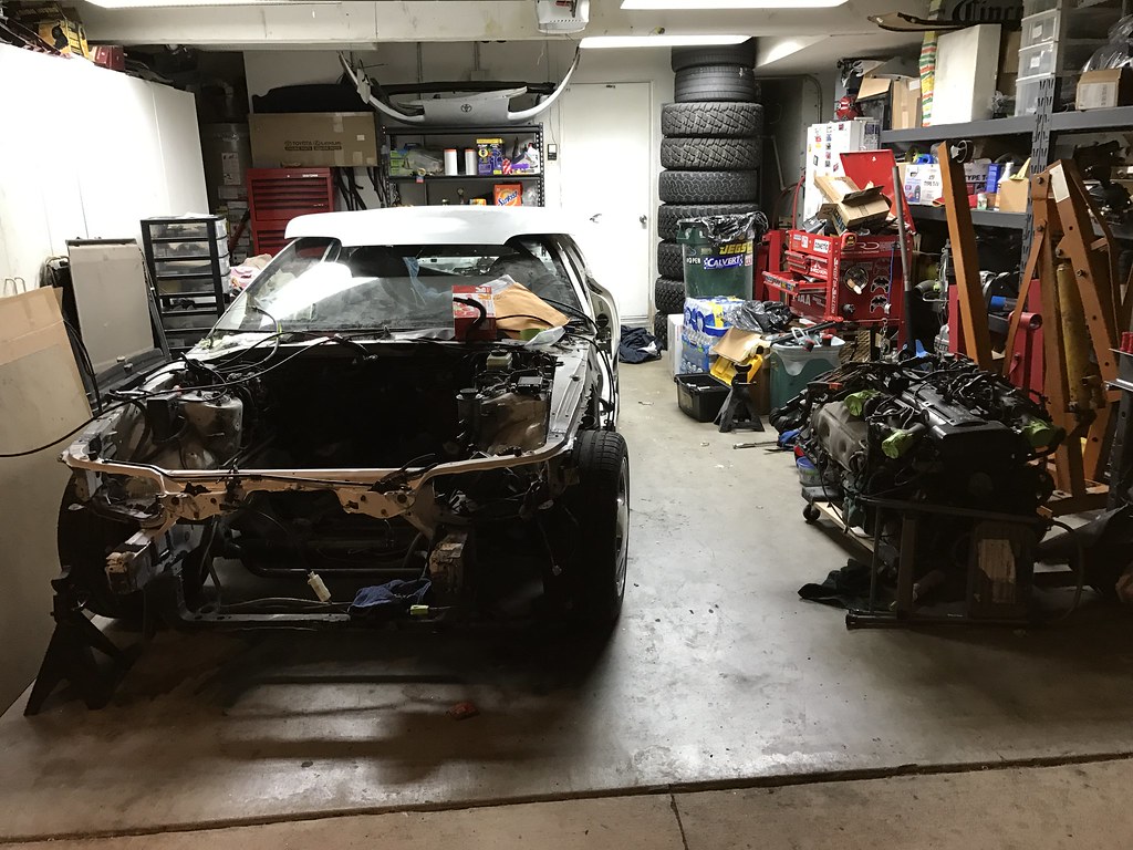

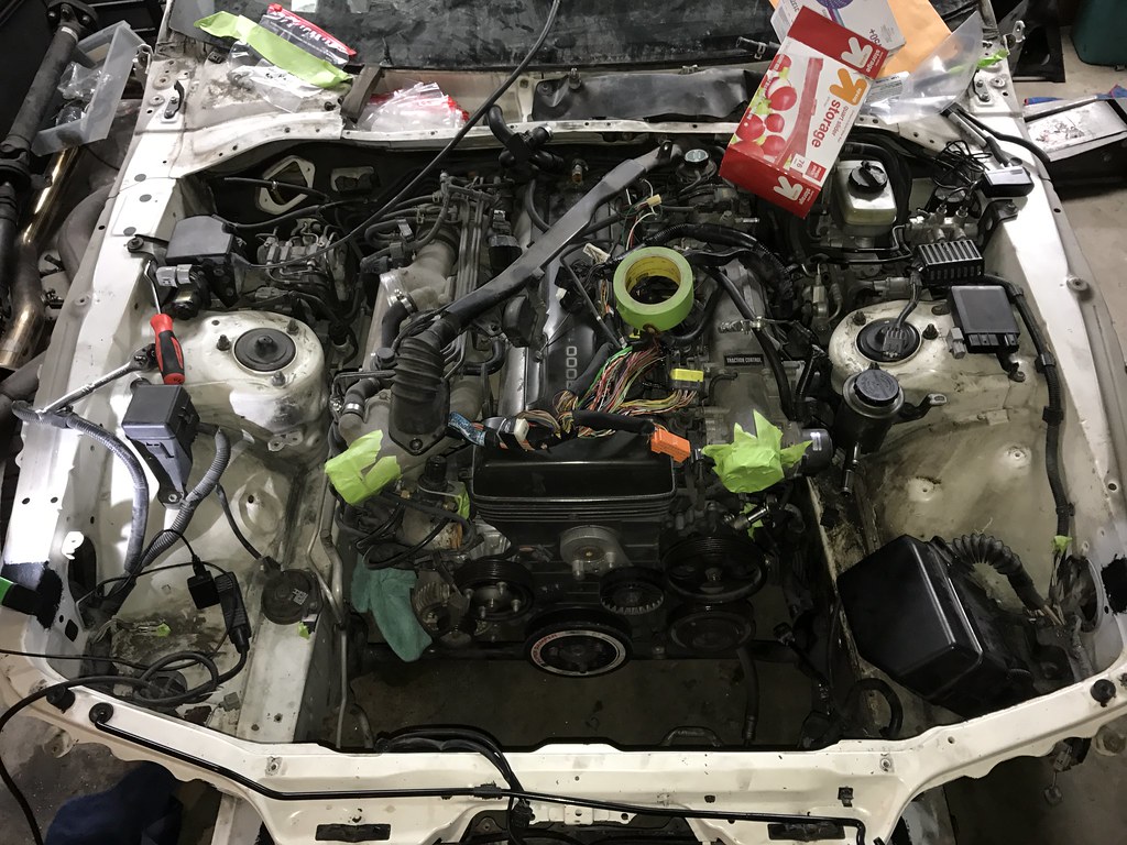

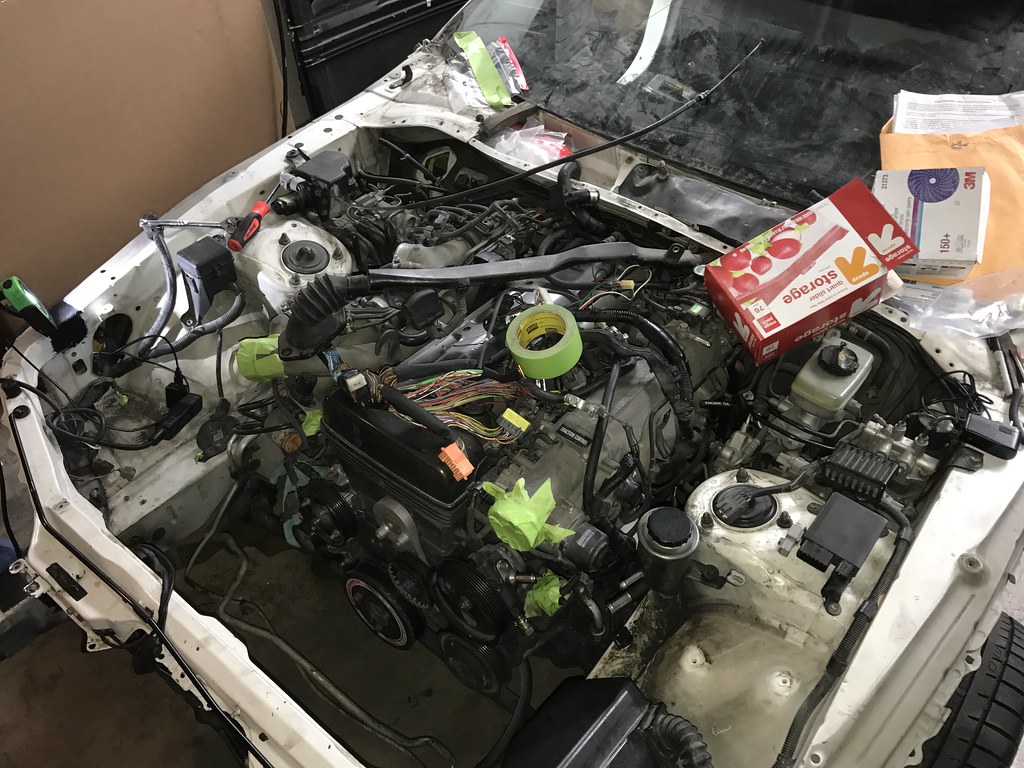

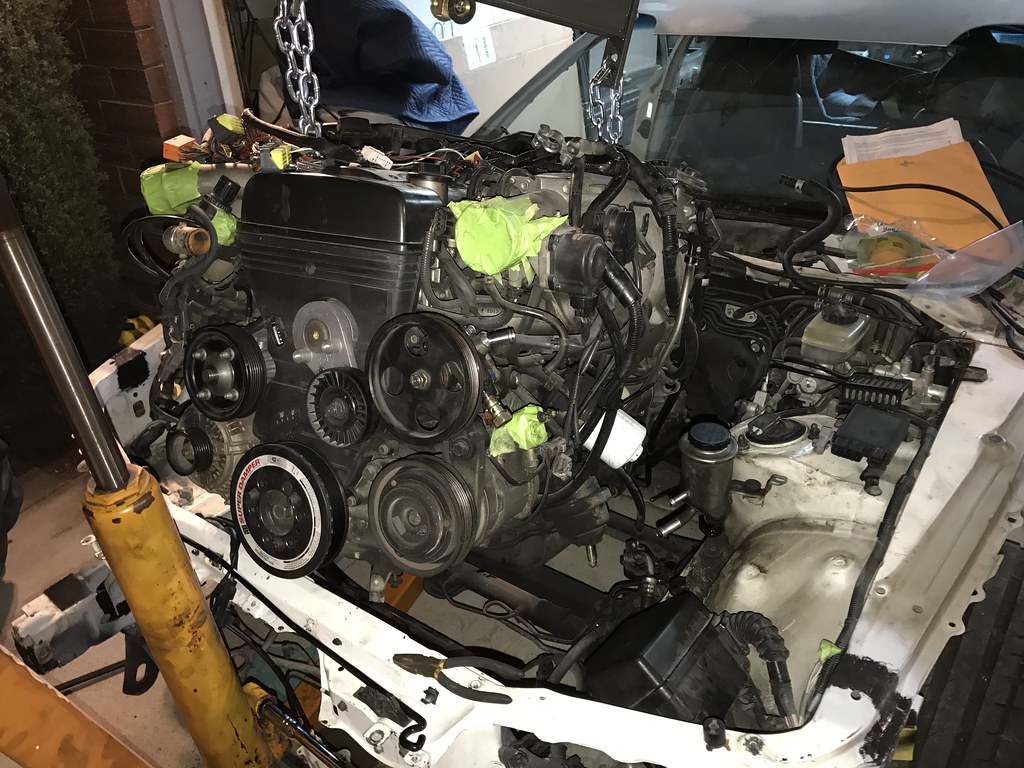

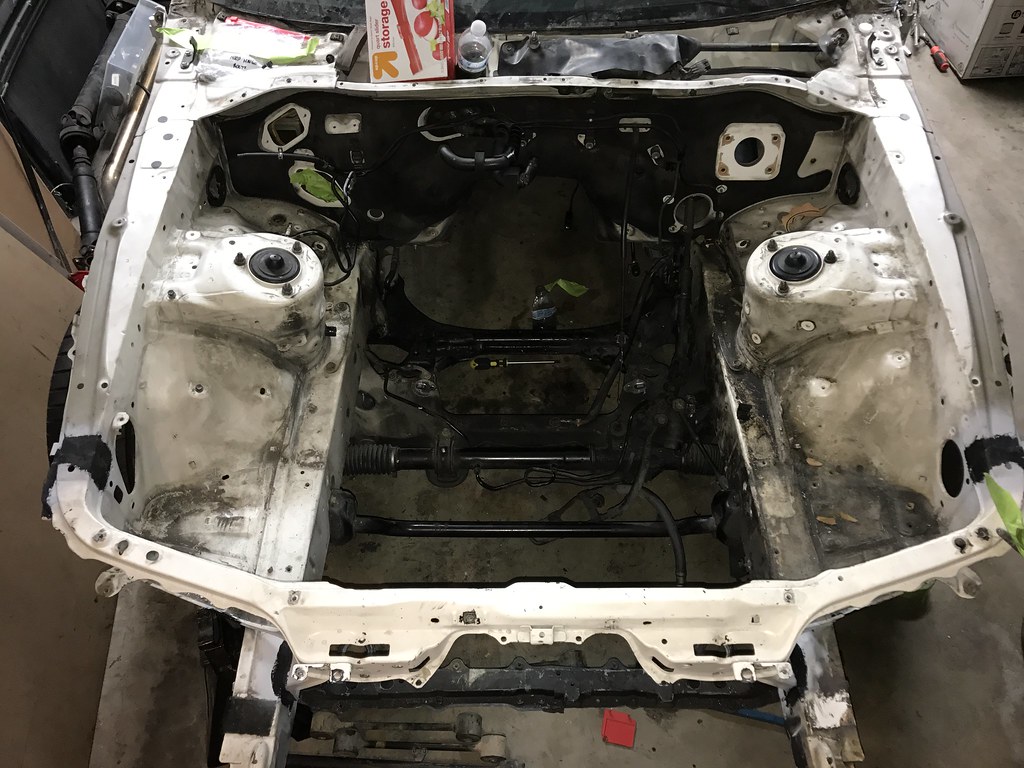

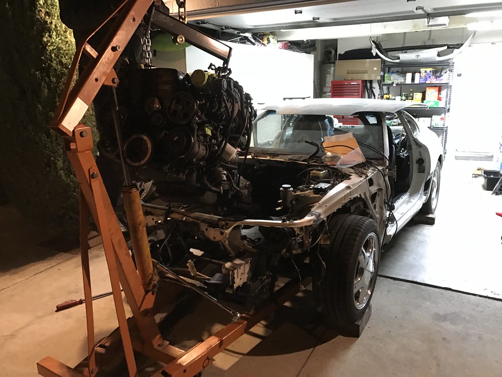

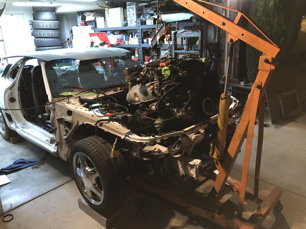

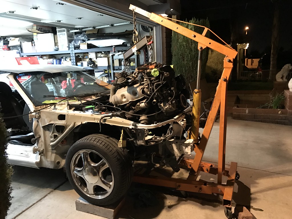

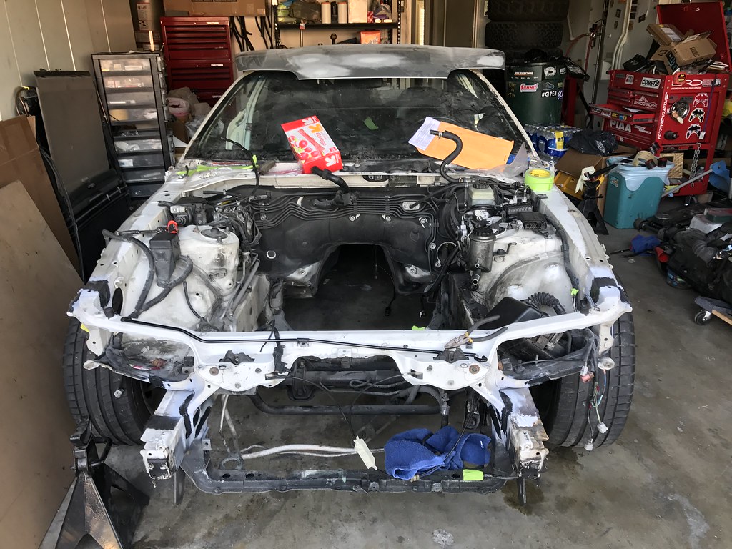

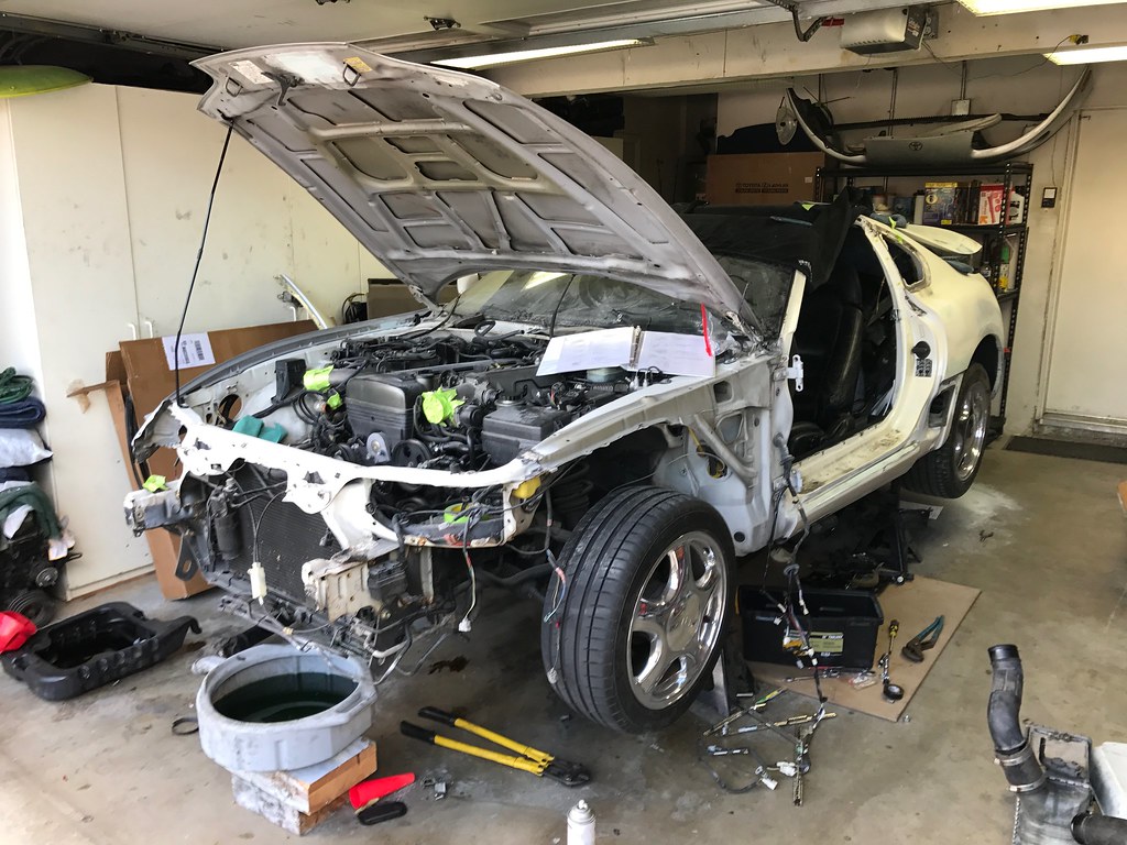

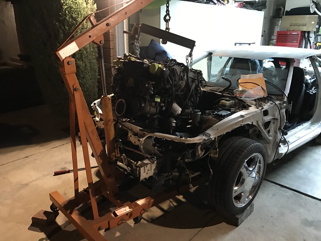

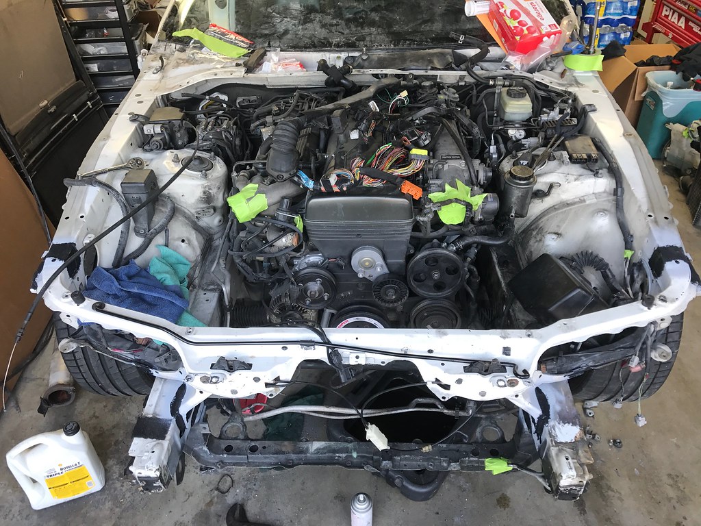

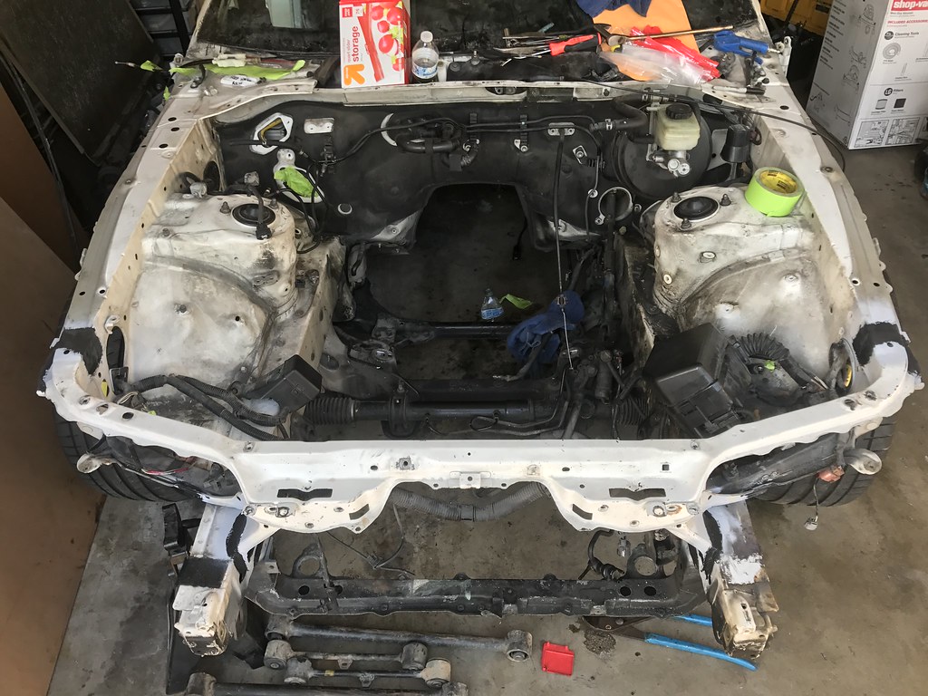

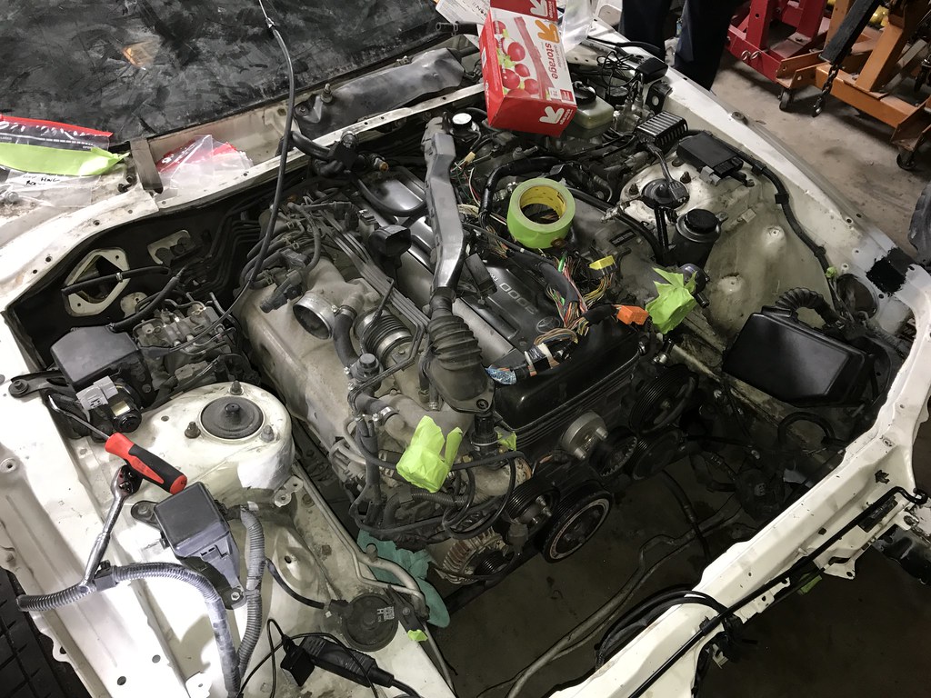

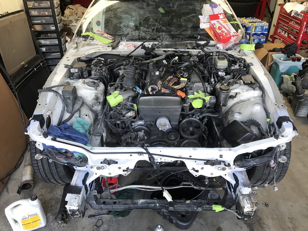

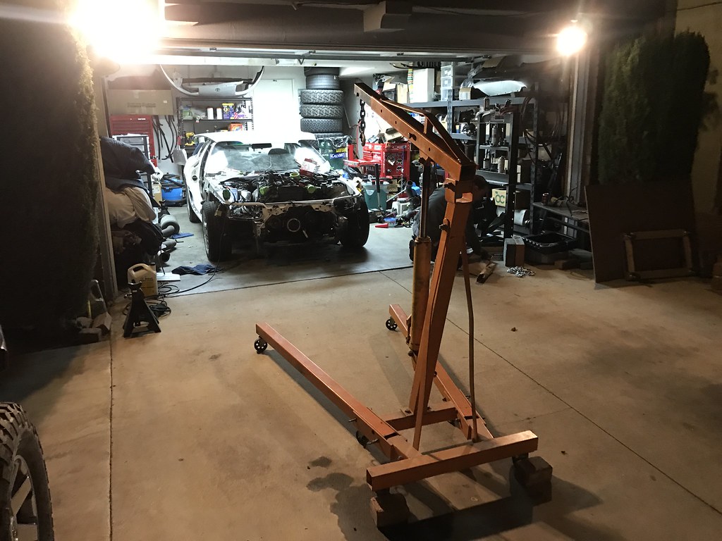

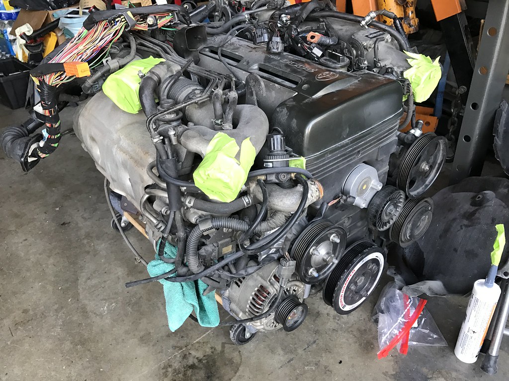

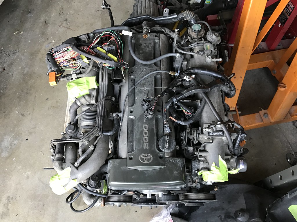

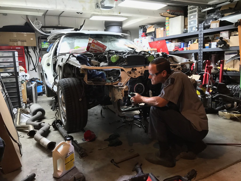

The engine bay was fairly easy to strip down with a little patience. The brake lines will be a fun time on the way back in, that's for sure!
Wiring out. A dirty engine bay awaits rejuvenation.
